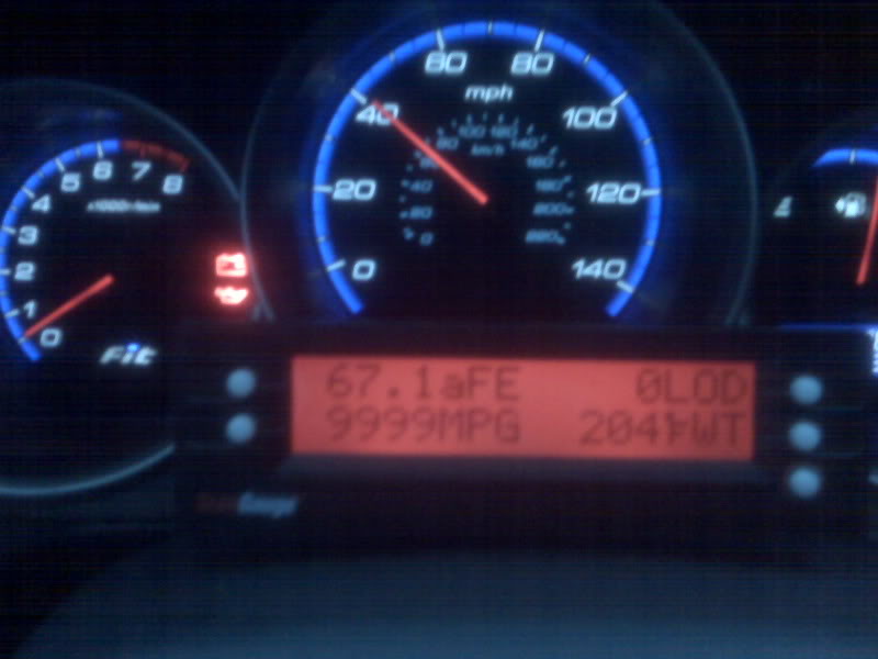

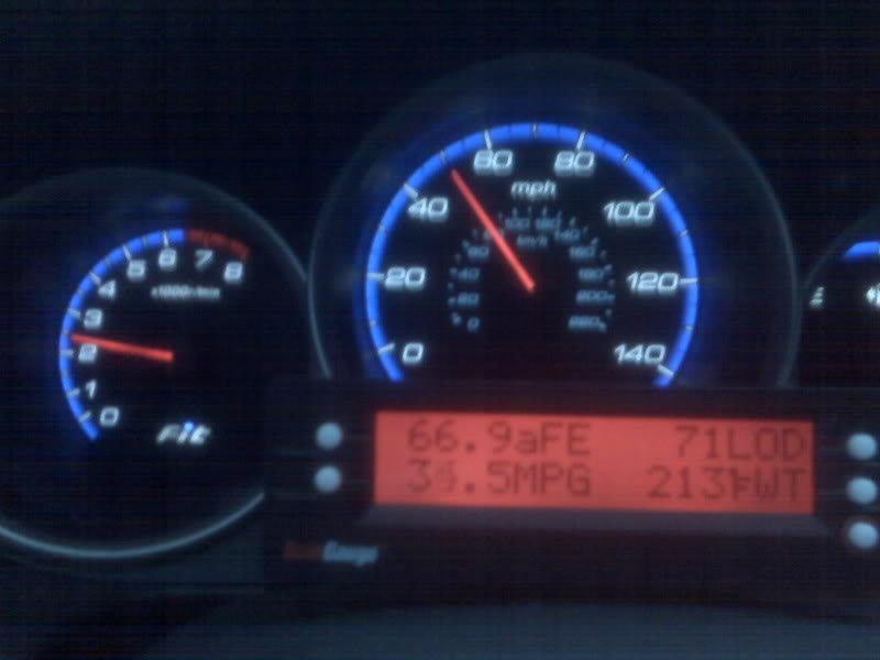

Here is mine(sorry for the crapberry pic):
with a little P&G action on the way to work this morning

Hey Shawn, Not sure if you saw my thoughts in the grill block or not when I ran one? One sugestion for you is to get a decent IR thermomoter and after you get to temp like that 213F shown take a few readings under the hood. I think you will be surprised what you see.......
Look close at the cylinder head.
Old Dec 29, 2008 | 10:36 AM
  #297
pb and h's Avatar
Posts: 604
From: Lexington, SC
Paul,
Are you saying that 213F is too high for comfort( I have seen it at 220F)? I have been wondering. Depending on the evening commute temps I may pull out the upper grill pieces. I may be able to borrow the labs IR temp gun but I am not sure if they will let me hold it over night to see what temps the block is putting out. I definitely don't want this thing to over heat.
Old Dec 29, 2008 | 12:57 PM
  #298
pcs0snq's Avatar
Posts: 1,049
From: lake worth FL
No I'm actually saying mine was higher then the SG readings! That's why I took mine off. If you could rig up the grill block to open open and flow air after you hit 180F ie normal that would be what I would do. Mine was off by 10 to 15F. Think it has to do with the fact that the SG temp is not at the thermostat???
