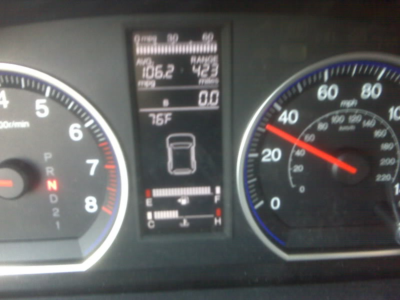

This is my wifes CRV 2008, I reset the trip meter when she was coasting. I wish we had this in our FITs!:

~28mph in 5th gear is ~85mpg LOL

I can see me now trying to go 30mph in a 70mph zone!
I think I reeeally need to get a hybrid!

Coasting in neutral will go to way high MPG numbers... but coasting in gear and getting DFCO will get ∞MPG!
