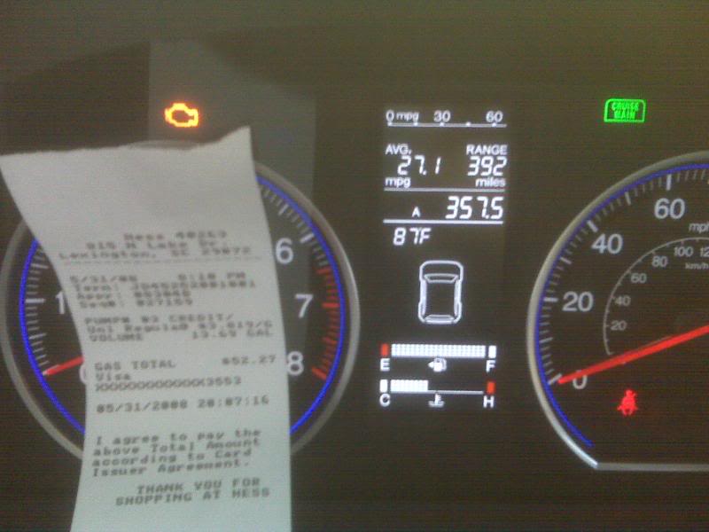

Since you guys are on the subject about variance lets look at some more possible problems
My wifes car, 2008 CRV EX, was just filled up:
The gallons used was 13.69. So, if we do the math from miles driven 357.5 divide that by 13.6 we get 26.2 mpg, however, if you look at the top left of the display under "AVG." and above "mpg" it says 27.1 which is what the ecu calculated(meaning the average mpg was 27.1). This is only 0.9 mpg difference or a 3.3% difference but I have notice before it has varied less, more or exact.
So, what does this mean???
Well, I am not 100% sure but I can think of 2 things:
1. pump inaccuracy
or
2. the ecu does not take into account how much fuel is used when starting the engine.
I guess it could be a combination of both.
What do you guys think? If you think about it, the scan gauge would have the same problem since it is reading from the ECU as well.
Both scangauge and the car's ecu are only estimating. Car knows all the sensors, SG goes by airflow. Neither will be perfectly accurate.

I would have guessed that the car's ECM knows exactly how large the injectors are, as well as what the pulse-width the injectors are firing at. Easy to calculate how much fuel is being used if those items, and the fuel pressure, are known. Chrysler products have been doing just that since the early 80's through the "traveller" computer that was optional on some cars with the turbo engines. SG should be able to hit that info in the ECM and give pretty accurate results. My wife's got my car right now or I'd go out and check, but looking through the FSM, it doesn't look like there is an air flow meter in the system. I'm guessing the EFI is speed-density based, using throttle position and MAP to calculate air flow rather than directly reading through a MAF sensor.
HF
Injectors are not all identically performing, and the ECM on the Fit can dynamically adjust for about +/- 20% (by looking at the O2 sensor to make sure the closed-loop AFR is correct). My Z4 has a manual adjustment for if the car is estimating mpg too high or too low (basically like how the ScanGauge is adjusted). It's just not possible to do such an exact measurement.
