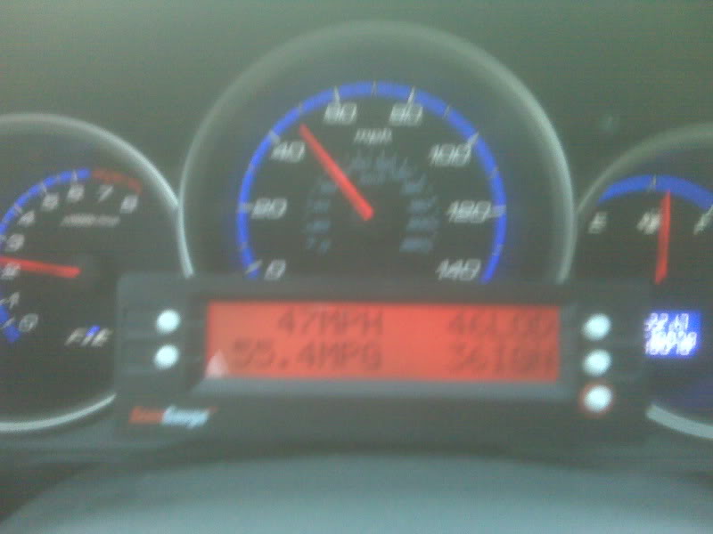

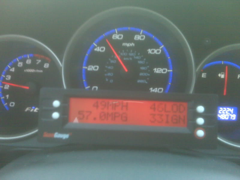

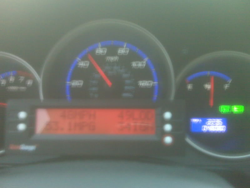

SHM(super highway mode) on the FIT using the SGII:
These numbers were achieved at about 67F temperatures outside and the terrain or road was relatively flat. I was able to maintain this with a bit lower LOD, IGN and MPH which is expected. LOD seems to be easier to maintain than the IGN. IGN seems a bit fickle or rather I am not sure what really affects the IGN. I wanted to achieve the same LOD so I could demonstrate that the mpg of 55 is achievable at a certain LOD while the IGN and MPH can vary to some extent, also noting that maintaining anything constant is almost impossible depending upon ones terrain/road.
My last set of data was from using cruise control after achieving the SHM mode. The cruise control obviously keeps the MPH constant(for the most part) while the LOD and IGN varies more than in the SHM mode. I wanted to demonstrate here that the SHM should be higher than or yield better MPG than cruise control which it did although not by much. The cruise control set at 50mph(by the speedometer) yields what I have seen other FITs(of my model) yield, so it was a control as well.
Findings:
LOD: 46
IGN: 36
MPH: 47
MPG: 55.4
LOD: 46
IGN: 33
MPH: 49
MPG: 57.0
WHEN USING CRUICE CONTROL:
LOD: 49
IGN: 34
MPH: 48
MPG: 53.1

Shawn, Most of the time the wind can play a huge roll in the test readings in addition to the draft from being in a pack of cars or not at all. Also road grade. even 1/4% grade is BIG. Not to rain on or discredit your results, but I'd be interested to see this with a test going in both directions on the same road with an keen eye on traffic and not using instant mpg reading. Doing it on the fly on the way to work is not too reliable IMHO
Also with the noisy nature of the instantaneous nature of the SG MPG to get decent results you need to use the SG trip, current, mpg and the reset button. I have current set up as a x-gauge on my junk. Just set up for the run, go to trip, current and use reset and it will start an avg of the test run. Try it and you'll see how it takes a nice avg. Take the readings as you have it shown then swap to trip to read avg FE for test using current
I tried to do SHM for a solid week and at the same speed never got close to 55mpg. In fact at any given speed held constant the LOD, IGN are 100% linked to the environment and rolling resistance. Temperature, winds, traffic and tire type and pressure are big variables.back off the gas and the LOD and MPH falls off, every single time if you did it from a steady state. When I'm less than 40mph then I just get 51mpg. 45mph is 48 on flat ground and some traffic and no wind 82F.
All that said, please make me out to be wrong and come back with some real testing data. I know mine can't do that, but if yours does maybe others can as well. I have always felt your '07 Fit was more capable by maybe 4 to 5mpg then my '08. But, you also know the +60mpg runs are very unique and only a few of us have managed to pull that results using a great deal of effort and patients.

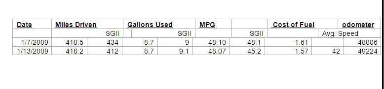

I am confused about the SGII. I thought I had it nailed until I filled up this morning and I was 0.9% off. Look at the data and tell me what is going on:
My guess is the pump fill up precision or the fact that i increased the mph by 1. Since the numbers were off I corrected -0.2% so the correction factor now reads -9%.

You are correct to some extent but I guess I didn't ask the right questions. Take into consideration the SGII readings vs. the odometer readings. Lets take a closer look:
- My last 2 fills have not been adjusted( SGII has not been messed with)
- Notice the miles driven are off by 1.0% and -0.1%(SGII compared to the odemeter, that is) respectively.
- The 1/7/09 date has the mpg dead on but the mileage and gallons used are off.
- The 1/13/09 date has less variation in the mileage
- The 1/13/09 has increased variation in the gallons
I think we have concluded that the gallons used is subjective due to pump and fill errors but not the mileage. The SGII doesn't seem to be consistant with mileage therefore one will never get an accurate representation of the info, precise(referring to mpg) only by chance as my data shows(1/7/09). I am about ready to sell the damn thing
Hell, I didn't need one before and now that I have it, it is irritating me more that helping me.
