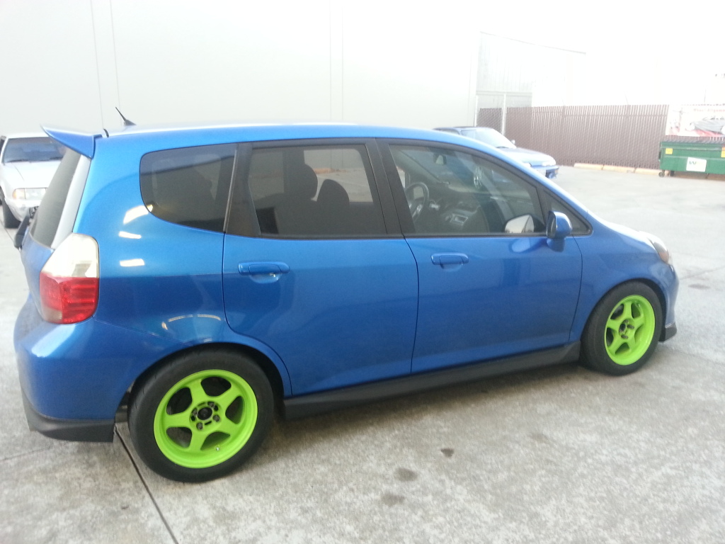

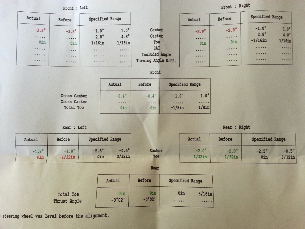

So my tire guys know they're business >_< just gotta manage the rubbing in the rear right now... the camber difference is supposed to compensate for driver weight, but it's super slight. I was more impressed that even after multiple AutoX and daily abuse the camber bolts both top and bottom didn't shift!!!

We have had camber bolts top & bottom for the last 3 event. No movement so far.
