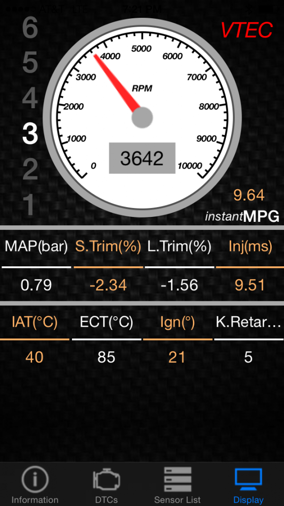

The Hondata app is awesome!
Theres even a built in shift light.
