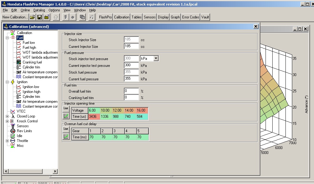

Now that you guys have the flashpro, I have a question that has been asked numerous times before and I believe has never been answered.
What are the values you guys have, which hondata provides for the injector opening time, for the 185 stock equivalent?
I'm sure everyone else who has tuned with other systems have guestimated like me the stock injector opening/response/dead times to estimate the opening times we might use with our bigger injectors.
Do the fit community a solid and please answer ;D

Tuna.. I may have a screen shot for you

Here you go Tuna:
Stock Batt Voltage v. Latency table^
Recognize that spark table in the background TPC? I'm testing it in my car, comparing my datalogs to yours and sending it over hopefully end of day tomorrow or sunday
Got it! Just flashed it and did a quick cruise.... Looks like I now make a bit too much wheel torque to use launch control on my 205 street tires
