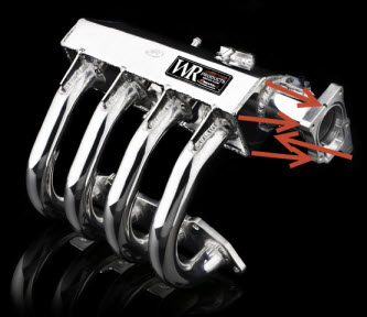

Tack some tabs in to brace.
Where? Outside between runners? Inside the plenum? I do NOT want long term issues with this part... and if it's going to them for initial repair I wuld rather have it ALL done at the same time...

Where?! I have heard this, but can you show me where to check this one? I mean, if I get a good deal on labor from them, maybe you could ship me yours? It would probably be easier to have a local machinist just cut and clean up all the problem welds than ship, repair and re ship costs...
at the TB, ill probably just take it to my welder and have him beef the shiz out of it

between each runner and the top of the flange that mounts to the head. For the plenum, a simple strap tacked over each edge of the plenum for maximum overkill insurance.
Pardon my crap skillz lol but something like this?
Old Nov 19, 2012 | 03:29 PM
  #125
DiamondStarMonsters's Avatar
Posts: 4,428
From: Chicago, Illinois
Well, I'd be less concerned with that bit one or two on opposing sides would more than take care of the TB mount.. I was thinking something like this:

basically on the bottom side of the flange near the TB.. Im going to get stiffer motor mounts before I reinstall the intake mani.. i blame all of the engine movement on why it breaks... and the china welds llol

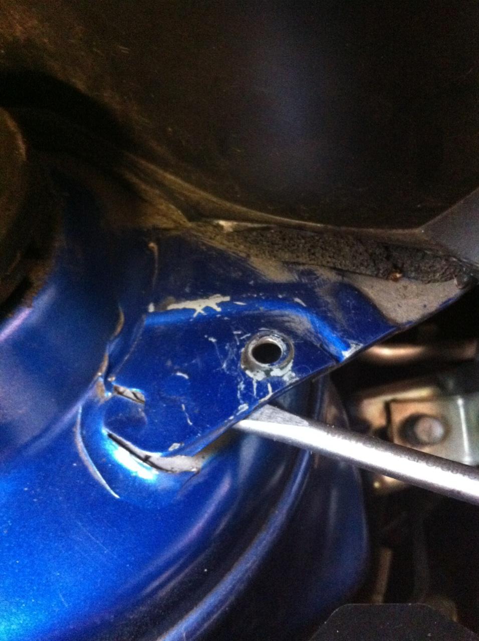

I had a Spoon torque damper on the car, worked like a CHARM, turned out it was not SCCA class compliant and it was actually TO effective and one of the mounting tabs it bolted to (originally for the plastic cowl) actually broke
