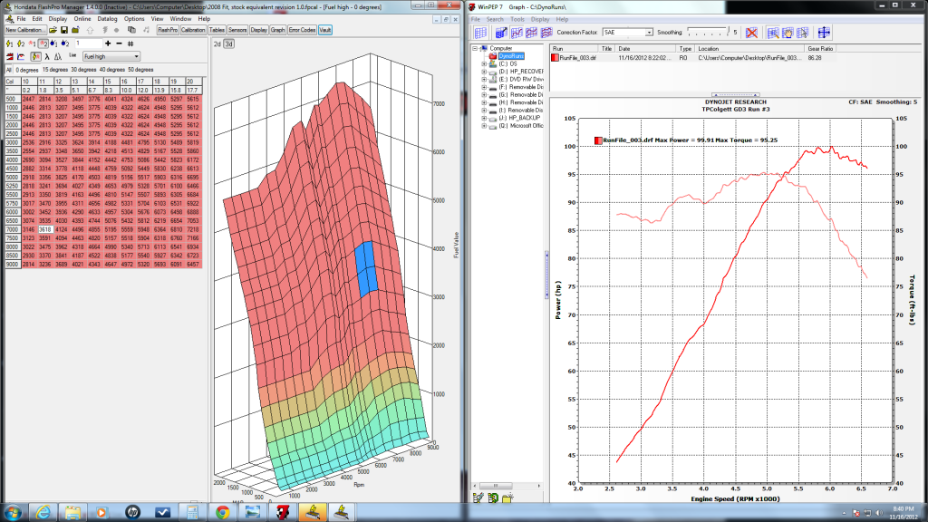

Tyler's base tune and dyno runs are in!
Feast your eyes on this:
Yes, that is an 11whp bump from an extremely rudimentary tune!

They dropped VTEC activation too low (~2500rpm) which is why there are two dips early in the rev range and they leaned it out a bit too far, almost 13.7:1 AFR under full load in a couple spots. No knock was detected, and no knock retard was shown in the calibration so it is a safe tune, but not ideal.
Meaning that there is still more to be had.
Updates to come.

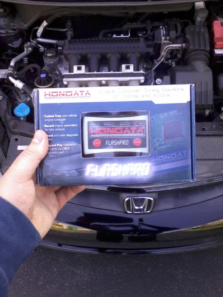

Got my FlashPro today!

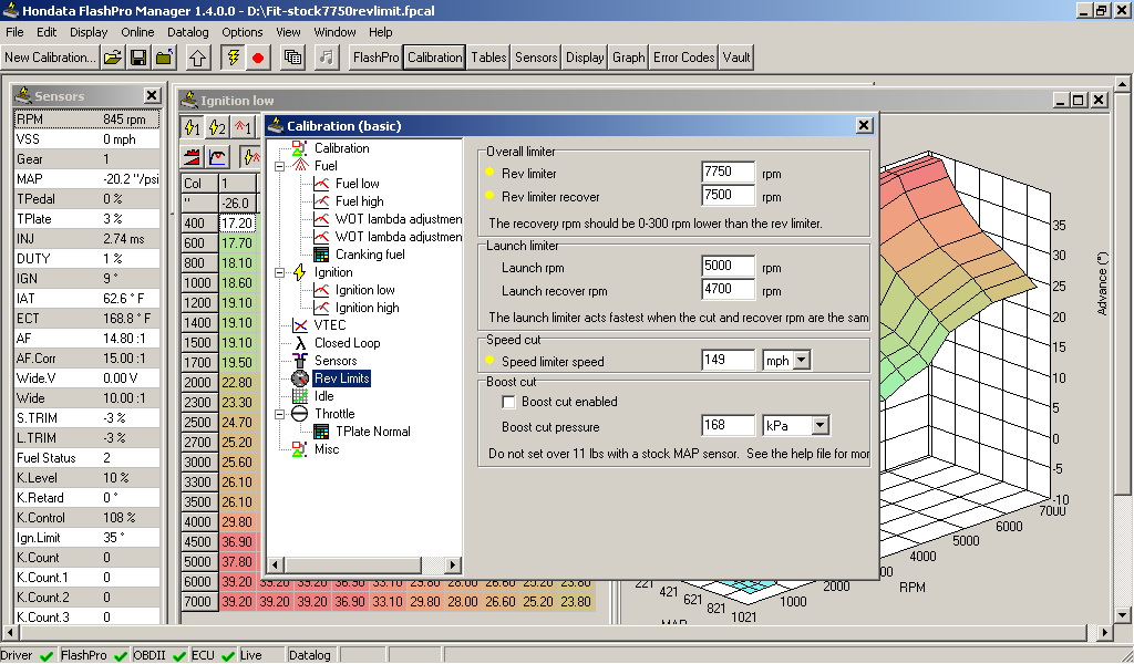

Rev limiter set to 7900/7750 recovery
Launch limiter set to 5250/4900 recovery
Low load AFR targeting 15.2:1, thinking about going higher under cruise but still playing around with that.. should give me a respectable bump in fuel economy without really having to think about or do anything haha
Added 1-2 degrees advance every where but the VTEC cam changeover, low-mid range feels mildly improved.
Added a few degrees of timing out the top, saw no knock even with the thresholds set lower.
Leaned out to 13.2:1 past peak torque on the WOT Lambda maps and again no knock or stutter.
I completely changed the feel of the car above 5k rpm and pulls pretty solid to 7500. Get more MPH between shifts speeds things up considerably, and gear change drops directly into peak torque making pick up much snappier.
As a bonus this little hamster mill starts to scream after 7000rpm, even through a stock airbox and exhaust.
Can't wait to get the cam and springs in this bitch.

Rev Limiter tab on the Calibration (Advanced) settings menu:

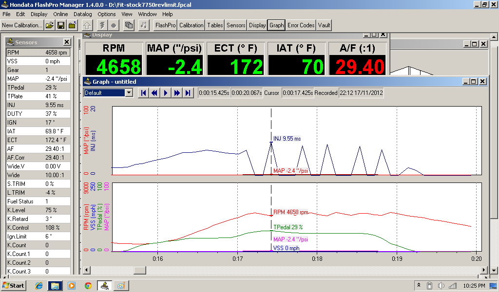

Zoomed in on the datalog of me testing out my new found launch control:

I do see some knock retard across the board of 3 degrees, is that on premium? That is very lean 29/1.
Old Nov 18, 2012 | 08:04 PM
  #100
DiamondStarMonsters's Avatar
Posts: 4,428
From: Chicago, Illinois
That is the launch control, not actual knock. Look at the rpm line and TPS
