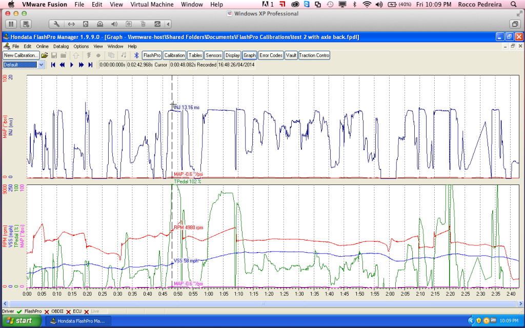

Do you have any wot logs i could check out? i want to see how much your throttle plate opens mine only open 88 percent at wot

To be completely honest I have no clue how to read this shit. Here's a screen shot one of my data logs.

Yea it would be under throttle plate seen your tpeddle was 102 dont thing mine that high tplate on mines only 88 idk if that normal i tried changing tplate cal but did nothing
How do you get to that screen?

There are plenty of displays you can get online if you search for them or look at the hondata forum.
Also scale down your high/low on your datalog for tps. It will help you see the line smooth out so that you can see where you are using partial throttle/cruising.
I set up map and tps on the same datalog screen to help show how the engine is breathing.
Displays | FlashPro Tuning
click display in the top left , then click load it will bring up options to pick.
Once you choose a display you can also edit them by right clicking on the graph and choose sensors .
Making graph Click options click graph templates.
next click add make a name then below edit sensor you want
when your done click add again then exit, then see if its there in graph, there's an arrow you click to open for choices

102% is the highest number I have seen from my datalogs but on my dials it always said 87% was the highest.
Im told that the stock throttle body doesn't see any performance gain from opening the extra 13% but I have not taken the throttle body off to see if it was fully opened when it rear 87% or if it still had some more to open.
Honestly I have not messed with the settings to try and get it to open 100%. Has anyone done this with any benefit?
lakia5524 try datalogging a 4th gear pull from 20mph-70mph. You will see hopefully 14-14.7 on the MAP and that is where you might see 102% on the throttle body %.
yeah my throttle peddle goes to 102 but the throttle plate only 89
I think that's just the way they made the gd3
