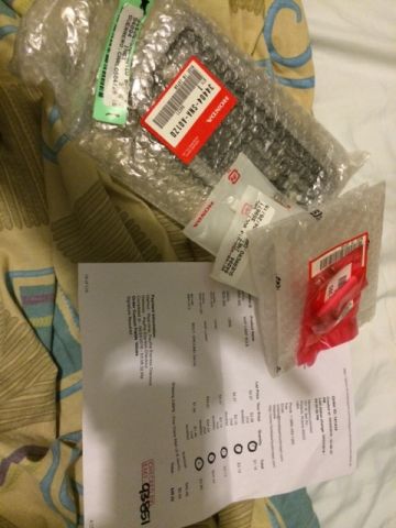

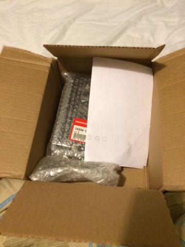

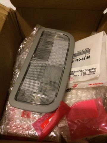

My maplight parts finally arrived today!
I'm going to be installing it in my base this weekend. I got all the require parts listed in this thread and will be following the DIY guide : https://www.fitfreak.net/forums/2nd-...t-base-ge.html .
Also, I found a local dealer with JDM power folding mirrors with blinkers (*jumps around*), just need to have them painted since they don't have in white and then take it to a local shop which makes all the magic possible (auto fold with alarm/ignition, blinks, etc) but that will have to wait until next paycheck. Joys of living in a caribbean country where you have the option of buying a Sport version or the RS, hate the mosquitoes and the heat tho.

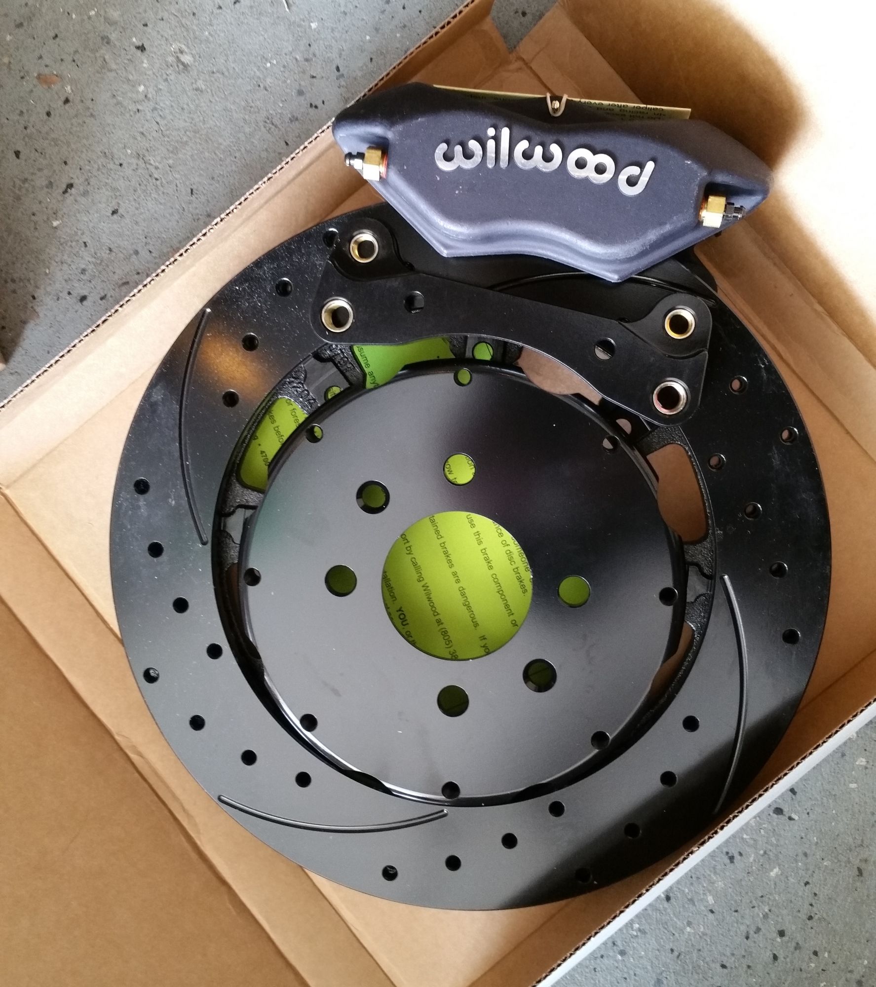

Attached Thumbnails What did you do to your GE fit today?-80-wilwood_fa60d7396af52152d4865b893e298083a717ab42.jpg
Old May 6, 2016 | 01:40 PM
  #15406
BMW ALPINA's Avatar
Joined: Jan 2013
Posts: 2,449
Originally Posted by bensenvill
NICE !!! Very Nice !!!

ok did a dry fitment of the brakes and rims. I am just barely scraping on my 16's.... So question becomes... I need a spacer. which one should I order and what thickness would I need to take just barely scraping to a safe distance? And will this require longer studs?

If it's just barely scraping you could run 3mm and you won't need longer studs for those. 5mm is still safe but is definitely the limit for stock studs.

if you could get away with just 5mm spacer, then you would not need longer studs.
If you need more than 5mm, then you would need longer studs or you can buy ADAPTER instead of spacer.
but I think the thinnest adapter version is 15mm...
The easiest example if the Ichiba Brand.
Their version 1 is pure wheel spacer that might or might not need longer studs.
Their version 2 is pure wheel adapter that do NOT need longer studs.
here are the links:
FIT 06+
For me, I only use wheel spacer with EXTENDED and much stronger ARP Studs. I use H&R wheel spacer for my application.
My H&R wheel spacer do came with extended studs from H&R but I decide to upgrade to ARP studs anyway, but again this require disassembly of your hub and need to replace wheel bearing...
so for your application,
either go with just 5mm spacer or get a 15mm ADAPTOR and that will avoid hassle of changing stud
This is the exact page for Ichiba Ver2 Wheel adaptor for our Honda Fit with 15mm thickness.
ICHIBA Version 2 Hubcentric Wheel Spacers 15MM
the description show it came with extended studs but that is a mistake of Ichiba, it actually come with extra lug nuts, and take a look at the picture between their version 1 and 2 and you will see the differences

please report back and let us know if there are any gottcha's. pictures and advice always appreciated too. thanks.

appreciated, ichiba 5mm has been ordered. I'll evaluate to see if I am comfortable without swapping out the studs. If so I will definitely go arp.

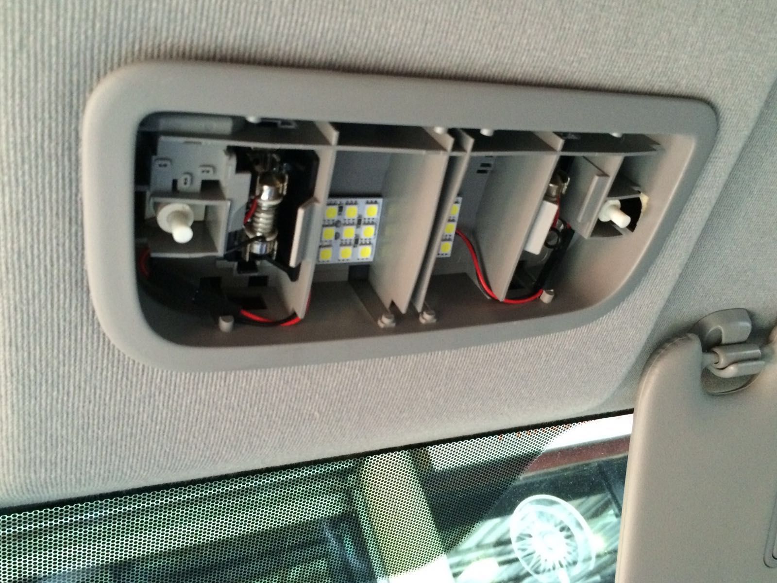

Install took about 30 mins, it is basically a bigger dome light map, that means you just need to connect it directly to the dome map and you are pretty much done. I will post pics later as I'm far from my laptop at the moment.

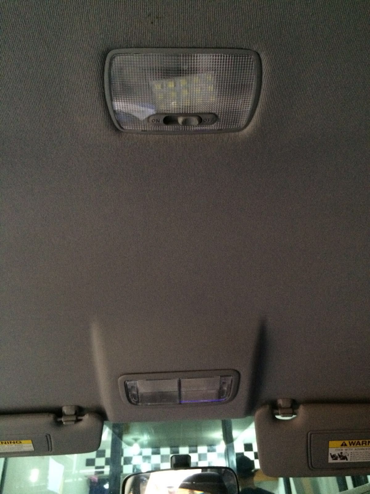

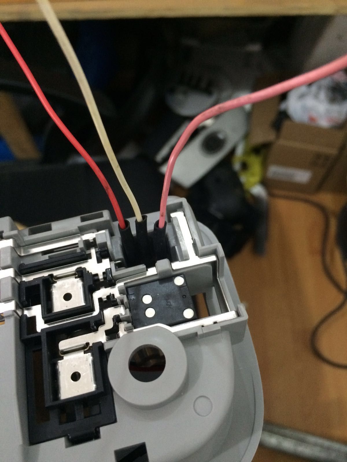

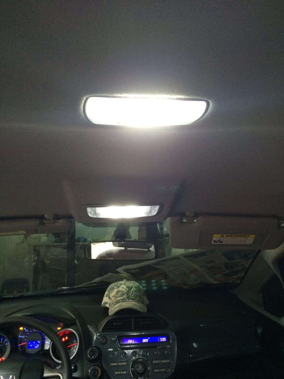

Some pics of the maplight installed on my base version.

What are the red white and pink wires attached to?

map light looks great, I think I'm going to have to do that next.

Power is being spaced/shared between maplight and domelight. The DIY guide is more detailed on this part, but trust me the connection is pretty simple to do.

It does and only cost about $45 including all the wiring, cheap mod for us lacking a decent interior lightning system.
