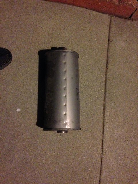

Not sure if the cut was too close to weld back onto the stock piping
Looks like mine haha, I mean it looks like there's enough to weld back on. I'm no expert on this though so don't take my word for it. I never planned to put mine back on anyway lol
