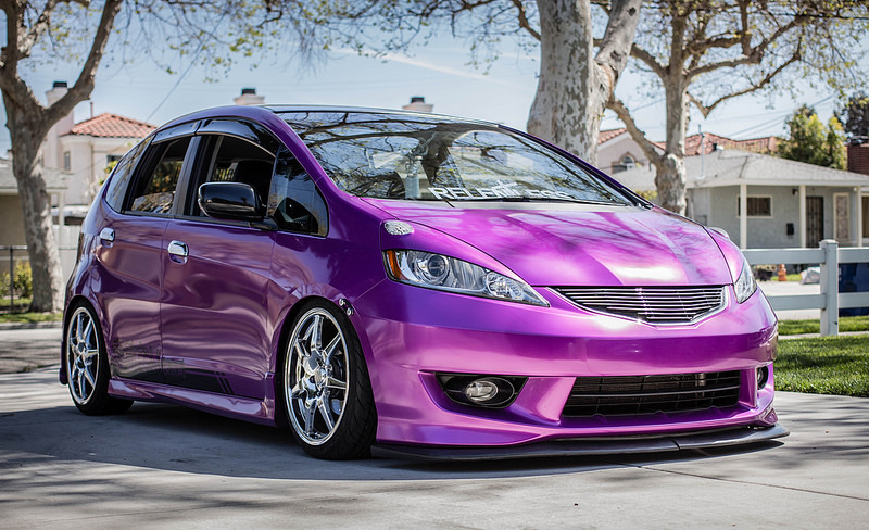

So I replaced the 6K rear springs with the 8K ones I got from the front since I had switched the front to 12K Swift springs. Here's how she sits now Ride quality is amazing, wish I had done this sooner haha. Will be able to run much wider spacers in both front and rear.

so the much firmer spring did not make the ride harsher?
What is the handling / road feel different between the softer and harder spring?

The firmer spring really should make the ride harsher, but with the height I'm running the coilovers, the original springs are too soft. It's bumpy, and the travel allows rubbing(if any) as well as scraping on dips on the road. Some who are even lower have problems with wheel lips touching the fenders. So we run higher spring rates to combat these issues. Swift springs are magical though, they do not feel as stiff as you think they are. With the 12K Swift springs in the front, you definitely feel the road but the ride is not bad at all. I really like this setup and plan to do 10K in the rear eventually.
** I'm using the springs more for form not function-- but they perform even better when tracking; the right amount for spring rates gives better handling and more power to the wheels I believe. Not so experienced with that so I'm just going with what I've seen so far haha.

Can't help but stare every time you post a pic... beautiful. Is your front lip cracked in the middle, or is it supposed to be like that?

And yea it's cracked. Unavoidable metal object on the freeway-- I already have an extra lip in my house waiting, but anxious to put it on too early before the Wekfest show; don't want anything to happen to it haha.

Damn, at least it's an STI lip and not a super expensive JDP lip or something. And yeah literally wait 'til the night before to put the new one on because you know how it goes...

Yea definitely, I can't imagine scraping up carbon fiber haha.
I could run without the damaged lip but it actually protects my wrap right now-- my bumper wrap would be scraped up if the lip wasn't there, so.. on it stays.

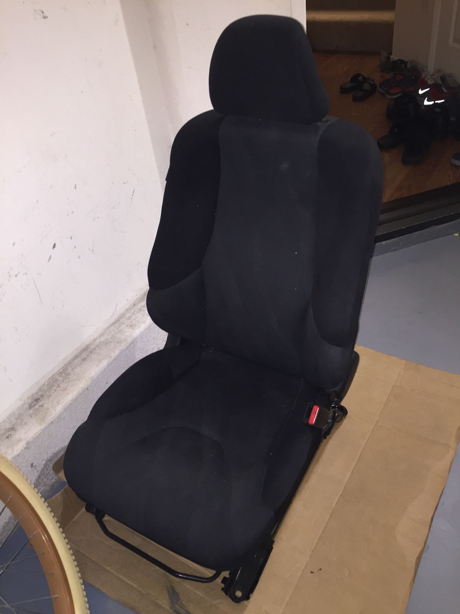

Just bought a used Passenger Seat so I can use the parts (OPDS sensor etc) for my Recaro install someday
I bought it from a fellow member of fitfreak "racer986jec"
Thanks "racer986jec"
