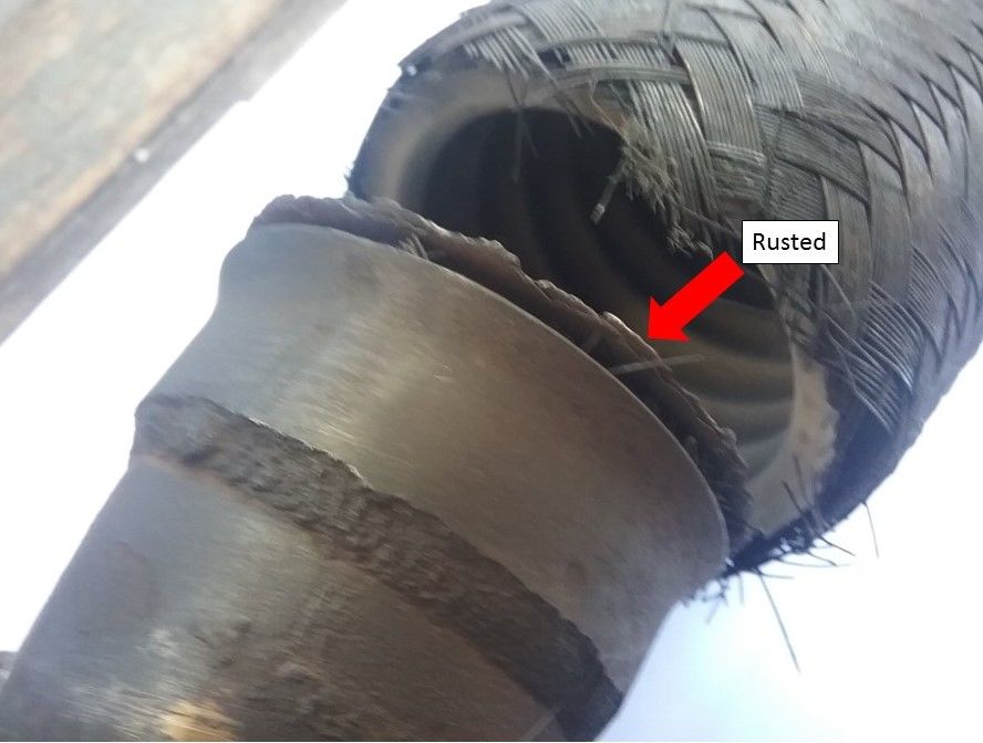

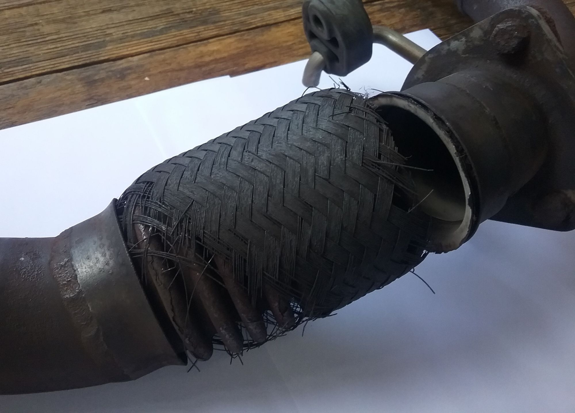

I put my cats back on. The Weapon R header is cheap and rusted out within the first two years of having it on the car. I contacted Chris (Sales Manager) at Weapon R and he wouldn't warranty it. I asked if he would sell it to me anew one at cost as a good gesture, he said no. The header would have just rusted out again, I'm better off without that cheap crap on my car.
The rest of the exhaust is rust free, to put it into a frame of reference.
A definite loss of power with the cats, but its much quieter now. Its nice.

yeah, i have seen some weapon r header pipes for sale that looked corroded. I thought it might have just been because north america snows, but sounds like it is more the grade of stainless steel that they use.
So you are running the stock/factory header and cat?
And with your tuning did you just tune for WOT and log RPM and AFR and then make adjustments?

Correct, it's just carbon steel. Not stainless:
The tune didn't change much, still running at 13.2 AFR at WOT with the stock cats back on.
Attached Thumbnails De36's GE8-80-wr_flex_pipe_1__24a19bba1b11f93871bec5b254171b9d5a800cc5.jpg   De36's GE8-80-wr_flex_pipe_2__eaadb4f9666beb3593f747c58080b43f0931dc1c.jpg

Surprised it isnt stainless.
I guess its a cheap flex joint too.
I recently bought a used SARD header piece for my DC5R, and found out it had a split in the flex joint. Ended up getting it replaced with a Vibrant flex joint which is braided on both the outside and inside ($$ ).
