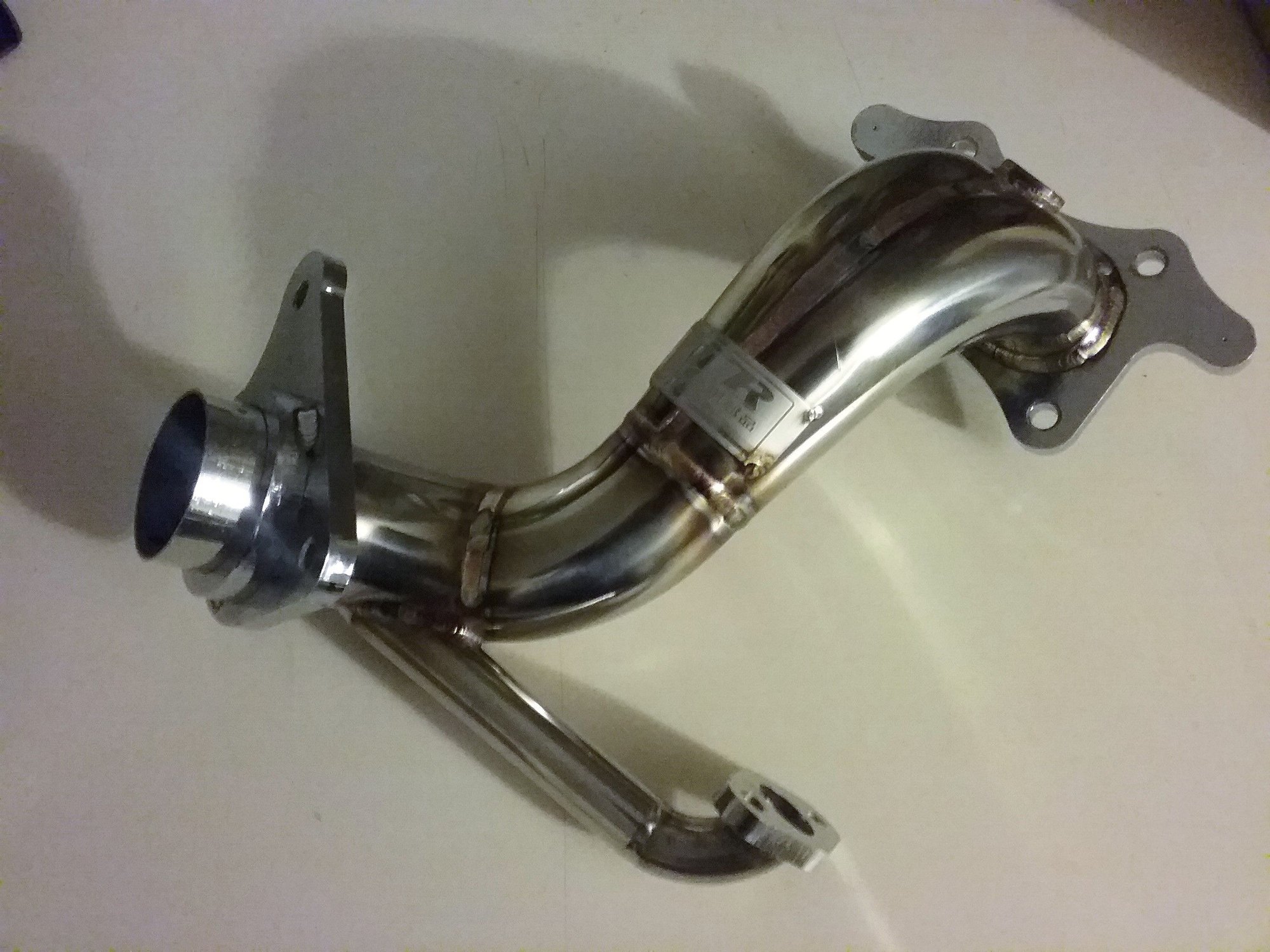

T1R Header from A&J Racing
A&J have a couple headers left for the GE8. Just ordered one from Ben. After the Weapon R header, this a welcome change. It looks like I still need a MIL Eliminator with the T1R header, it eliminates the front cat but retains the rear cat.
This just in.

Originally Posted by De36
This just in.
Do you plan to ceramic coated them?
I ceramic coated mine and help with blocking the heat since we can't use
the original heat shield from the original cat converter unless you want to tap/drill the 2 holes needed for the bolts and if I am not mistaken, you also have to cut a bit of the factory heat shield in order for it to fit with the T1R.
No. I may Wrap the header, but unlikely.
NOTE:
The purpose of the OEM heat shields are to help the Cats warm up quicker on start-up. Not reduce under-hood temps. It's for emissions.
Notice, the secondary cat (under the floor board) has a heat shield, same concept.
