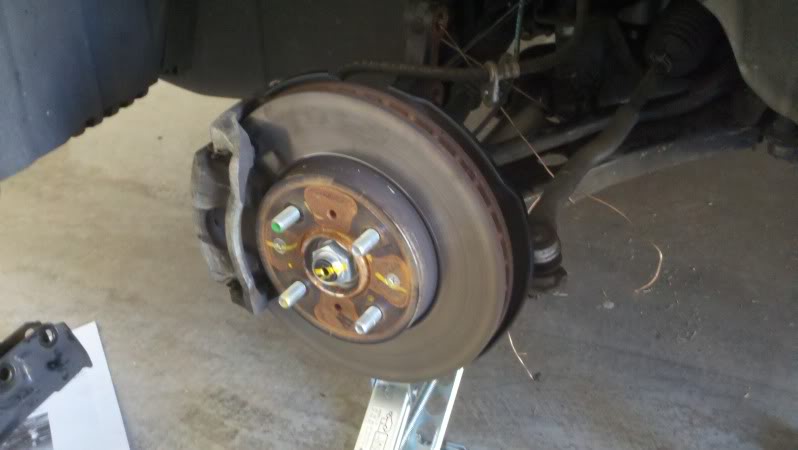

great write-up. used this to install my coilovers. here's pics of how i held up the control arm:
I used the jack for the lower control arm and a string or speaker wire in my case to hold up the knuckle.
I did it one side at a time too but I think it would have been better to do two at a time in the front. I ran into problems with the sway bar end links all tensed up when doing the second side. The sway bar end link kicked the strut to the side almost popping out my axle and snapping my abs wire...I caught it before that could happen. Luckily my friend was able to jack up the other side while I held the strut and that eased the tension off the sway bar end link.
