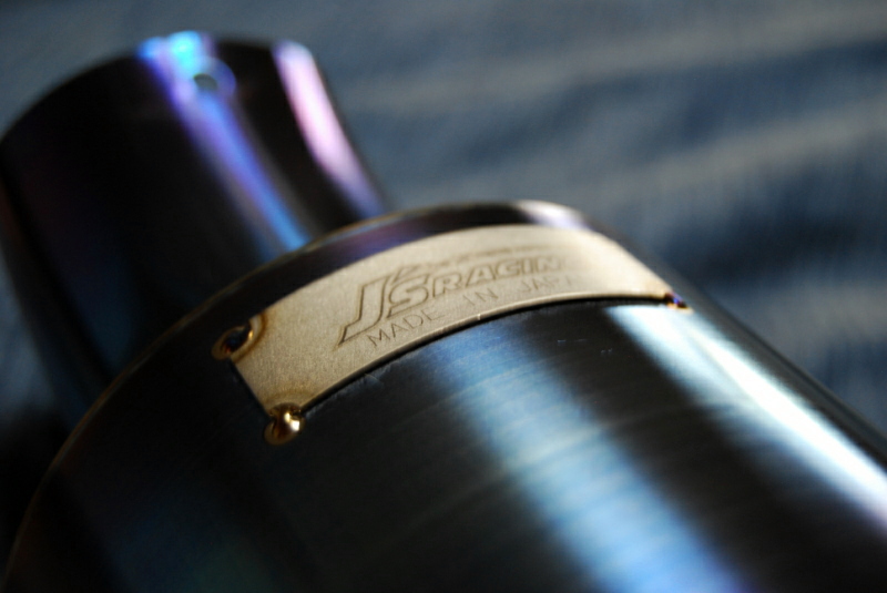

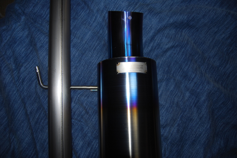

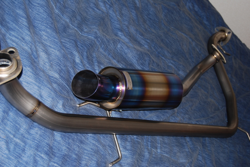

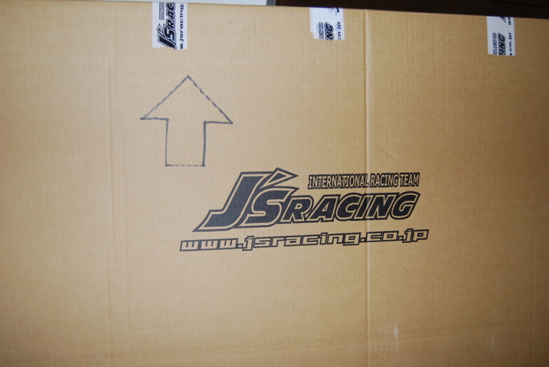

Exhaust just arrived about 10 minutes ago. I already removed the stock exhaust as soon as I got home from work so I can just put this bitch on. I took a not so accurate weight of me, me holding both mid-pipe and muffler of the stock, then J's pieces and then by myself once again to make it as accurate as possible. And did it all once again and came up with the same numbers on a normal scale and the J's pieces are 14lbs lighter by this method. Which is a tiny bit more than J's claim of 6kg (13.2lbs).
Enough blabbering, time to install, but here are a couple pictures of the exhaust before installing.

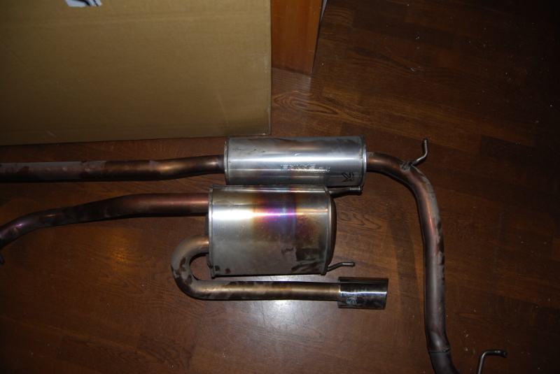

And not that it matters, but the stock set-up...

EDIT: Just measured the stock mid-pipe's ID at both ends. The input from the front pipe(2nd cat) is 45mm ID and the output to the muffler is 41.5mm ID (roughly, as I don't have calipers and using a metal metric L ruler. That is awfully tiny and for me I understand why 50mm probably does give the best all around performance and was the chosen size of the J's exhaust.

So the internal diameter of the Js exhaust is 50 mm compared to ~42-45 mm stock? So that is roughly 2" diameter for the Js...good to know.

Yeah I know, but like I said, my neighborhood is very quiet and mostly older people right around me, guess the reason it is so quiet. I took it out tonight for about 3 hours, went to find Seeker and then drove into Shibuya and back. It sounds really good inside the cabin, but I'm sure some would call it a drone, to me it is just music. I noticed a slight loss in the low-end till about 2800rpms, not much, but there is some. Top-end there is definitely an improvement.
It is just not quite loud enough for my overall liking. It's pretty deep and sounds nothing like a 1.5liter, I imagine with the replacement of the front pipe in the near future, the audible output will increase yet again. The sound reminds me of my old Snisen, of course it too had a J's exhaust, just wish the Fit would accelerate like it even just a tiny bit.
i WHERE?!?!
B'ND, I didn't measure the piping on the muffler at all, it probably goes back to 45mm, but was surprised it choked down to just under 42mm on the outlet of the mid-pipe. Didn't measure the J's either, so not sure if the piping is 50mm ID or OD, if outside it will be about 48.5mm ID.
