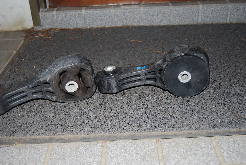

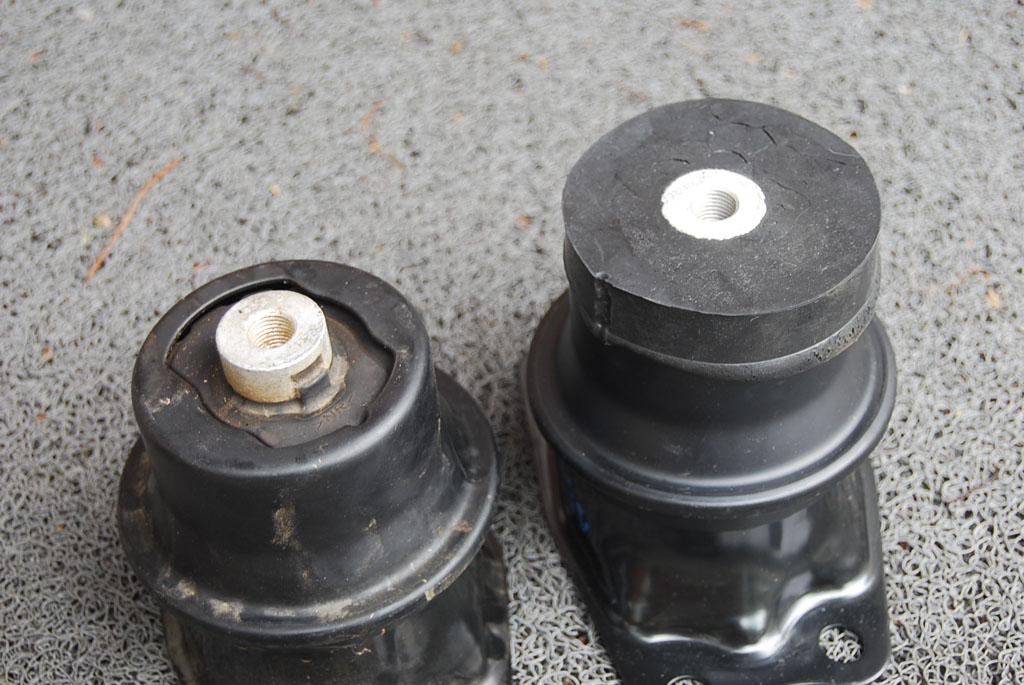

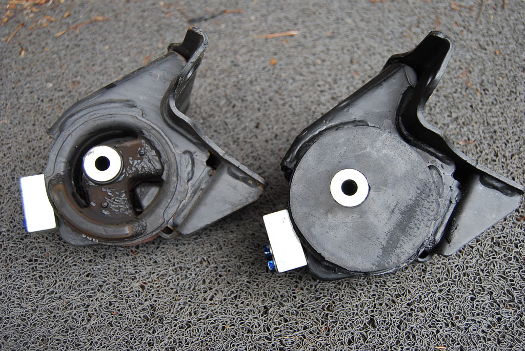

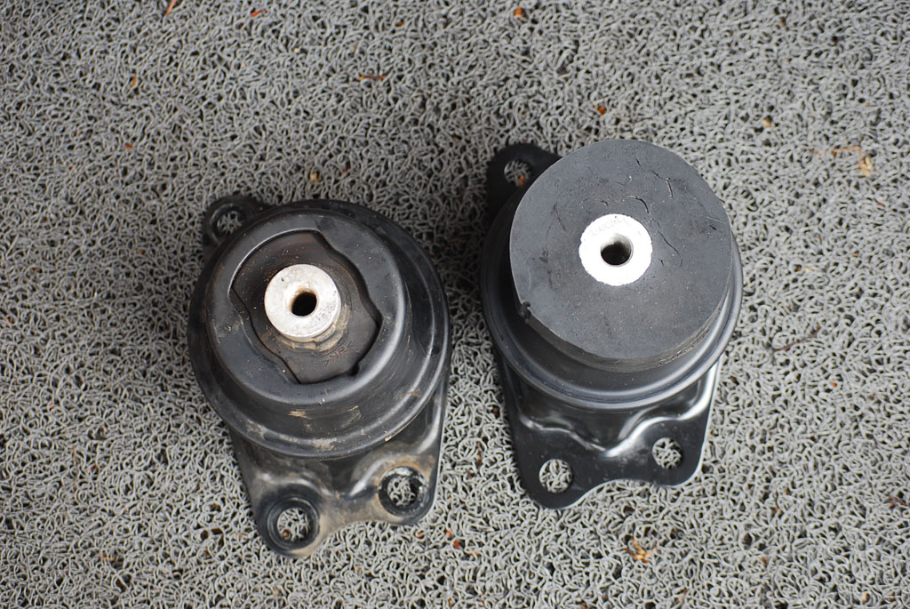

Well finally after about a week straight of rain I went ahead and just installed 2 of the 3 engine/tranny mounts. I ordered these from Alex Motorsports, basically they take the stock mount and just fill it with a solid mixture.
Can see the difference between the 2 in the pics. All I can say, I haven't driven it yet, but the engine already doesn't budge at all. Previously just by hand I could move the damn engine back and forth, I can only imagine how much movement there was during driving and even more throwing the car around the circuit. I started it up and inside the cabin there is more vibration, but that doesn't bother me one bit, I like my cars to be a little on the raw side and not a plush ride. The last mount is the rear mount and it is like an arm, looks like just 2 bolts hold it in place, but I need to get some jack stands, not sure what happened to mine so I can then lift the car up and use the floor jack to keep the engine/tranny in place and install that 3rd mount.
Overall the drive should be improved, able to lay the miniscule power of the L15 down better and the shifting feel I presume will also improve. Will report more after driving it.

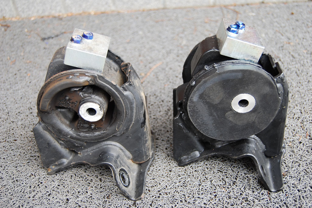

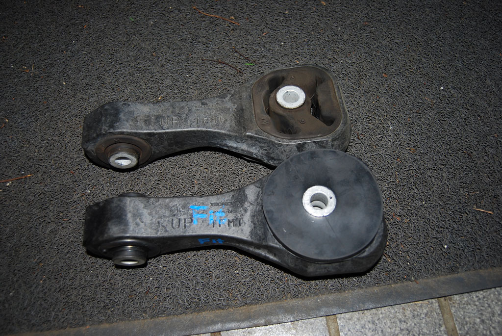

Well I just finished putting the rear mount in, kind of a pain in the ass, but it's all back together. Main reason was the Laile(Beatrush) bar, I had to remove it to get the stock rear mount out and then the Alex mount was not sliding in easily at all. A little bit of mini-sledge got it into the sheet metal casing it resides.
Now to go for another little drive.
