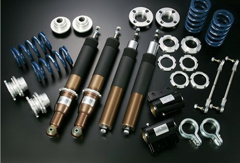

Well took a drive over to Osaka and finally visited J's Racing, they sent me an invite to their Summer Festa. While their on a whim ordered up a little Crux and Tohatsu combo. Won't be till mid-September, my doing as I'm paying it off in 4 chunks. Saved 10% as well, which was very welcomed with the $uck.
Averaged 34mpg over that included more than 2 handfuls of 190+km/h sustained runs. Now stuck in an expressway parking lot and I'm paying $65 to be moving faster, got to love Japan.

It doesn't look like the Js Racing sussy offers any adjustment of caster or camber? I can't see the tophats in the pic above...are there any coilover kits for the GE that offer caster/camber adjustment?

Well the sussy is on as of about 6 hours ago. I just got back home from Osaka and all I can say is...I LOVE MY CAR!!!
Umehara took to the wheel as he knows a great little winding road close to their shop to test the sussy after the install was complete. The car's handling is absolutely amazing. It is very neutral with maybe a slight hint of oversteer. I can only imagine what it would handle like with an actual diff installed. There is no need whatsoever for a rear sway, the car has zero roll, well if it has any I couldn't feel it and with the Honda Access sussy I could and it was a limiting factor out on circuit. On the way back home on the expressway their are some decent radius curves in some parts and I didn't completely lay into it as there were some other cars and the speed limit is only 80km/h, but I was taking them at about 145km/h (87mph) and could have easily done much more, where as most drivers are actually braking through these curves.
I purchased some Axis camber bolts, but didn't even need them as the front mount has adjustable camber to about -3.5 degrees. I have mine set to -2.4degrees and a very small bit of toe out to increase turn-in. I lowered it about 20mm more from the 25mm down that the Honda Access provided. With the roll center adjusters also in place I really couldn't believe it was the same car. I mean I knew it was going to improve, but honestly there is no comparison, it is just that much better. Of course it better be for what I paid. S

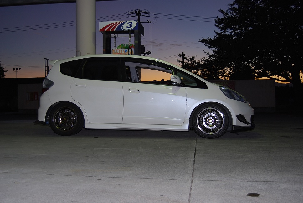

Well I detailed the exterior completely today, it was in dire need after the multitude of bug carcasses all over the front end and the ton of rain we recently had that just left the Fit looking tan and not Pearl White.
So a few new pics of how it sits.

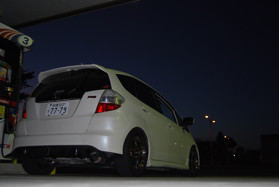

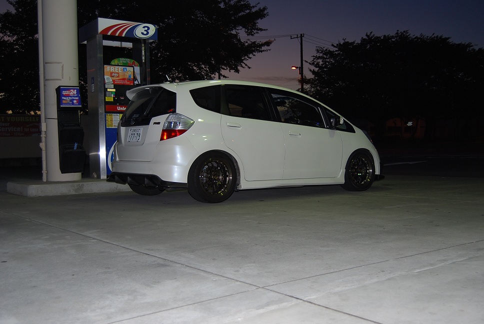

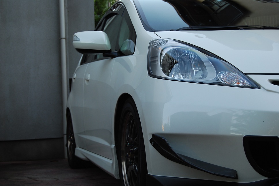

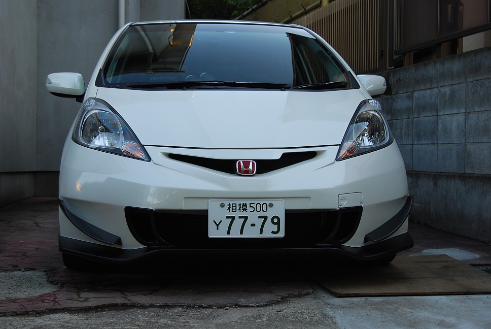

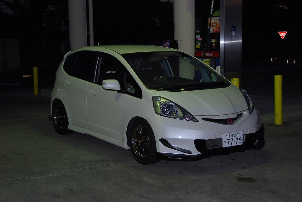

On my first trip over to J's, I lost the right canard on the expressway, so I ordered another one and J's drilled and bolted it to the bumper instead of just the normal double sided tape. It's not coming off now, but I think I will remove the bumper, get some longer bolts and put some threadlocker on to be a bit more safe.
