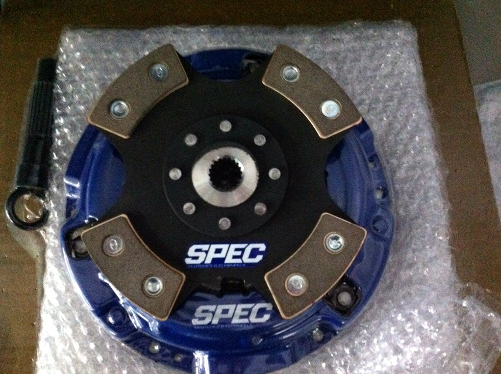

Alright, part 2 of 3 has arrived this afternoon.
Yummy solid hub, 4 puck action.
Come on MFactory don't let me down, better be here tomorrow or Saturday or I am going to have to forego install before the event.
Savin some weight, no sprungs to pop, better response.. a little chatter. Whats not to like?
Old Feb 2, 2012 | 05:09 AM
  #380
555sexydrive's Avatar
Posts: 2,317
From: ATL, Jorja
EXACTLY!!!
