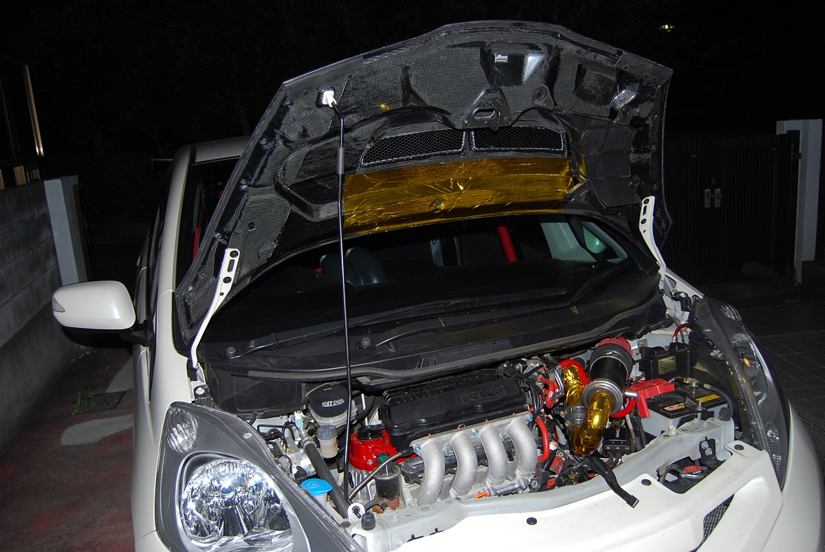

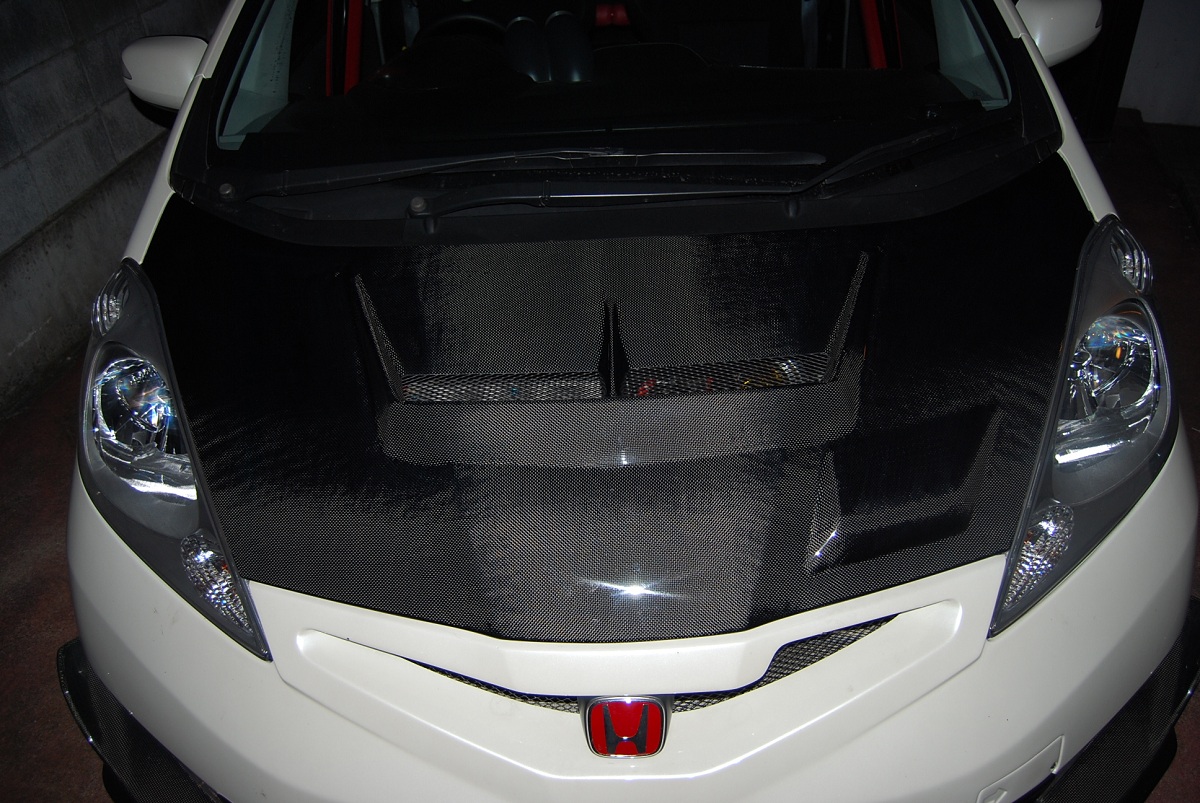

No they don't really give me a discount, not entirely true as I usually purchase when they are at a Super Autobacs and that knocks 5~10% off the retail prices due to their sale events. Still very damn expensive as stated being paid with US pesos.
Sorry night time pics, but it is just about midnight here.
TEO, I can't really tell in the dark if the weave is the same, but if it is not, doesn't bother me one bit.
So the stock bonnet I got 6kg and J's has it listed as 6.2kg. Most likely my weight is off as I only have a personal scale and I weighed myself and then while holding the bonnets. Either way, the full carbon is 1kg lighter than the carbon and frp model and 3.5kg lighter than stock. I'm happy with that weight reduction.

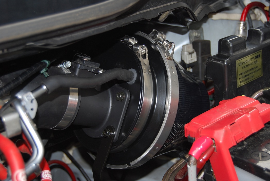

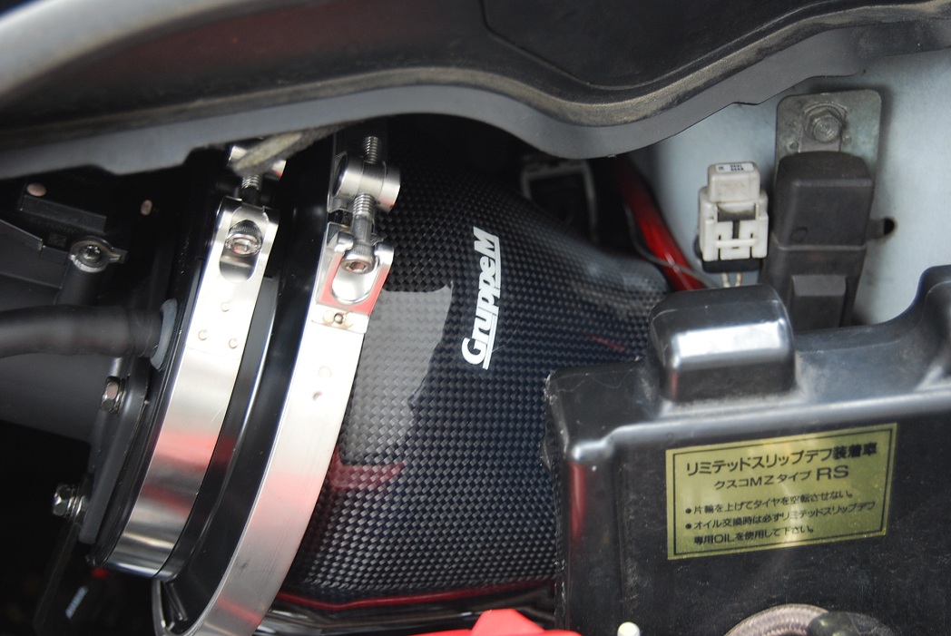

That was damn fast, the Sagawa guy just delivered the intake. Just went ahead and installed it right quick.

No complaints with the intake. IATs seem to be about 1~2°C less than the TopFuel. As far as performance goes, when I first installed it, it did seem to be a bit more responsive and has not lost that feeling. No real quantitative numbers, but I'm pleased with it.
Do you think your MAF is on the fritz? I haven't seen the inside tubing of the Last Station, but maybe it is slightly large causing an issue, but if it just started happening, I would think your MAF is the reason.

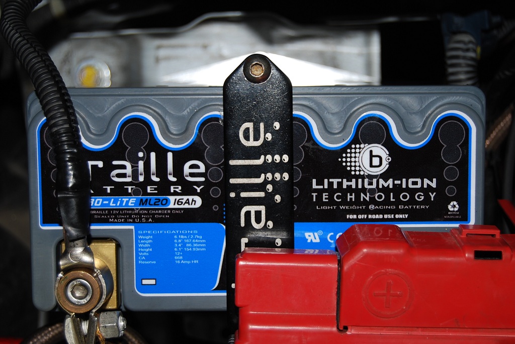

Placed an order late last week, maybe even Friday and today a new tasty treat arrived.
6.1lbs of power. The stocker weighs 19lbs and uses JIS posts, so previously I ordered up some new battery wires from stateside, to just swap out easily, since Deka Japan will not sell just the JIS posts and Braille no longer sells them, just the SAE posts. Had an older aluminum mount as seen, ordered a new one and also the aluminum box mount to check which I like best for mounting purposes. At the moment it's quite solid, but I want to further increase the stiffness and I hacked the stock plastic box to also use along with the mount. Basically just a test fit.
I also have the same size battery coming in their carbon AGM (15lbs) and was planning to use that as the daily and use the lithium for pretty much just circuit use. I could have gone even lighter and cheaper with the lithium, but I want to see how this one does for daily usage as well, since Braille says this model will stand up to it.
