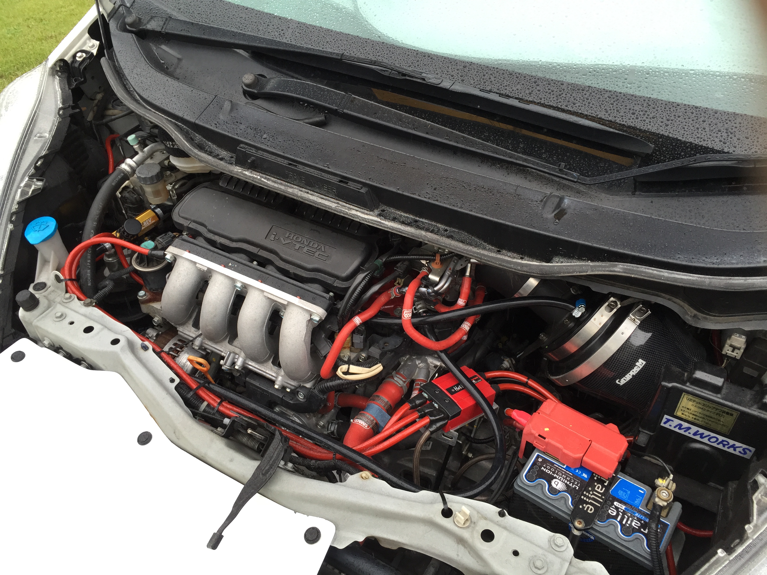

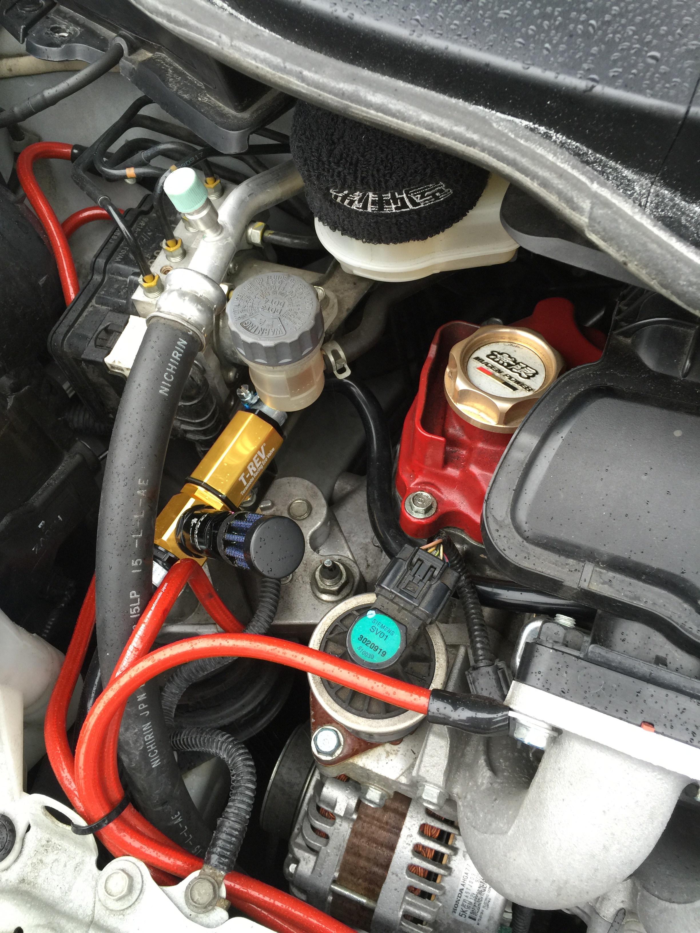

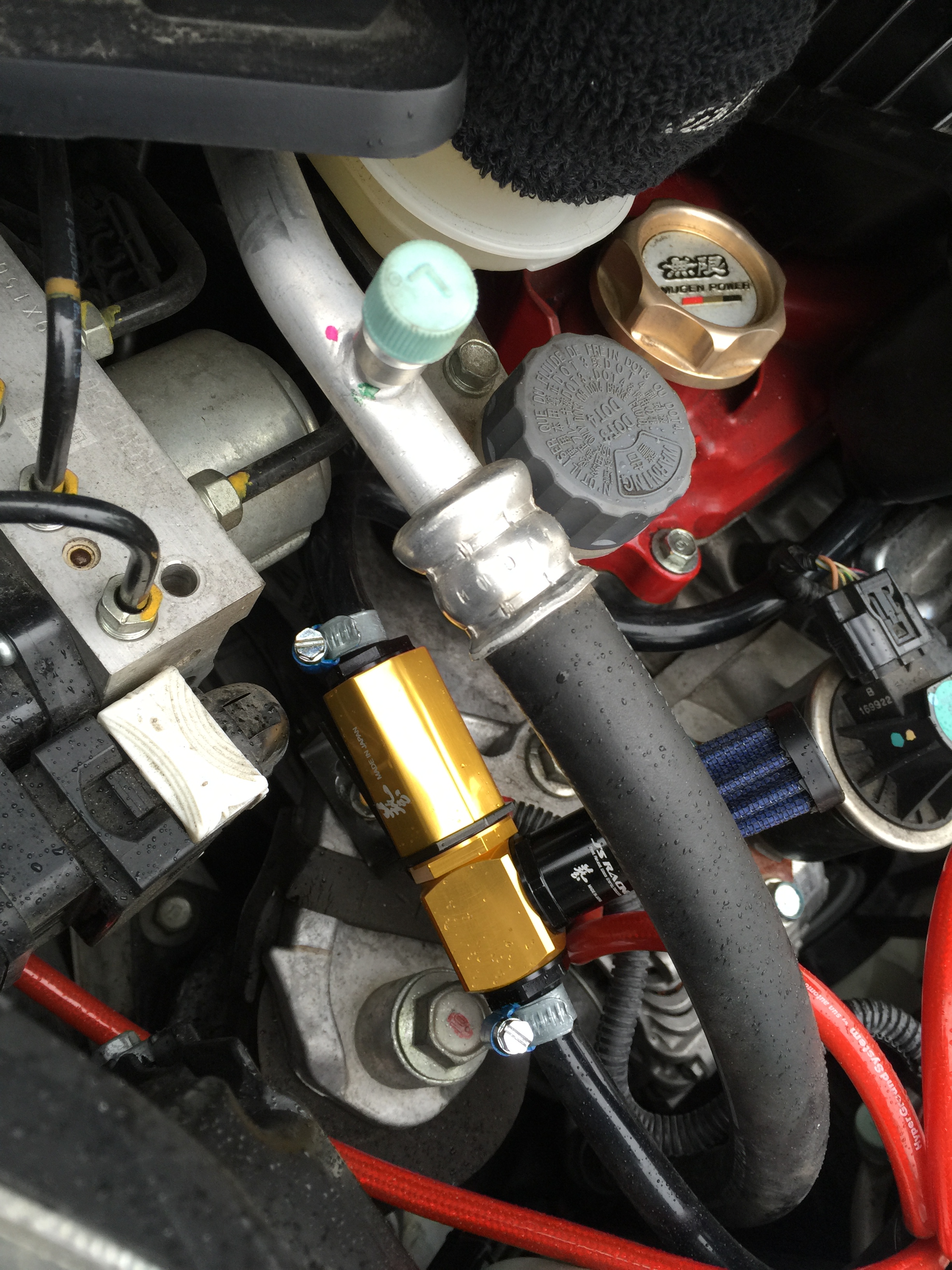

Just installed the T-Rev one-way breather valve.

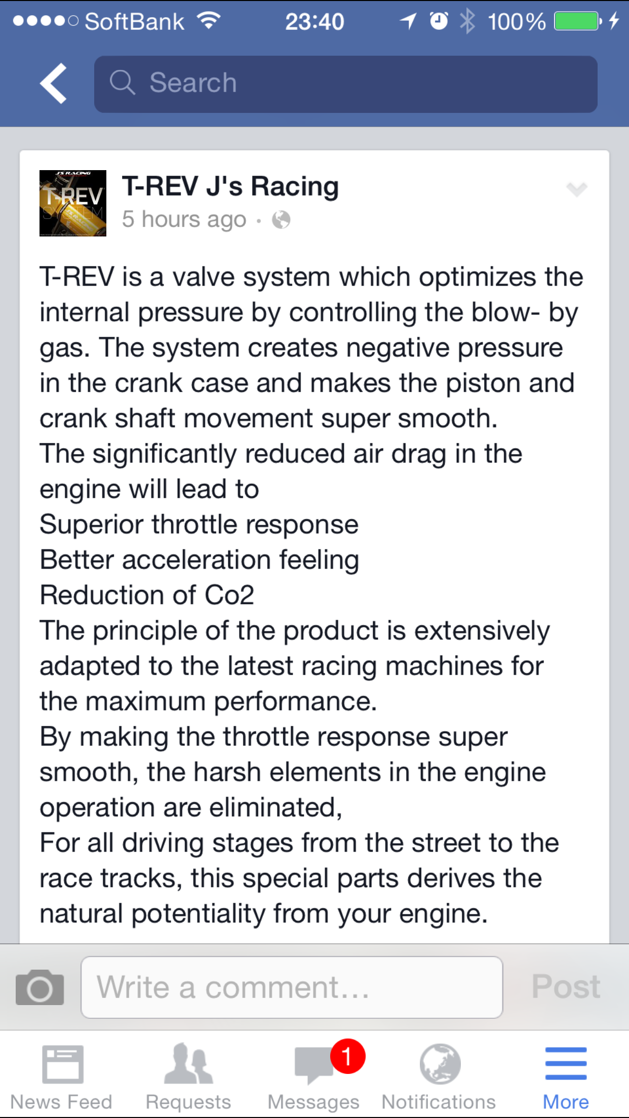

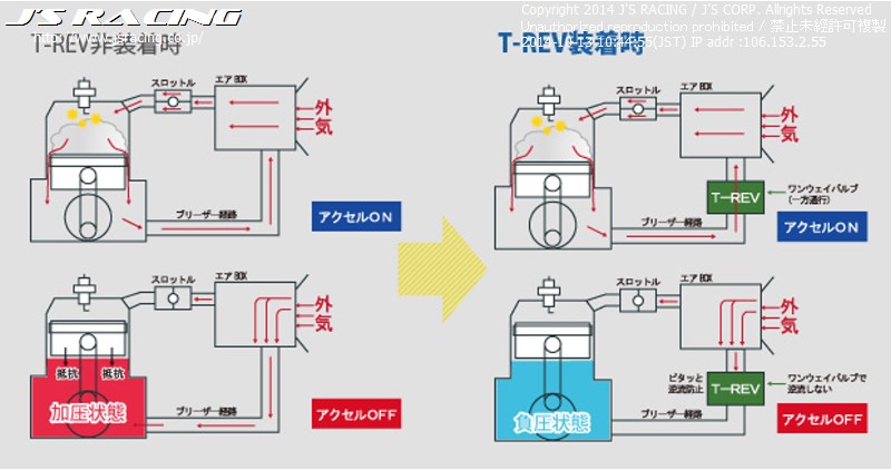

Originally Posted by jdmj0
Please forgive my ignorance and laziness to google it myself, but what is the 1-way breather for?
It relieves pressure on the crankshaft and pistons. They say an improvement in throttle response and overall feel and yesterday took a drive up to Saitama for indoor karting and the car really did feel better, much peppier.
Here is a screenshot from their Facebook page...
Old Oct 14, 2014 | 01:03 PM
  #608
De36's Avatar
Joined: Jun 2013
Posts: 629
I've seen these crank case anit-pressure valves on motorcycles (but without the air filter), Ducati has them fitted stock. The T-ReV valve you installed; is it retrofitted from a bike? Or is this a car part?
My concern is that it is pulling from fresh air when the crank case is under vacuum via the air filter. Even if it is compensated for within the tune; it's still considered a "controlled intake leak". Unless I'm confused on the function of this. Can you explain?

Another image that shows the function of the device when on/off the throttle...

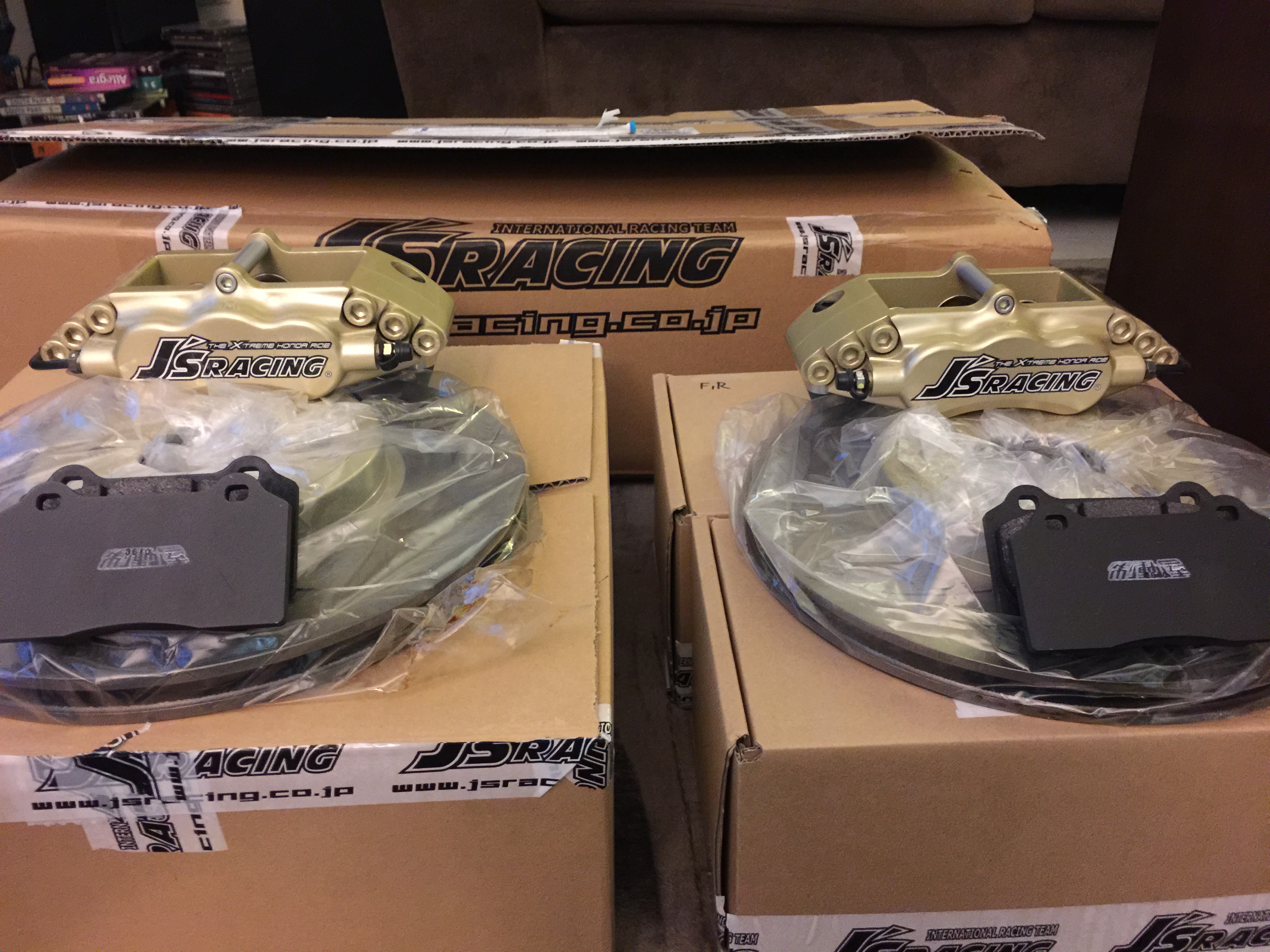

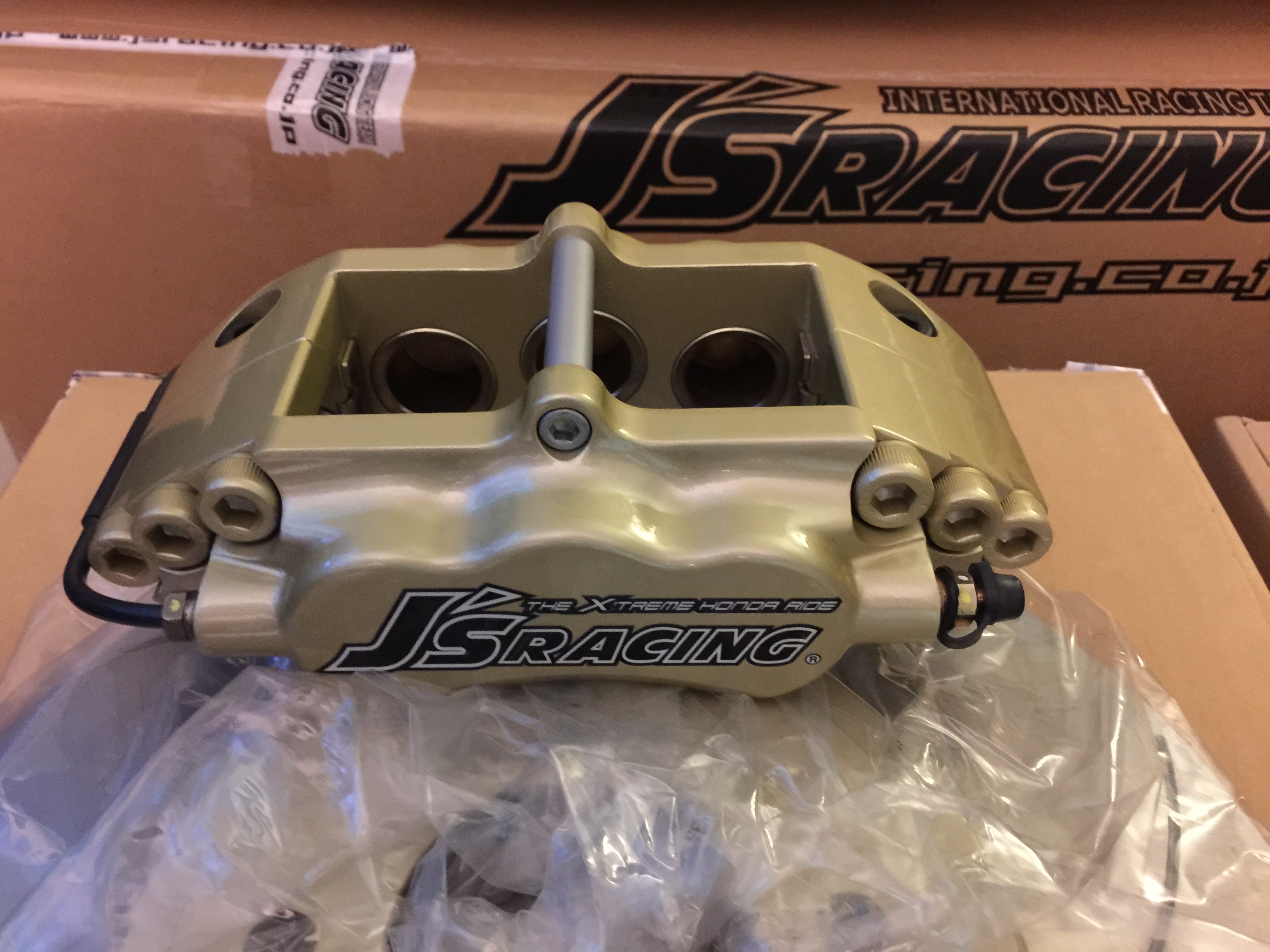

Just arrived today...
Waiting on some H&R 10mm spacers to still utilize my RE30s. Have some Advan RZs, Volk CE28Ns and CE28CRs (not till January) on order, all16x7+42 to clear the calipers. Recommended size by J's. The REs are 16x6.5+45. Tried ordering another set of REs, but Rays has stopped making sizes smaller than 18". Seems most of their wheels are no longer being made in smaller sizes, definitely all the new models.
