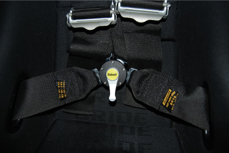

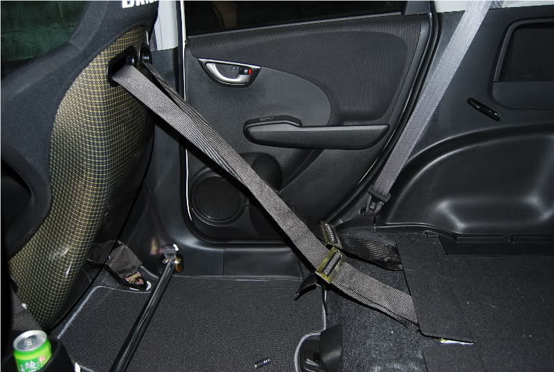

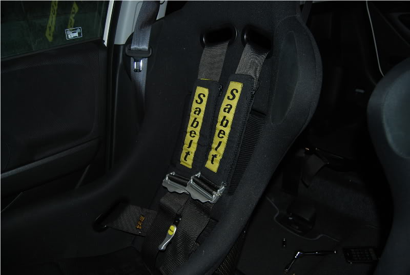

Tonight installed the Sabelt Top Formula A harness for Saturday, though not leaving it in as driving around on the street with a full harness is really dumb in my opinion, sure you are safe, but at the same time you can not move to see around things which could put you in an unsafe scenario. Unfortunately I have already owned this one for a little over 4 years and it expires at the end of this year. Sucks because the last 2 years it sat in a box as I couldn't really use it in the S2000. Oh well I'll try to use it as much as possible through this year and I'm sure for small events they aren't really going to look at the tag. I can hope right?
The last pic, the angle is about 40~42°(as measured by my iPhone), maximum allowed by the FIA is 45°, but ideally it should be about 10°. I now know why J's made their rear belt bar, there are only 3 holes that fit the standard eyebolt, the other 4 holes are a smaller diameter and possibly pitch. Thankfully I had another L mount that I used with 1 of the stock bolts used to bolt the rear seats in. Planned on eventually picking up the J's rear bar. I could of used 1 of the other holes, but 2 of the 3 are lined up more so behind the passenger seat and I didn't like the angle of the straps.

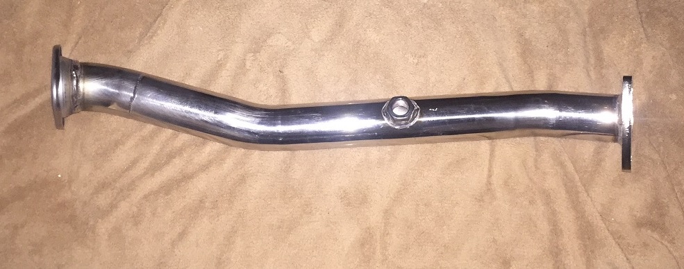

A few days ago I ordered up some new exterior pieces and then a day later just happened to come across a front pipe that was too cheap to not get. Yesterday both items were delivered. I still need to get the J's titanium front pipe repaired, but as I said the price was just too good to not go ahead and grab up the other one in the mean time to regain some upper end at the loss of low end.
This one weighs 1.46kg, so 820g more than the J's titanium piece, but is 1.84kg lighter than the stock secondary catalytic convertor.

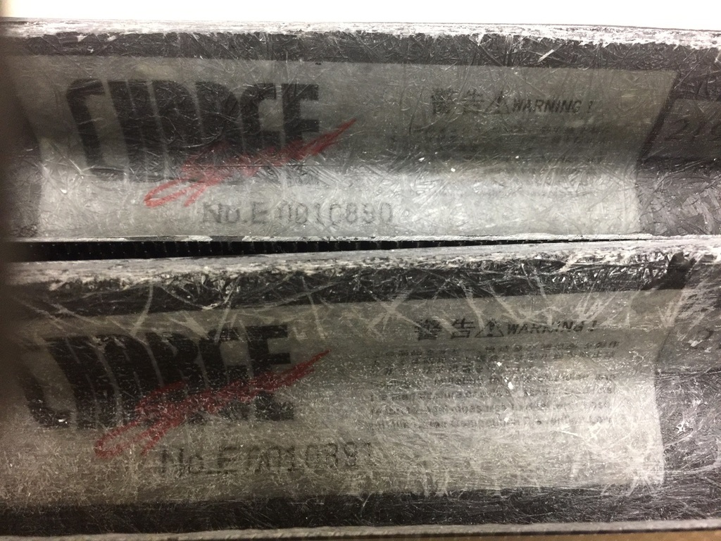

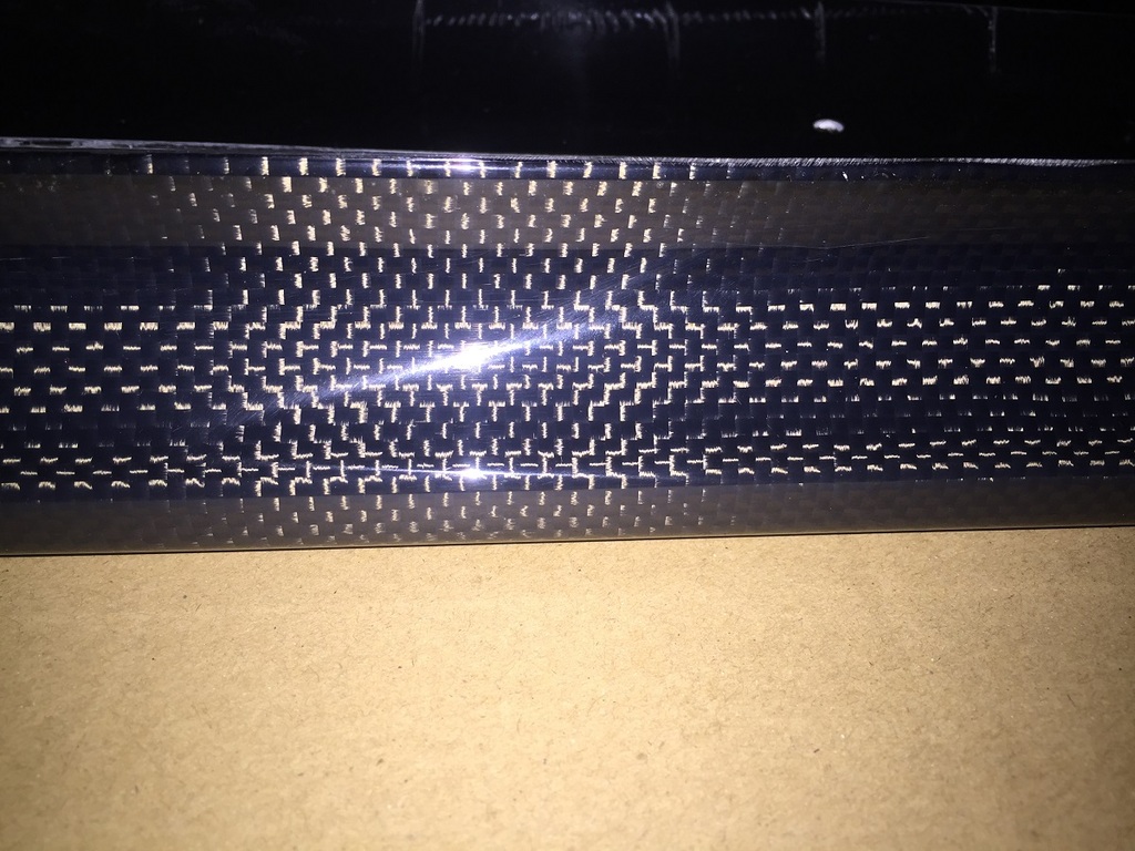

Charge Speed carbon Bottom Line side sills. Still debating if I want to swap to their rear diffuser piece to include the ends from the J's carbon diffuser.
