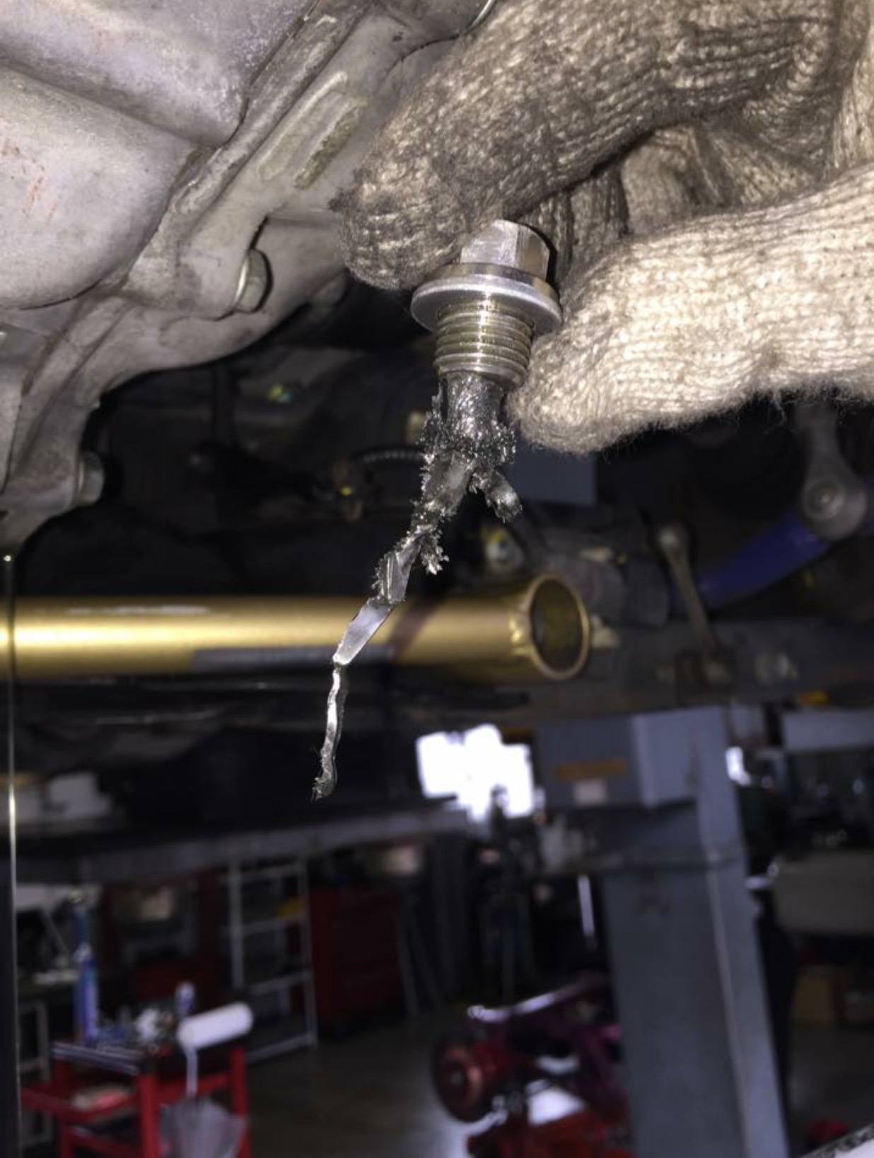

BMW, the J's brake master cylinder looks to be no different from the stock one visually, but since I had it installed, I have yet to feel the same spongy feel after a circuit run that I was feeling with the stock one and it wasn't air in the system as I could bleed it right after and no change till it would cool down a few hours later.
Sad note to my car, well sort of to my wallet, my mission is completely HOSED. I'm not sure what actually happened, did the Suzuka day, dropped the car off to J's, they pulled the drain plug the other day on the mission to get started on the rebuild of the engine and out came a long ass piece of metal on the magnetic drain bolt. No idea how much damage, but the picture made it look quite bad and Kaz told me the car was not going into any gear. After the first rebuild back in June, I was happy that 2nd was not jumping around, but to be honest, something didn't feel quite right with 1st and 2nd, but I just ignored it because it didn't seem like anything major and it was a VAST improvement to what it was. So J's is going to rip open the mission and see if the case itself is salvageable as well as the LSD, if it is not, I'm most likely going to swap to a 6MT running gears 1-3 from the Fit and 4-6 from the CR-Z with a special final drive and might move to a 1.5way LSD from the current 1way.

So Kaz sent me more photos after opening it up. It seems the bearings are what really shit the bed and from there more damage. The LSD will need to be rebuilt and the internal case is damaged. So I've got 2 price points, first to rebuild the 5MT or swap to a 6MT and I'm leaning heavily that way even though it is over twice as much. Just seeing how much quicker the 6MTs are on circuit is the main reason for this. Though I need to talk to my wallet and see if it will have any objections. Engine, tranny and sussy rebuild is costing me about 3/4 a new GK...OUCH, but a new GK would be sucking on my ass out on circuit when it is all said and done.

How goes it SLVR6? They are located in Osaka, Ibaraki section of Osaka. 34.829012, 135.563646 are the coordinates.
About not being upset, well I'm a little bit only because I just had the mission rebuilt in June, but I think the main bearings were missed as being ready to go. So that was just wasted money as it could have went towards the 6MT swap. I'm all about playing this car game though and I use the crap out of the car quite hard, so these things should be expected. Appreciate it.

Honestly, I can't say either way, but it seems the bearings were on their way out and I'm not sure if Seeker actually replaced those on the first rebuild. Like I stated, something didn't feel quite right with 1st and 2nd after the rebuild, so I'm leaning towards they weren't replaced and it was missed that they were on their last legs. Kaz told me, after their rebuild it will be the most beautiful mission I've ever used. It might be fluff, but I will say it made me chuckle at the thought of it being true.
Yeah, the current gearing in mine now is nice 3~5, the 1-2 spacing is quite lacking (all Fits are this way though) and it was even worse when I was using the stock final of 4.29 versus the MFactory 4.68.

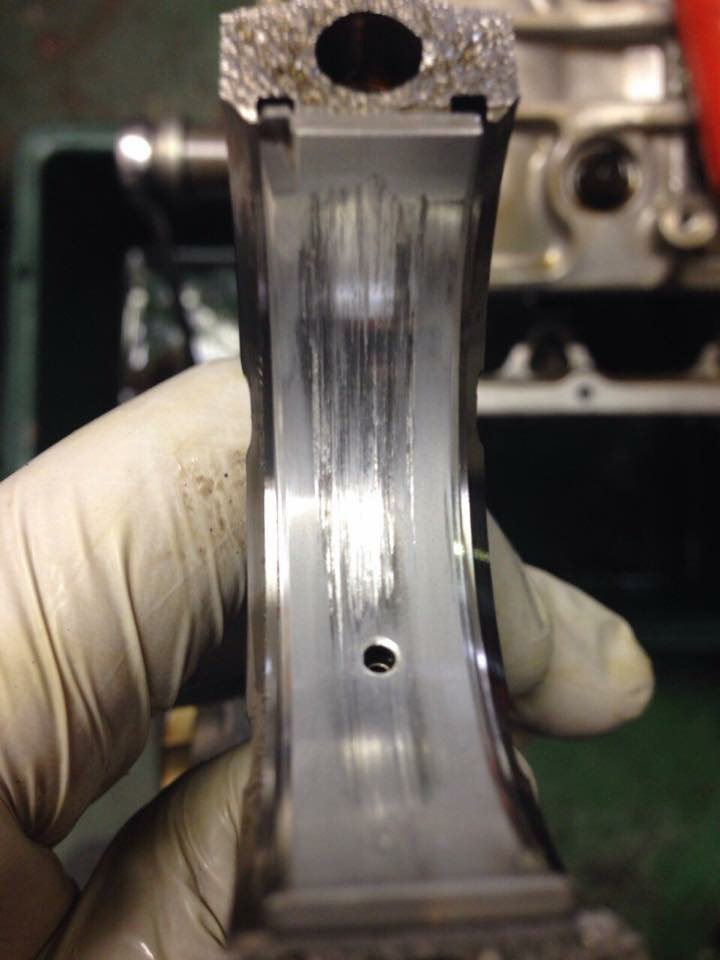

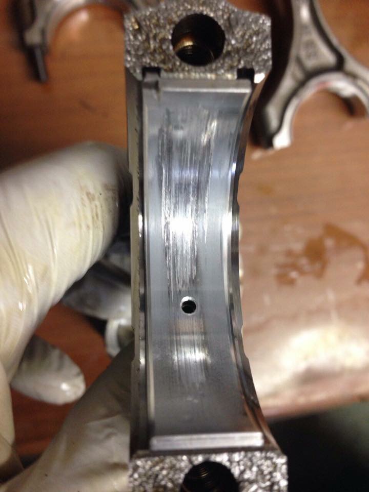

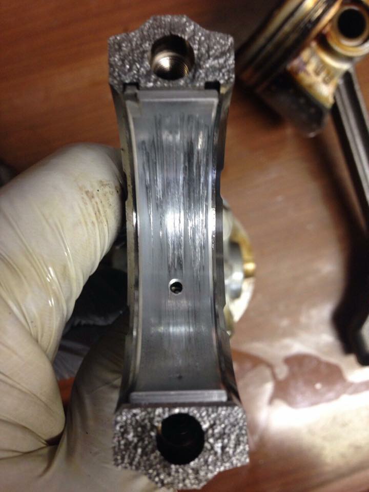

Received some more pics from Kaz of J's recently. All conrod bearings were scarred. It looks like I may be experiencing some starvation while out on circuit. I haven't really heard of Ls having oiling issues like the first gen Ks. I experienced that first hand in my old 5R, cylinder 2 and 3 the bearings were roasted during a gymkhana event. It's actually a good thing I decided to do this rebuild, because it could have been much worse if the bearings failed completely. The crank is still in good condition. Think I am going to have to seek out a baffling system. I know Spoon offers one for the CR-Z, so maybe I can talk them into producing one for the Fit. Though I would prefer a trap-door setup like I had in the 5R after its rebuild. Joe McCarthy from Prototype Racing had a nice setup and that is what I went with. Doubtful I will find anything remotely similar though.

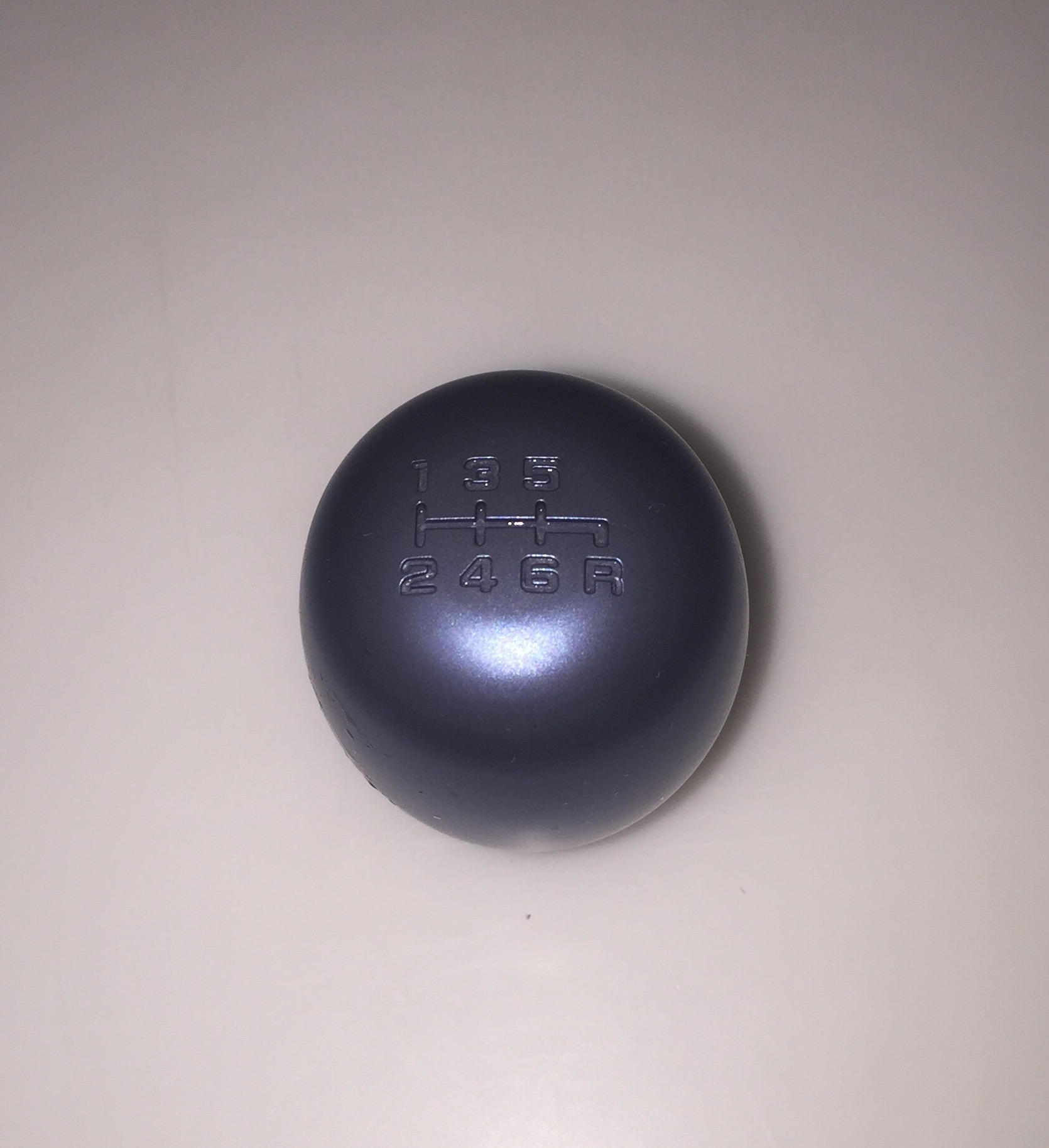

I also pulled out my old DC5R titanium knob yesterday (used it on the old AP2 as well) and decided to give it a bit of color. Used the oven set on self-clean and ran it for about 75 minutes. Would of done it longer, but was leaving the house and just didn't want it going while not there, just in case. After work today I will go pick up a torch and bring some more heat to it. I don't really want it blue blue like my J's one, just a bit more blue and maintain the sort of matte finish it has. Also need to get a thin-tipped paint brush and paint the numbers back to red. Getting ready for that 6MT.
