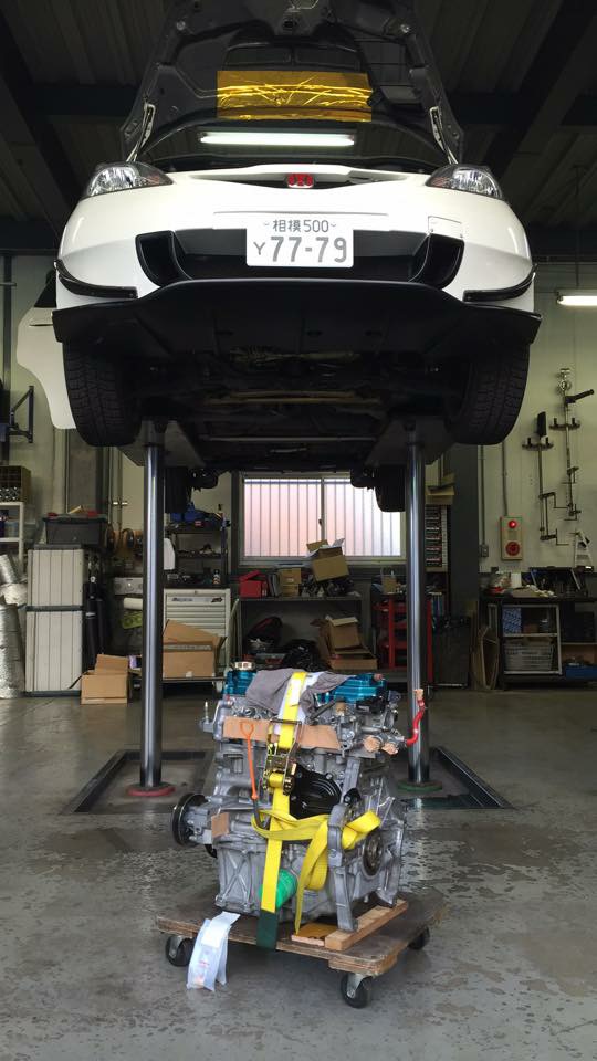

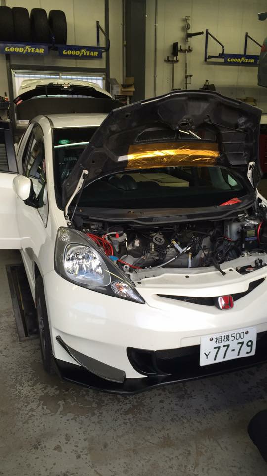

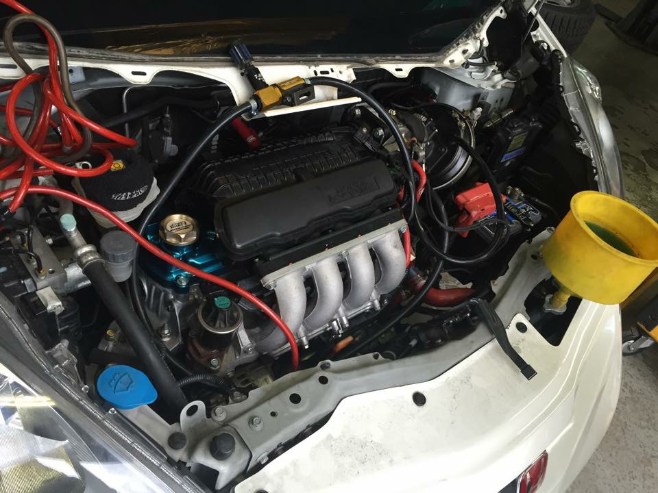

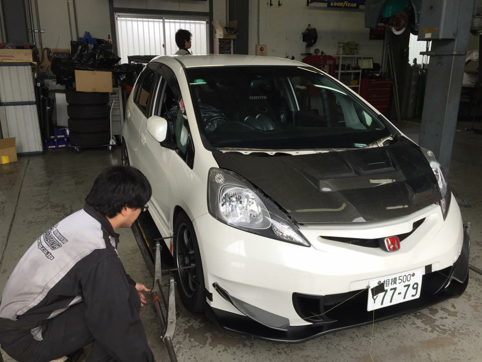

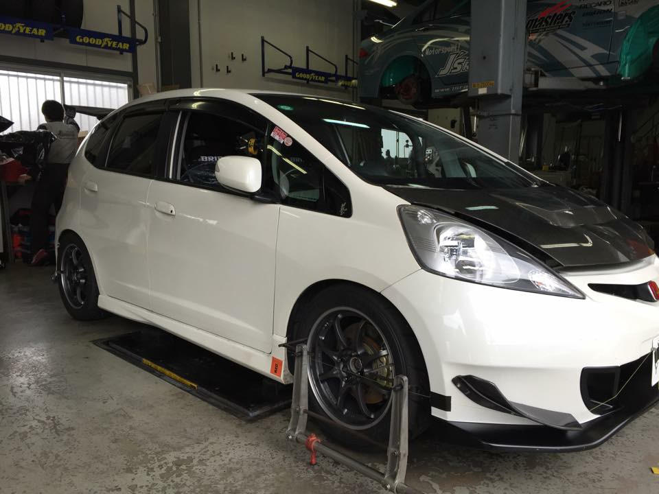

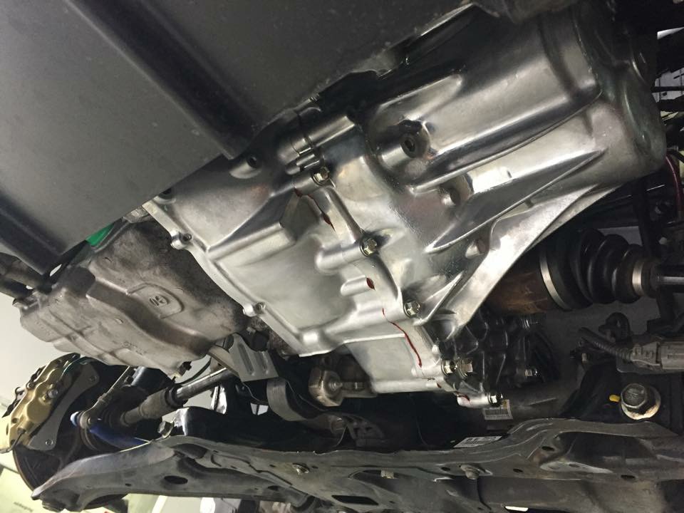

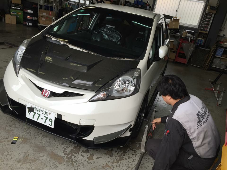

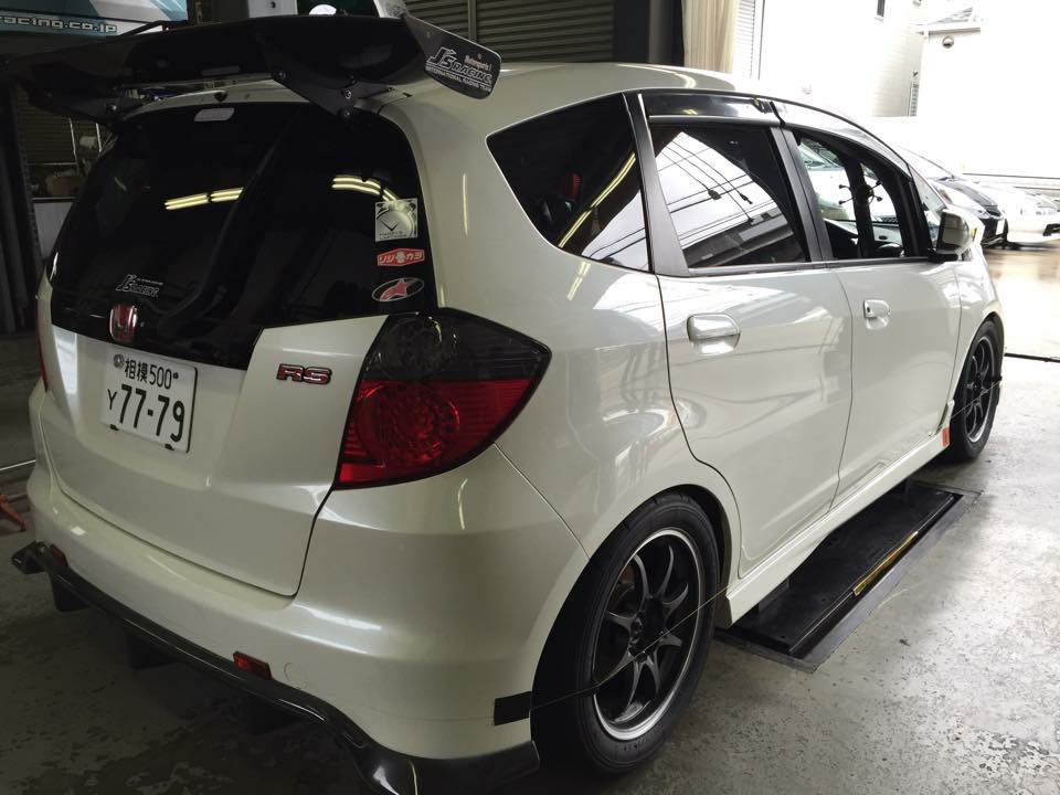

Slight update to the slow beast. Engine and transmission are in. Suspension setup happened today. Will be running -3.5° camber upfront with still a slight bit of toe out, rear end minimally raised to dial out some slight understeer. ECU tuning will commence on Tuesday and should be picking it up next weekend. Really looking forward to getting it back and begin thrashing on it once again.
Will have been a long 4 months since dropping it off.
