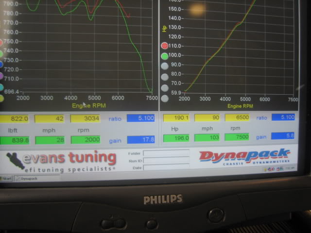

untuned test runs...
yellow numbers first untuned run and Green second untuned run...
Old Sep 23, 2009 | 09:24 PM
Yup, that was the untuned Baseline as I bought the car to Jeff Evans. I was on the money pretty much. I figured that before any tuning started, I was at about 200whp. (196 was close to my guess-timate).
It was the final tune number that got to me a little bit 220whp.... , so that's why I'm out for more HP on just a couple of those little things that my Midas Shop can handle no problem..... like CUSTOM MANDREL 3" EXHAUSTS!! hehehe
I'll be keeping everyone updated with the "(after tuning session 1)" graph when I get the chance to scan it. It has the baseline and the after tune mapped overlayed on the same graph. You can really see the gains and the magic of Kpro and a professional tuner!
