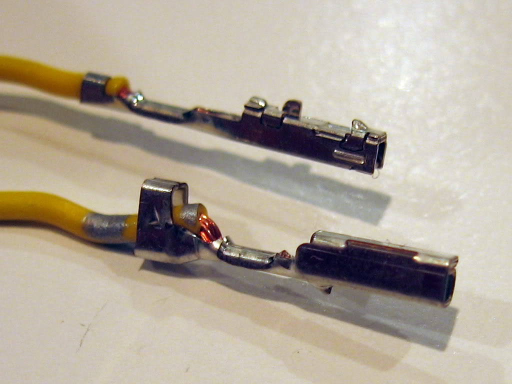

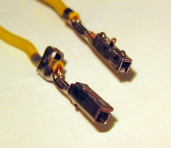

Niko:
Got my wire today, thanks! We need to know which pin corresponds to which connector (Wiper, or Q connector). Any easy way to tell before I start this mod?
Old Sep 3, 2009 | 09:01 PM
  #150
kotarou's Avatar
Posts: 25
From: Brazil, Sao Paulo
justintime, Could you please post a photo of both connectors side by side to have an idea ?
Old Sep 3, 2009 | 10:01 PM
  #151
justintime's Avatar
Posts: 384
Sure thing, here they are. Not sure which is which though!

justintime, Thank you very much.
By looking on your last picture, (I'm just guessing)... the Stalk pin is the one on the left and the Q the one on the right, since people said that the Q is smaller.
As you can see, I'm on the other hemisphere of the world, but trying to do the same.
I Already got a FIT GE6 and this:
The 04320-SAA-A00, fit's perfectly on the stalk.
And here the connector itself
I'm just not sure if i have the right stuff.

on this image the pin on top is the Q and the bottom
pin is the wiper.
another way. the wiper pin is bigger and the Q is smaller.

Got my Q wire today - thanks Nick!
Here are some micrometer measurements as best as I could make them given that the wire is attached - these are all outside dimensions:
Q- terminal:
Side view: overall length including crimp tabs 0.635", length of barrel 0.283"
End on view: height of barrel 0.079", width of barrel 0.066.
Wiper terminal (I have the 04320-SAA-A00 It looks slightly different from the one in justintime's photos - it has a shorter barrel)
Side view: overall length including crimp tabs 0.697", length of barrel 0.255"
End on view: height of barrel 0.088", width of barrel 0.081.
Paul
