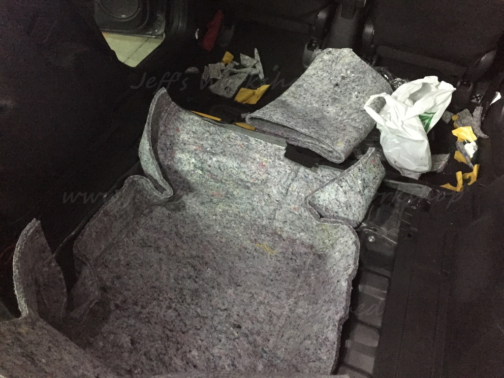

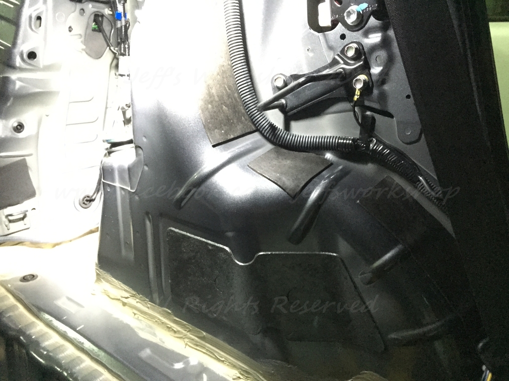

Ripped out the rear interior trim looking for the source of noise coming from the back(which turned out to be suspension spring seat...), thought I'd stuff some noise damping and absorbing materials in between the panels before fitting them back in.
A piece of vibration damping material and a big bag of noise insulating material
Rear wheel well vibration dampening pads applied. (the factory installed dampening pad seem to have dried up and lost its function...)

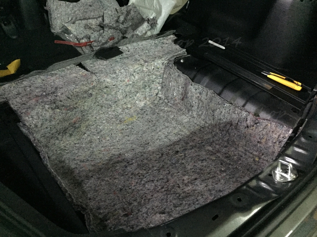

And finally the spare tire well
And covered
I can safely say that it has quietened down the clunking noise from the back by 50% or more, and reduced rolling noise of the rear tires noticeably.
However, the real culprit of the noise... Dealt with by shrink wrapping the spring end.

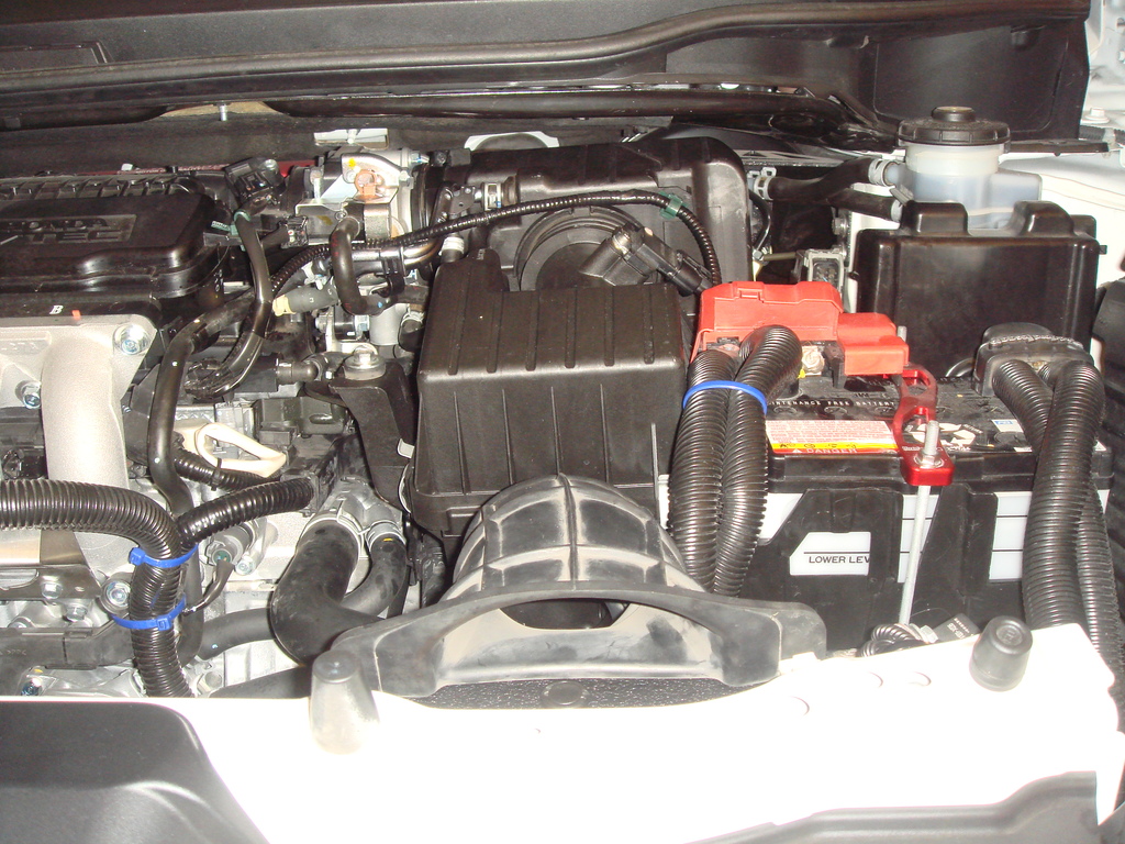

Remove my K&N
and install CR-Z Air Box

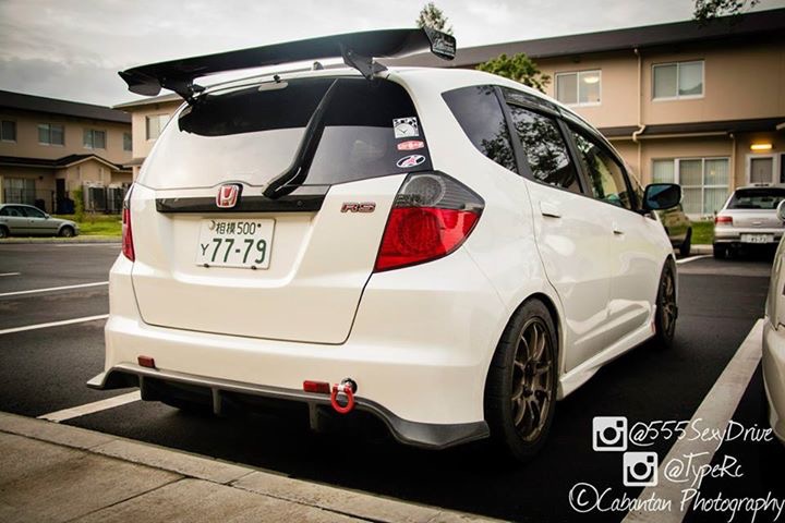

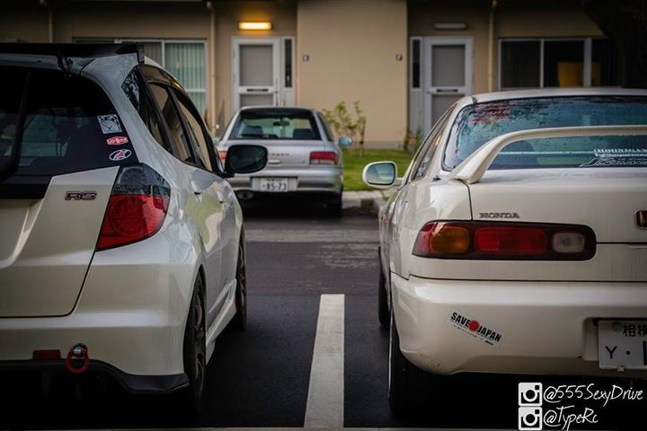

Got it back for a 2nd time from J's. It was the transmission seal that was nicked when putting it back together causing the very slight oil showing up between the engine and tranny. The new slightly shaved flywheel and clutch were installed since J's was opening it back up. No CEL on the drive back, which Kaz from J's did. I can't honestly say vast improvement, still yet to beat on it, but it does seem like it revs a bit quicker. Just need to get out on a circuit again. The new hobby of MTB is going to damage me.
Stopped by my friend's place and he snapped some shots real quick.
Finally!
Glad to see your beast back on the road
Attached Thumbnails What did you do to your GE fit today?-52efc06f-5867-4a0c-bbe6-d7773bd40884_zpseykshymd.jpg   What did you do to your GE fit today?-7bd1187d-1218-4268-844c-c9cf4aa2a7b7_zpsxawccqte.jpg
What tail lights are these?
Old Jun 18, 2015 | 10:36 PM
  #13279
connor55's Avatar
Joined: Apr 2012
Posts: 1,779
From: edmonton, canada
Thos are j's racing tails. About 600 a pair..
