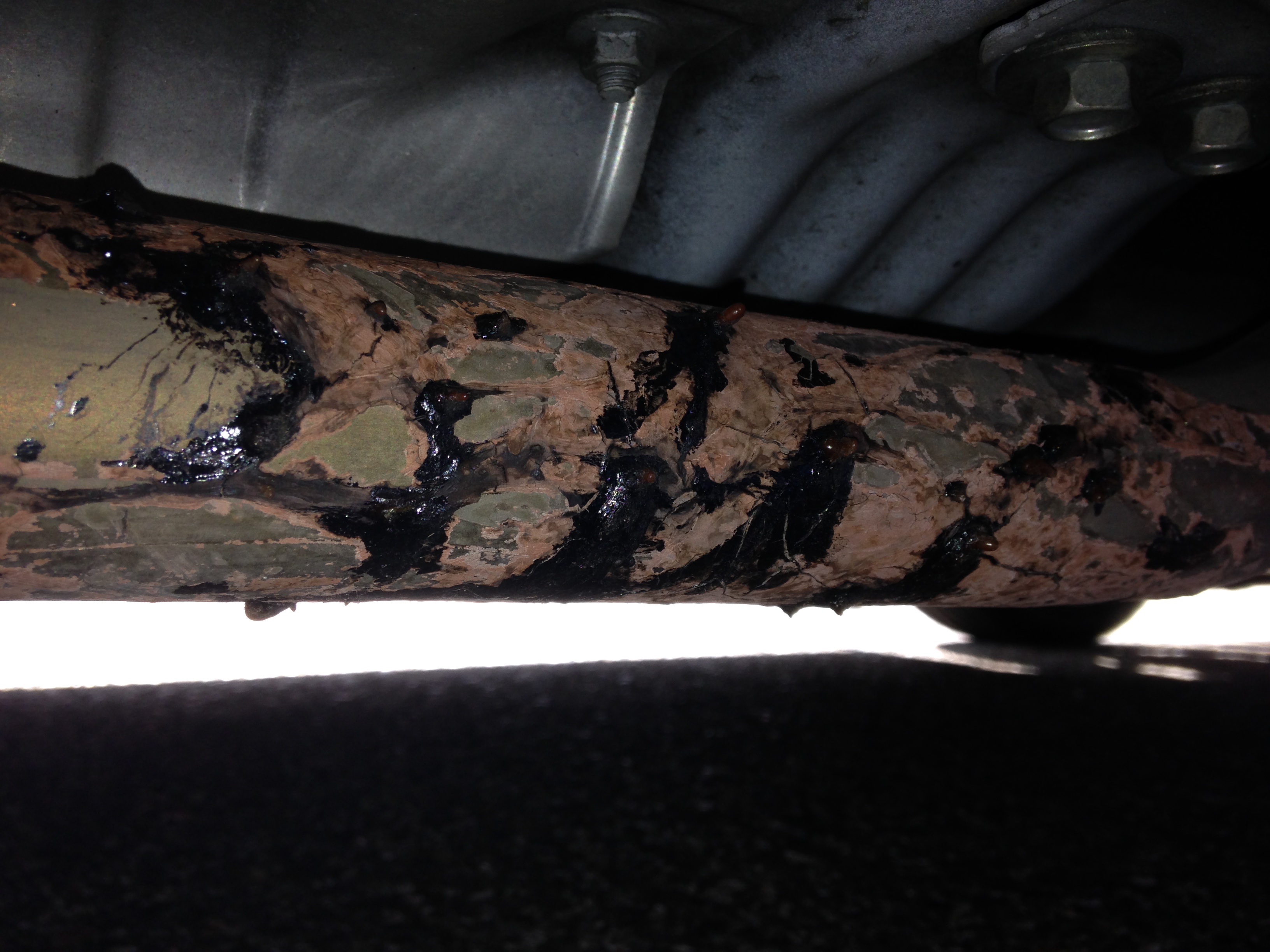

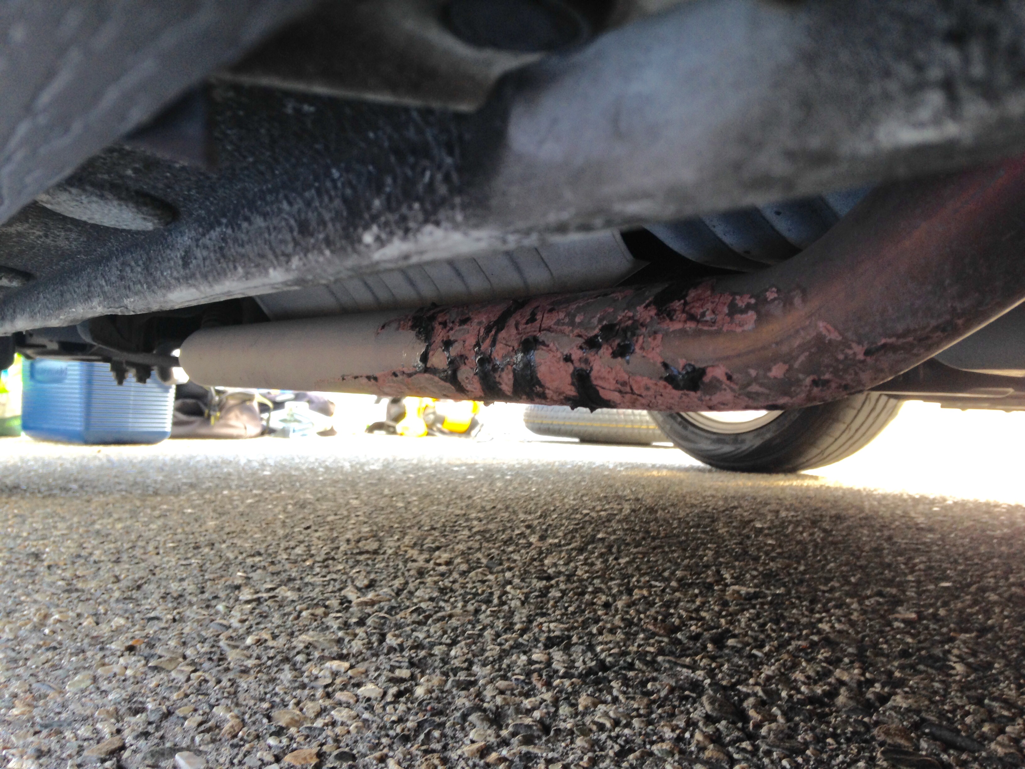

I actually noticed awhile back that my stock resonator is dented... Leadfootitis. I'll remember that one.
You ran over a plastic bag and some of it melted onto the exhaust. Looks just like my old car a couple years ago when that happened. By the time I could stop it was already melted and fused onto the pipe.

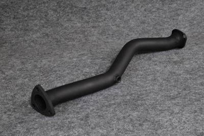

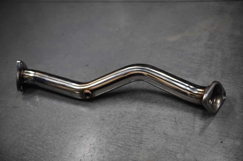

I just wake up and check my email and turn out Noblesse still can custom made the testpipe/racing converter/2nd cat delete for me
so I just paid for it, but delivery will be 6 weeks instead of 4 weeks due to new year holiday in Japan... but that's ok because I trust they will deliver as promise.
Here is the link:
?????????????????????????????? - Web Shop NOBLESSE????????????????????
They have 3 level of finished/quality and I bought the highest quality one which is the "SP" version because they add hand polishing to remove the weld where the flange meet the pipe for extra smooth air flow plus the also hand polished the outer stainless steel surface for super nice finish.
Here is the SP version explanation:
http://www.noblesse-japan.com/spfp.html
With shipping to US, they will cost approximately 3 times compare to T1R one shipped from Canada, but that's ok, as long as I am happy
I will add (weld) HJS 200 cell high flow cat to this Noblesse pipe, plus 2 more AEM bung for AEM UEGO sensor and Defi Exhaust Gas Temperature (EGT) Meters.
Initially I want to buy the HKS CR-Z Metal Catalyzer but realized their RIGID design with no flexible joint and no spring joint (like the factory OEM) will make them very vulnerable to cracking, and it already happened to item9 at CRZ forum...
so I look for another alternative,...
and I think this Noblesse with HJS Cat Converter should be even better quality/design wise than the HKS one.
Plus, I can combine factory Honda OEM header/down pipe (if I have too) with this Noblesse pipe.
