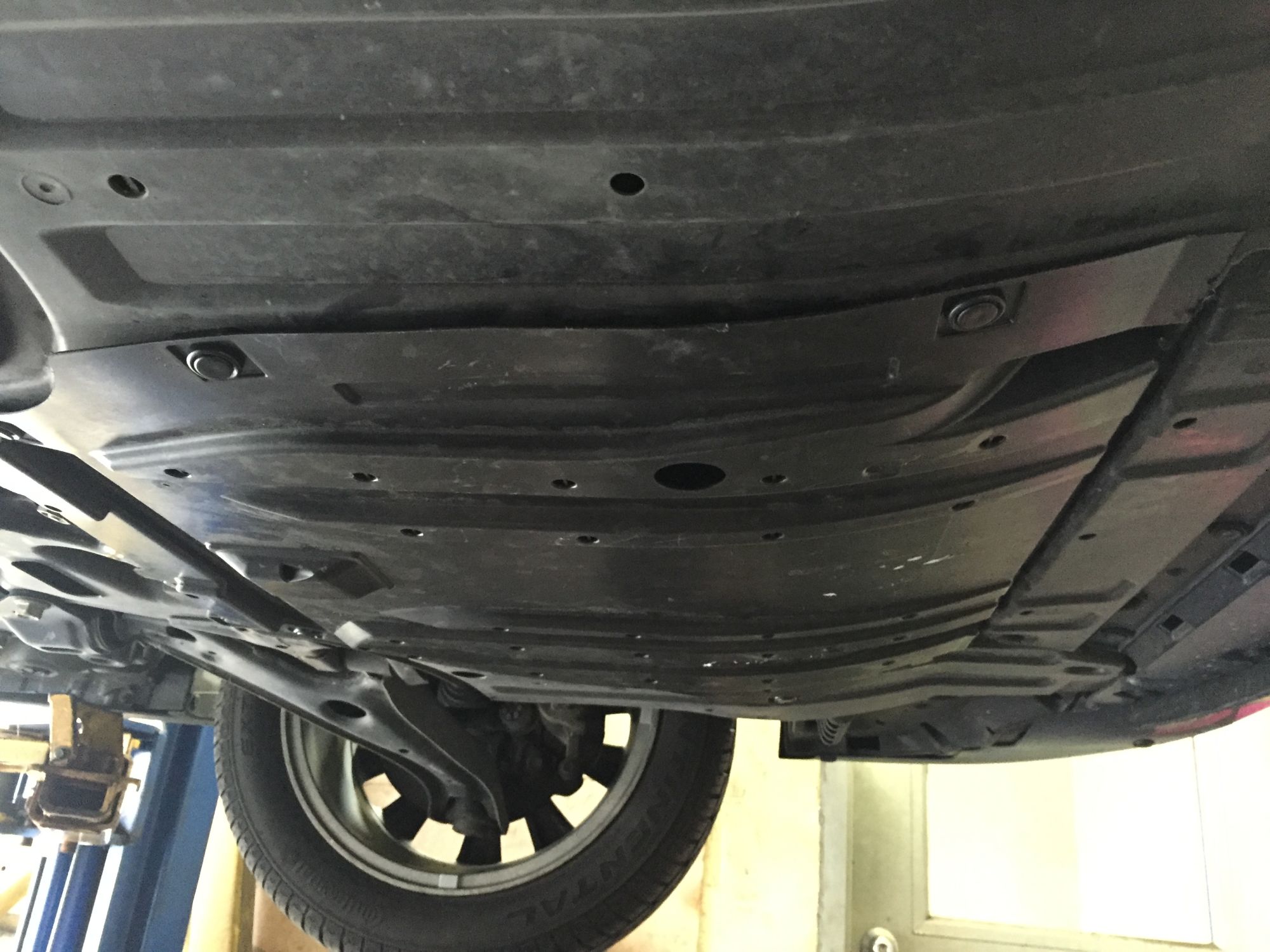

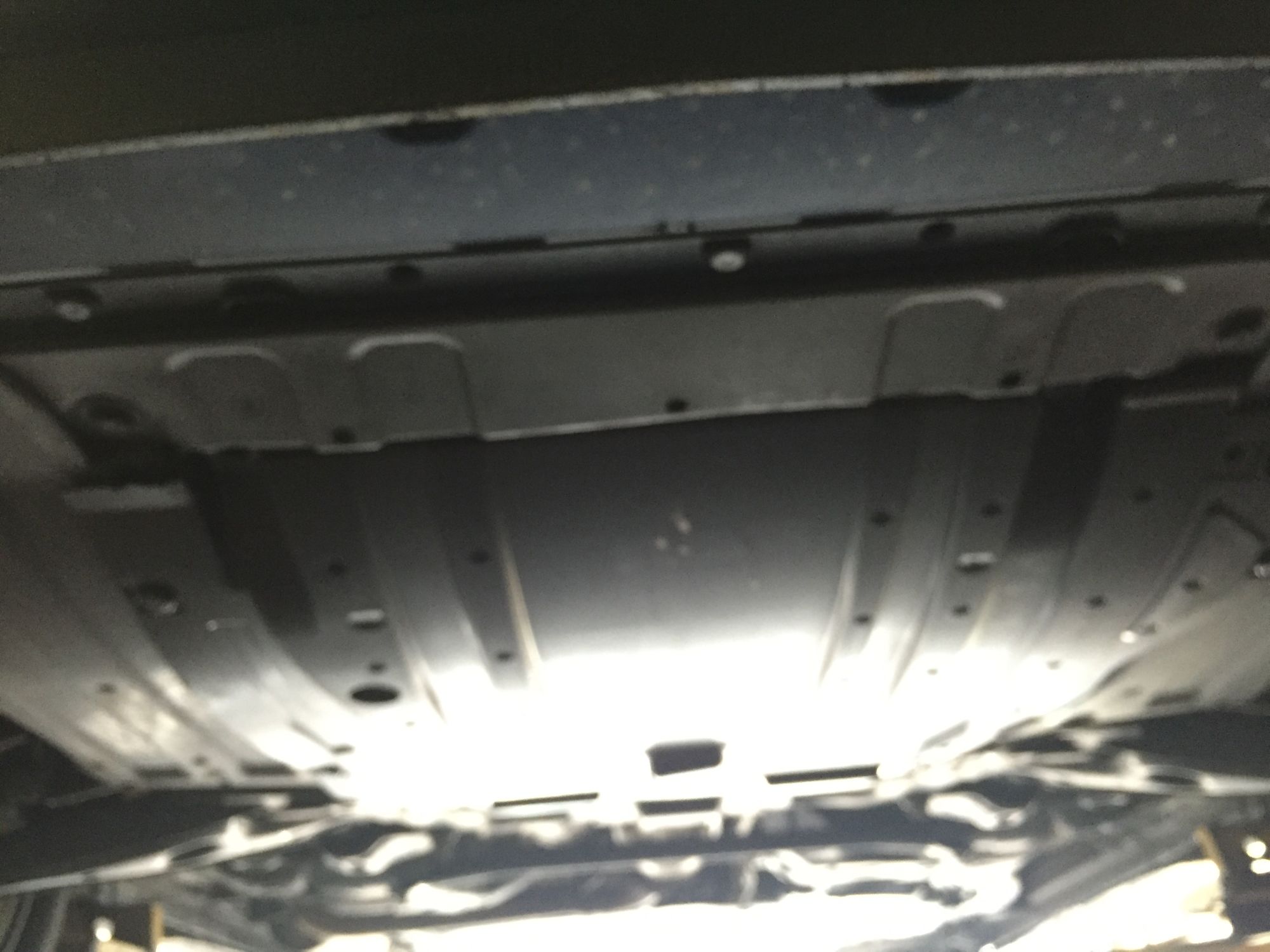

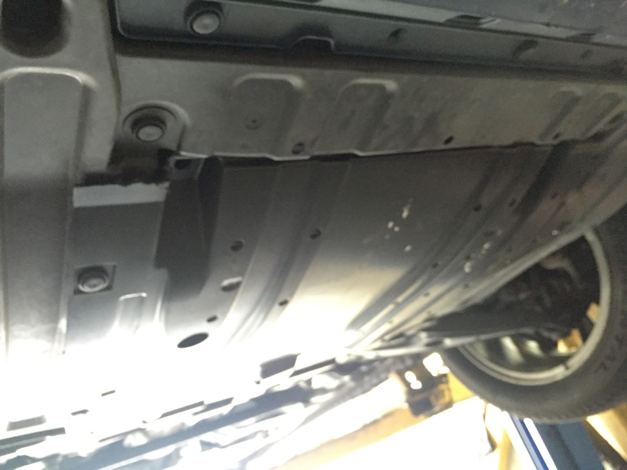

- Got the CR-Z Engine cover installed. Cut slots on the front area to allow the tabs/flaps to be inserted so there's no chance for the front part to fly off from high speeds. Used only plastic clips to secure the entire cover.

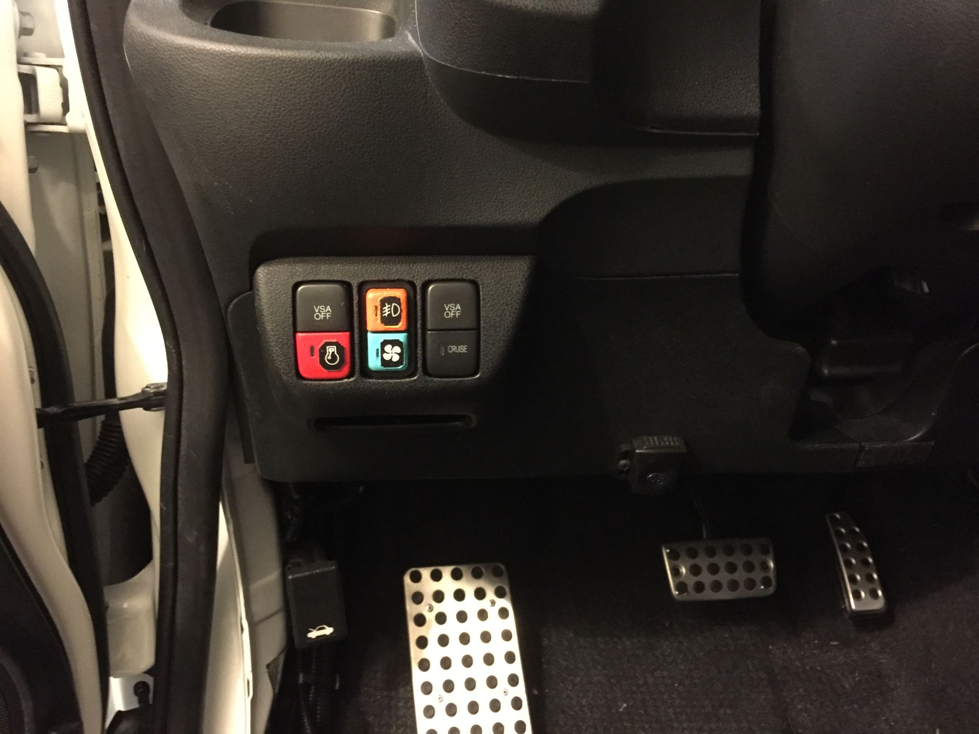

by the way, this weekend I also manage to install the switches for controlling:
a. AEM F/IC-6 Second MAP(Tune)
b. Setrab Oil Cooler Fan and SPAL Third Radiator Fan
c. VSA Switch (relocate)
d. DRL switch so I can turn off DRL manually if I want to. (this is when I have money to buy VLED V3-Triton Switchback)
e. and some extra switches for the future
f. 2 relays to control VSA and AEM F/IC-6 Second MAP (Tune)
DIY wil come later when I have all the Setrab parts to install the other 2 relays still needed for DRL and Setrab/SPAL
The Switches are all sourced from modified Honda CR-V switches (VSA/Cruise and Seat Heater Switches), yeah I am suck at painting

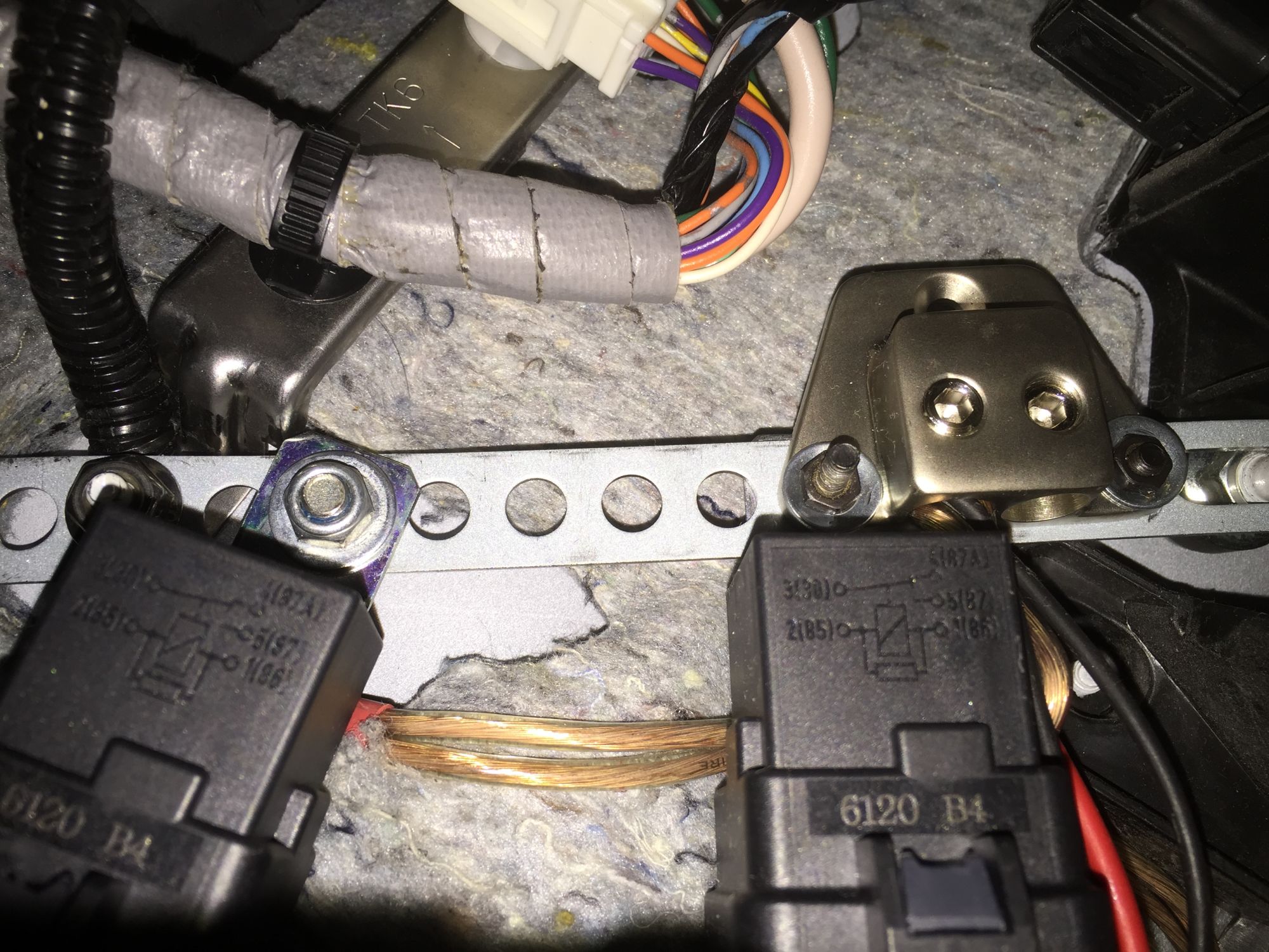

The 2 HELLA relays below the dashboard with bracket and Streetwires Ground Terminal/Block:
