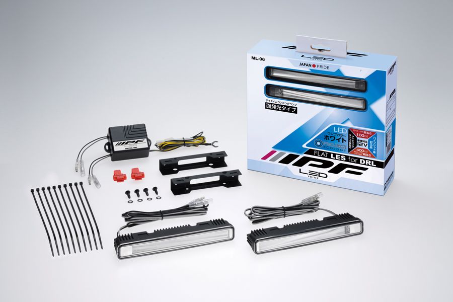

the only alternative for me is buying this unit:
///IPF FLAT LES for DRL ML-06
After careful consideration...
I decide not to but the above IPF DRL LED set, because I just prefer the OEM look with the DRL integrated in the main headlight housing... plus those LED no matter how thin, will interfere with the flow of cool air into my oil cooler/radiator... and I had done a lot of detail modification to increase this airflow, so I am not going to let some LED light reduce the air flow no matter how small hahaha,
that is why VLED Triton is my only choice...

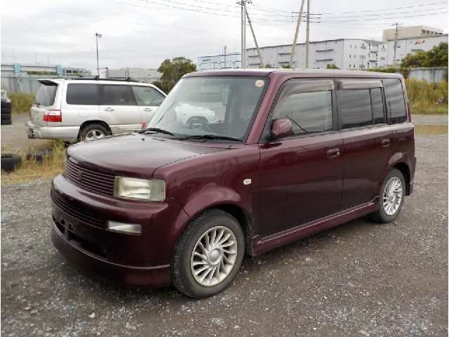

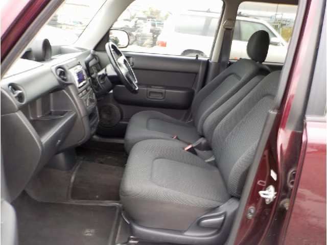

^yes sir! Could not be more excited about getting later this year. Heres a couple pics at the shipyard in japan. (Sorry wont spam too many non fit pics here lol)

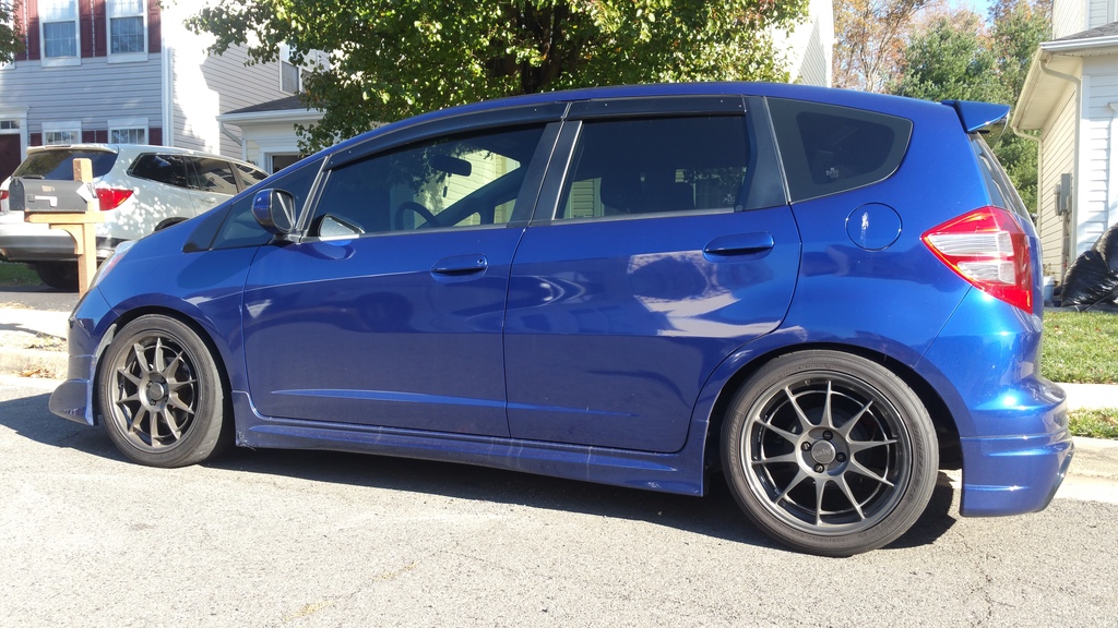

I had developed some serious rub issues up front. The car was just was just way to low. Although I liked how it looked, I really prefer to be more functional and drive spirited around twisty roads.
So I finally got out there and raised up the front a significant amount from where it was. No more rubbing and so much more fun to drive now! The Dunlop Direzza ZII star spec tires are super sticky! It really showed me how unsupportive our stock seats are. I was getting thrown around lol
Excuse the filth, it desperately needs a bath.
Attached Thumbnails What did you do to your GE fit today?-20161112_135302.jpg
