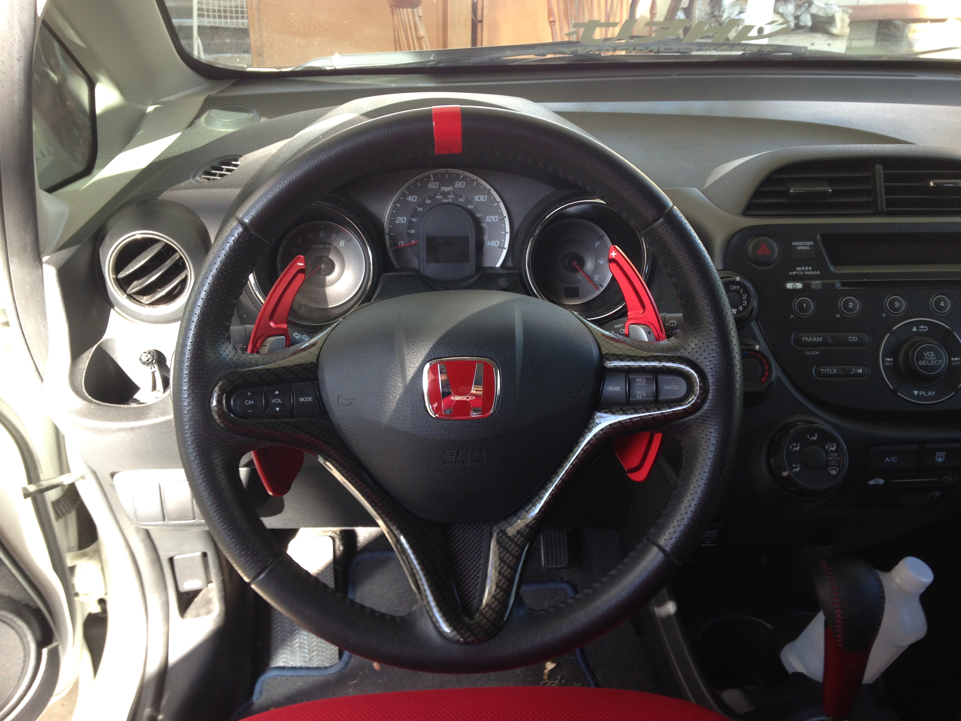

Very Nice
Where did you buy those Paddle Shift Extender? Please... ?
Edit: found it on eBay:
Pinalloy Red Alloy Steering Paddle Shifter Extension Fit Honda Jazz Civic CRV | eBay
I just buy one for me...
I see the seller had sold 2 piece before me, that must be you and FittedonEM?

FittedonEM had silver ones, but I am sure its the same seller.

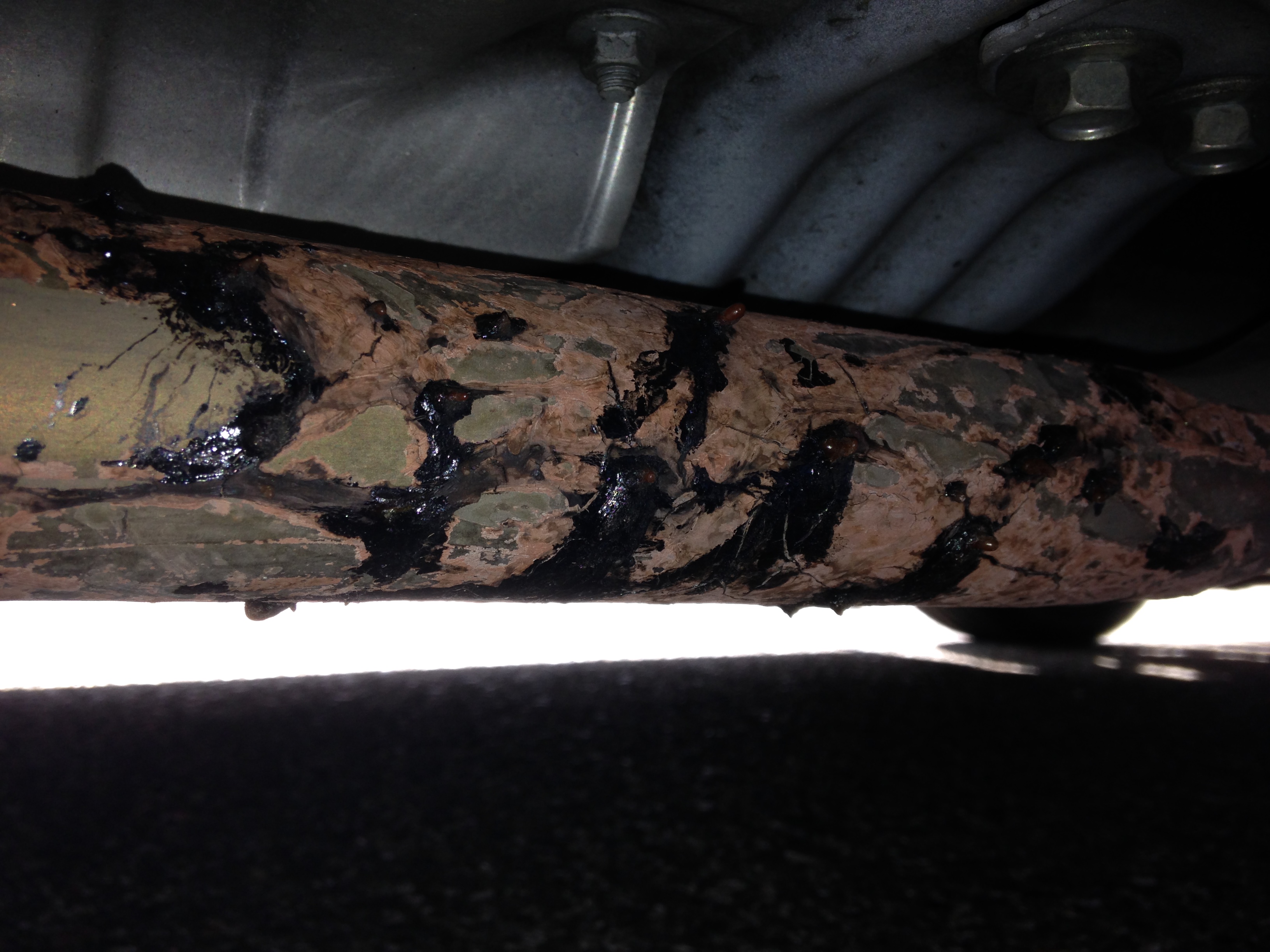

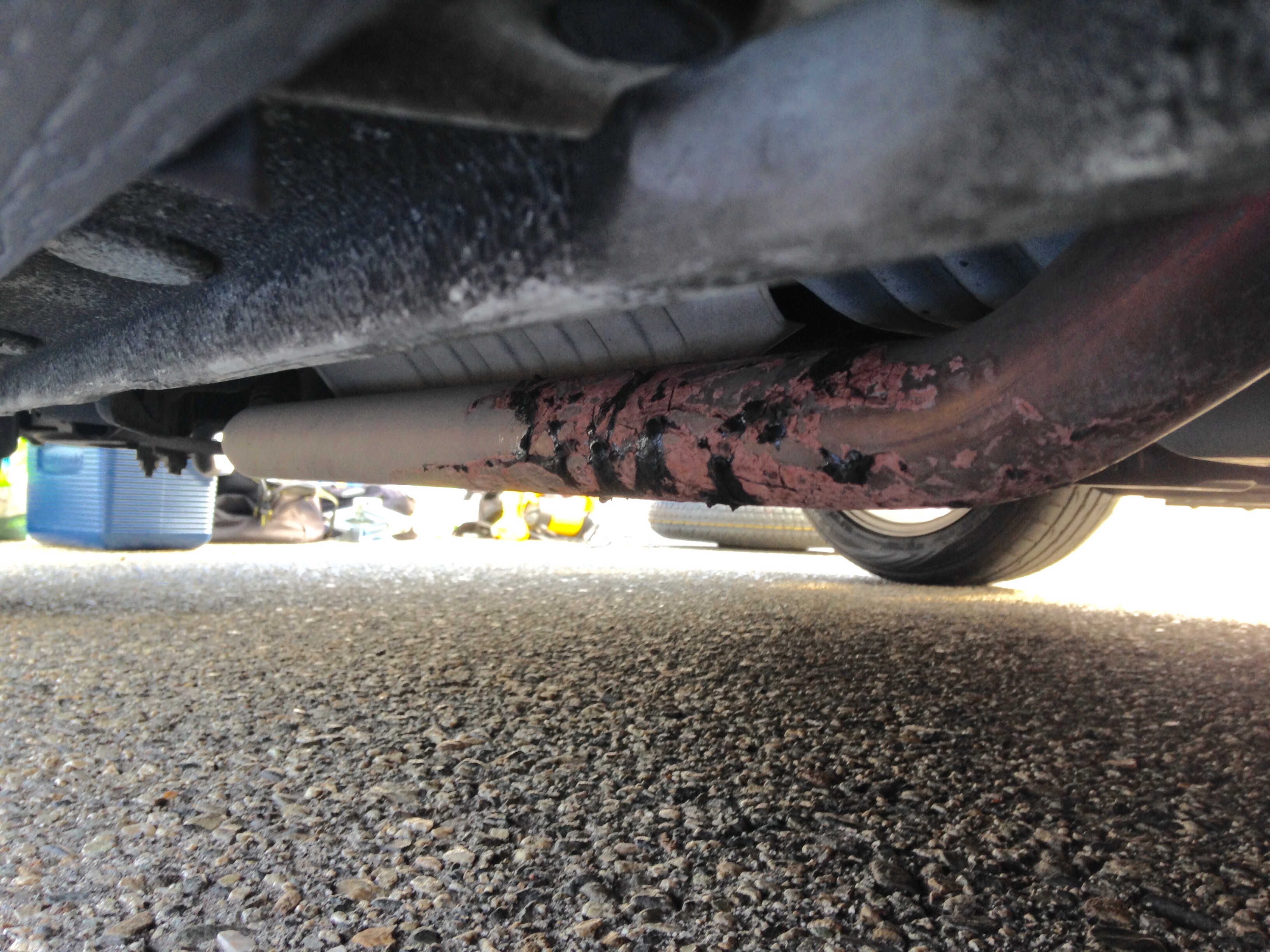

I noticed something really odd on my exhaust pipe while under the car yesterday. It is the pipe between the resonator and muffler. It looks like some sort of tar or sap like substance, and I am absolutely stumped.
Any ideas??
Any ideas??
Hi Mr. Hollow, you must had parked somewhere where there is a lot of dry grass or dry tree leaf...
When I work at my car dealership, the new cars, always parked at the same spot each time, and at the center of it, usually there is tons of dry tree leaf collected and become small mountain... (the subcontractor who wash our new car on the lot 2 times a week are lazy and don't want to clean underneath the car)....
in rare cases, where we need to rearrange the lot and that make the position of the cars change,... the mountain of leaf suddenly not at the center anymore in relation to the car.. and sometimes those leaf got sticky to the hot muffler/exhaust pipe from car return from "hard" test drive.
and in your case, you must had parked on top of those leaf, or the leaf got blown by wind and deposited under your exhaust pipe while it still hot.... those exhaust pipe of ours located on the right side of our car (near curb) so another possibility is you park on mountain of some kind of trash near the curb that you missed (perhaps it was dark at night when you parked....)...

When I asked about the steering wheel I was actually talking about the 2012 (I should've clarified) which has the circular buttons instead of the GE style. I actually found a potential solution to this but it involves using a Raspberry Pi, which I'm interested in but will not be doing for quite awhile. So for the steering wheel I think I'll just end up ordering a non-Si model on eBay for ~$60 which should be a direct fit (I'll have to mess around with the wiring). Also, sounds like A&J racing is a no go
, I prefer not to deal with companies like that. Another quick question... Does anyone know how to get an alignment done where they actually mess with the coilover camber? I want a slight bit of negative camber so my tires will more easily clear the front fenders but I want it done right. My BuddyClub N+ has camber adjustment but I am not sure how to do it accurately, right now it's just based on "visual analysis."

I initially use this one, Dynomax 24234 Race Bullet Muffler
https://www.amazon.com/gp/product/B0...?ie=UTF8&psc=1
and it make the car sounds very very deep (at idle almost like a V8),
unfortunately since I place this between the second cat and the Civic Si resonator (I have the Civic Si resonator at the stock resonator location),
I run into ground clearance problem, it scrape badly whenever I went over speed bump so I had to replace it with the thinner diameter Vibrant, which not sound as deep as this Dynomax...
Also if you could upgrade to at least 2in piping while you change your B-pipe with custom one, that will help your upper end performance.
I think the T1R B-pipe is 2 in...

oh, one more thing, when I change my J's racing steering wheel, the steering wheel would be slightly off center when the car go straight,
so I also use the toe adjustment to make the steering wheel center again when the car run straight...
when you change the steering wheel with the civic one, this might happened to you... (they have gear engagement on the steering wheel shaft, but if you skip gear trying to make the steering wheel center, the steering wheel is either too much to the left or too much to the right, you will understand what I am saying when you install your new steering wheel).
