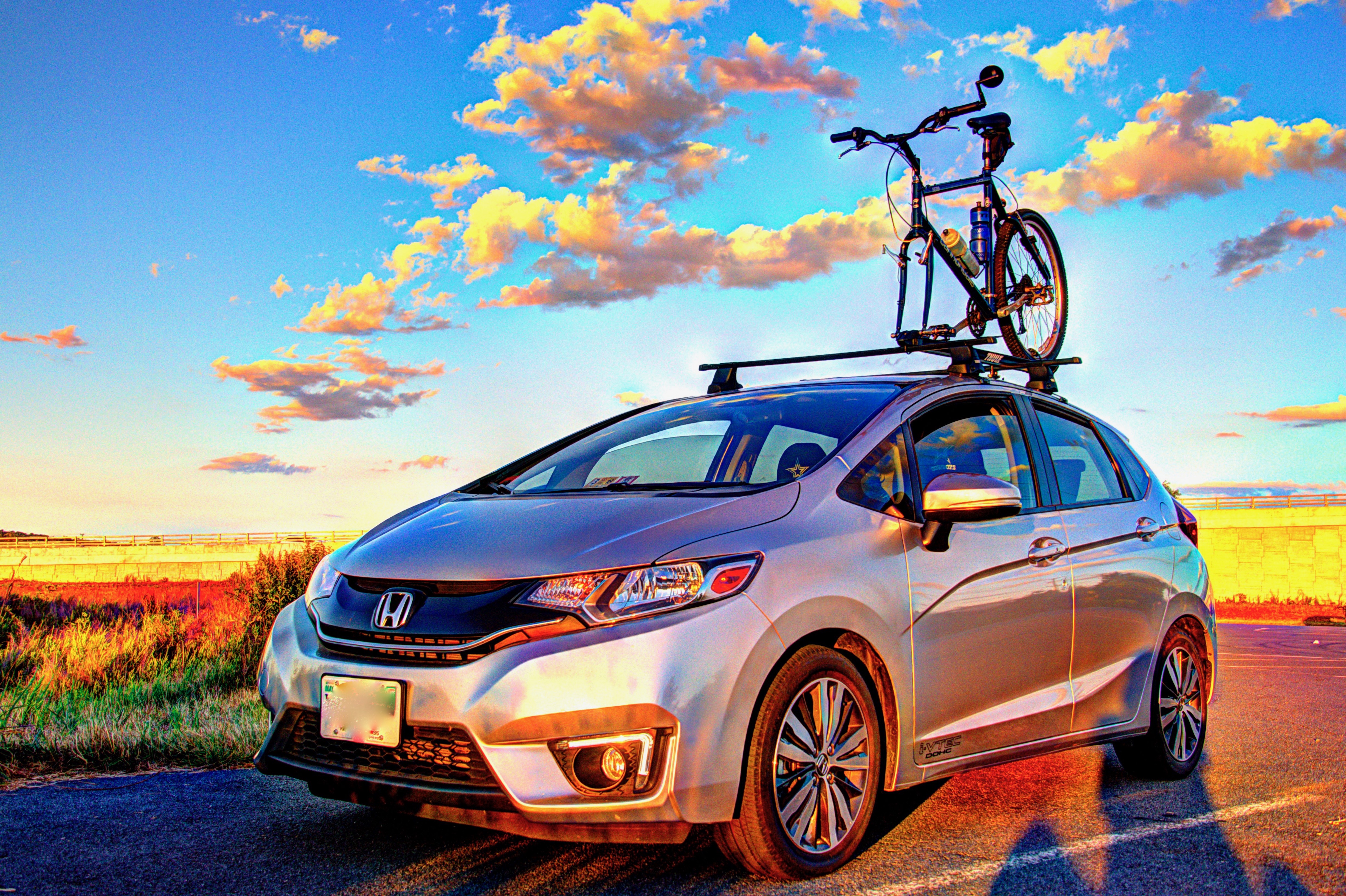

Bike Rack
put on the bike and hit the trail
Attached Thumbnails What did you do to your GK Fit today?-set01surreal23from_img_6804.jpg

Is that the Yakima round bar setup?

No. Thule square bars.
