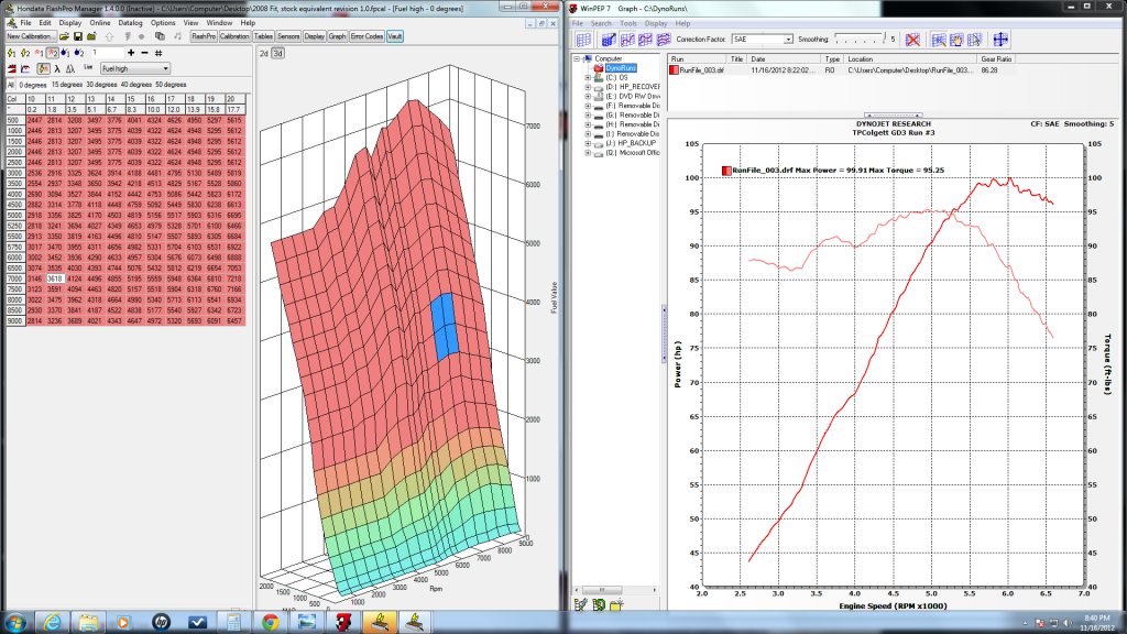

Well good news everyone!
Tyler's base tune and dyno runs are in!
Feast your eyes on this:
Yes, that is an 11whp bump from an extremely rudimentary tune!
"So what?" you say "For $600+ I only get 11whp?
Lets put that in perspective.. that is a 12.4% gain in power from merely adjusting the fuel trims and NOTHING ELSE
Compared to the T1R turbo kit, for example that is a better dollar/whp ratio.
A&J Racing :: Engine :: Turbo :: T1R Type-S Turbo Kit - Honda Fit/Jazz 06-08 (GD3/GD4) (USDM)
T1R 145whp @ 4.5psi = 62.9% increase over stock for a 5MT GD3
FlashPro Base Tune = 12.4% increase
Now lets look at this in terms of "bang for your buck" ... The T1R turbo kit makes 5 times the power, but 7 times the cost.
Who remembers this article?:
Honda Fit Power Pages - Import Tuner Magazine
Where they spent $1050 for 9whp? And what they don't mention in the article is how the gains get pulled back into the fold by the stock ECU when left to make up its own mind.
Very few opportunities like this in the tuning world, especially on such a small displacement motor, that is so well optimized from the factory to begin with.
Now this shop and their tuner, who shall remain nameless, was not the shop he initially intended to go to.
They dropped VTEC activation too low (~2500rpm) which is why there are two dips early in the rev range and they leaned it out a bit too far, almost 13.7:1 AFR under full load in a couple spots. No knock was detected, and no knock retard was shown in the calibration so it is a safe tune, but not ideal.
Meaning that there is still more to be had.
Updates to come.
When I said, that like ECMLink for DSMs, VAGCom for VWs, Pro EFI/FAST for the V8 folks.. this should be the first proper mod you do for your Fit.
Otherwise all that money you would spend on I/H/E is for nothing because the ECU will adapt to it and bring your power back down.
FlashPro makes it permanent, and then when its time for emissions, you can revert back to your stock maps and have all your monitors ready to go.
This is a giant leap forward.
