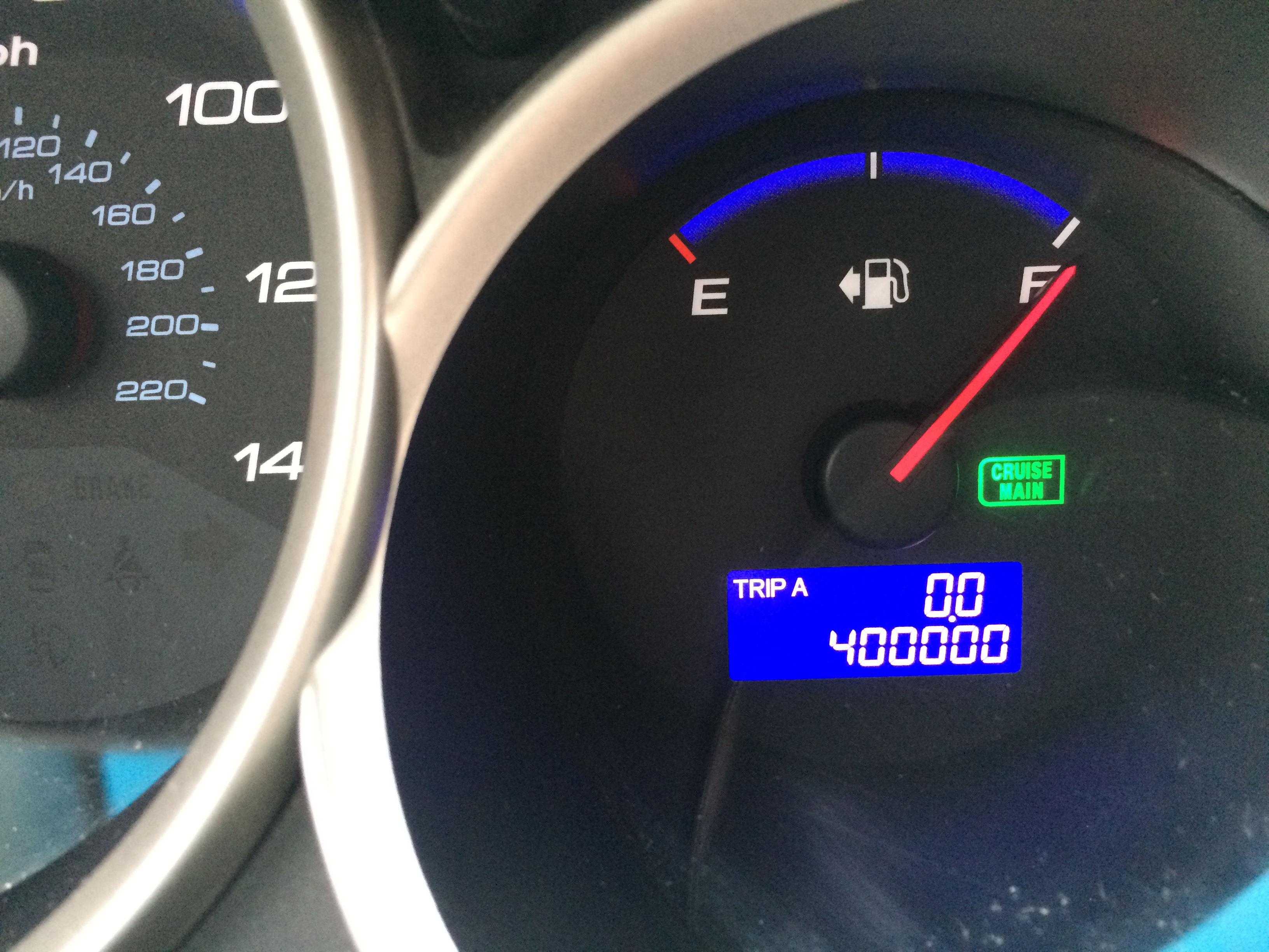

Just Turned 400K
My Silver 2007 Fit Sport Manual just turned 400K. Been running great and still getting 33 to 35 MPG on mostly highway driving at 77 mph. Just need to get my AC fixed again (3rd time). Other than that very inexpensive to drive and maintain.

Just wanted to ask if you have had your valves adjusted? What has your problems been with the Air conditioner? I'm installing my 4th blower fan tomorrow!
Old Jun 25, 2018 | 09:26 PM
  #419
gutsi's Avatar
Joined: Mar 2014
Posts: 6
From: Ohio
Valves adjusted only 1 time, at 237k. Factory A/C Condenser gave up at 239k. 1st Aftermarket Condenser lasted 6 months. 2nd Aftermarket Condenser lasted 3 years.
