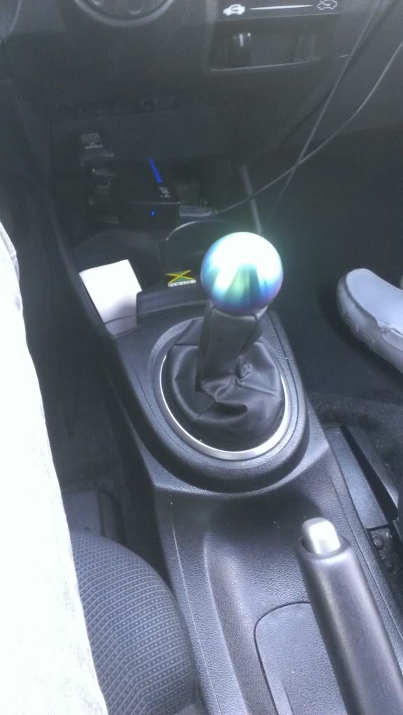

blox490 neo shift knob. and it is as my research had found:
heavy
smooths out shifts
looks awesome
and hot on sunny days

i kind of like it.

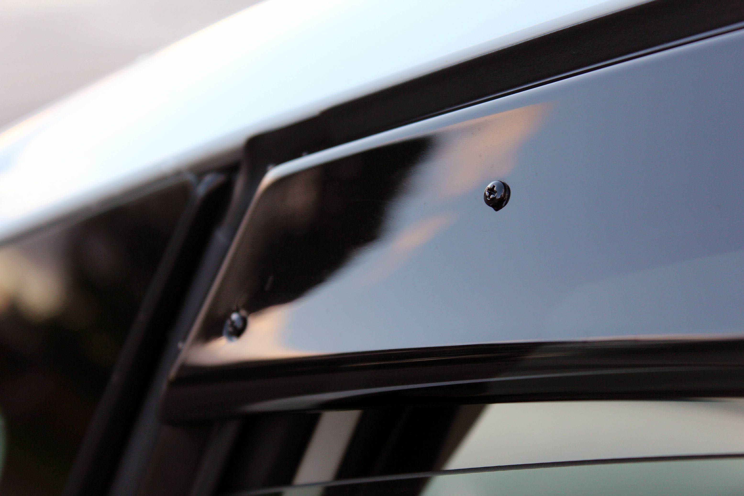

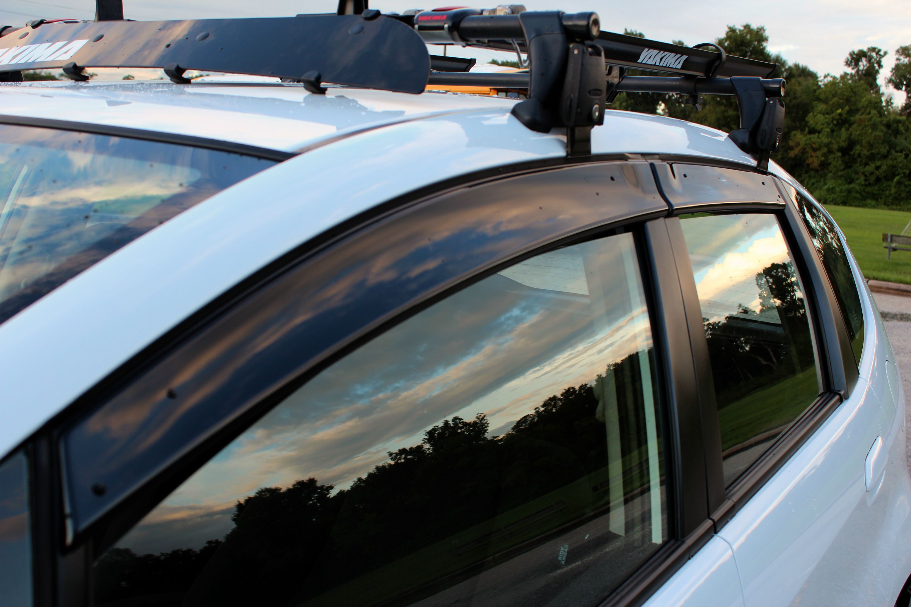

Replaced the window visor hardware with some threaded fasteners. Should be self-explanatory but can do a DIY post/pm if anyone needs.
I failed to heed everyone's warnings to be careful with the OEM push pin fastener thingies.

That's what I need to do, where did you pick them up from, lowes/Home Depot?

I had a local Ace nearby, but both those should carry what you need.
#4 or smaller would work with a length of 3/8" or 5/16". I also had to pick up some paint to blacken the heads.

Thanks a lot, looks great
