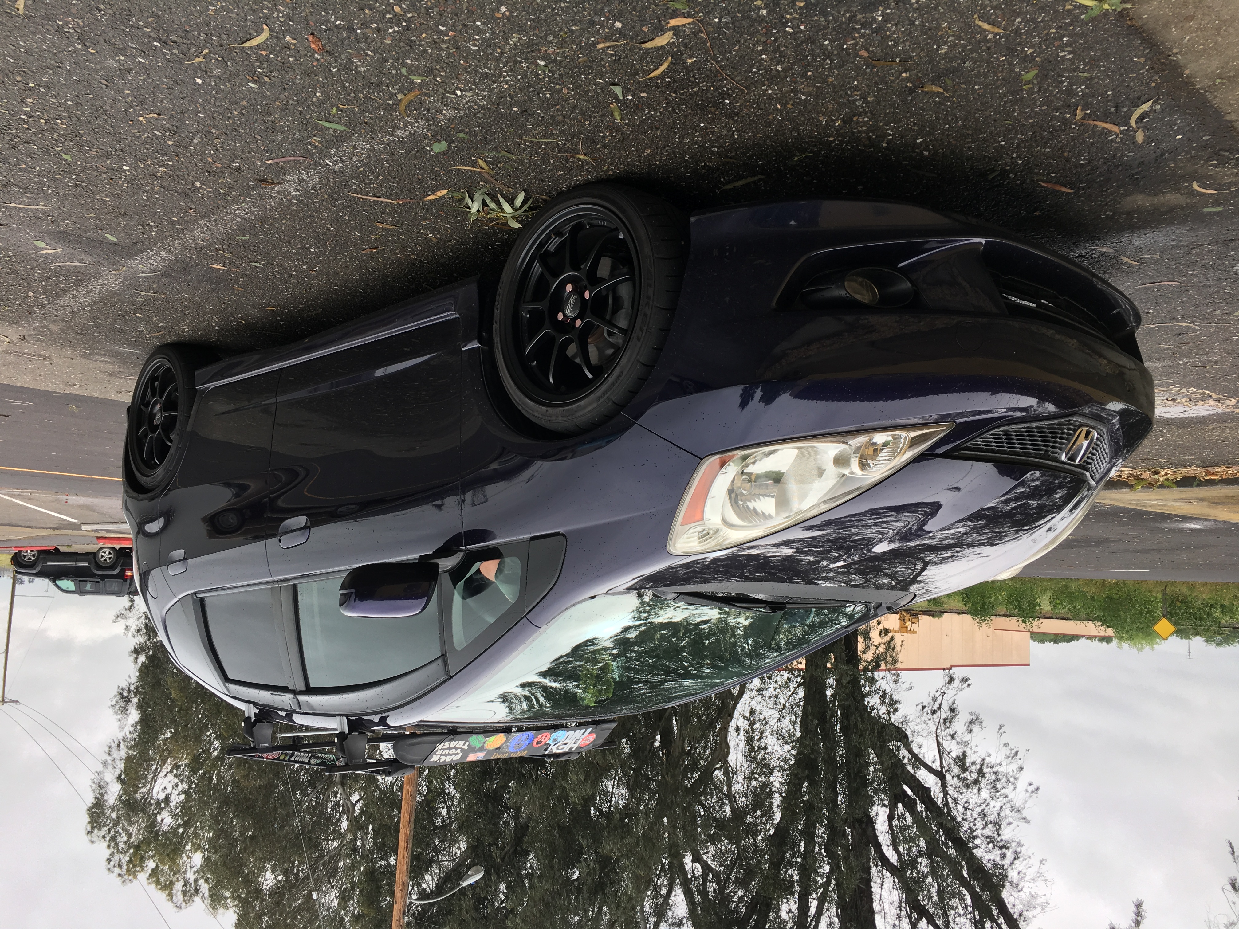

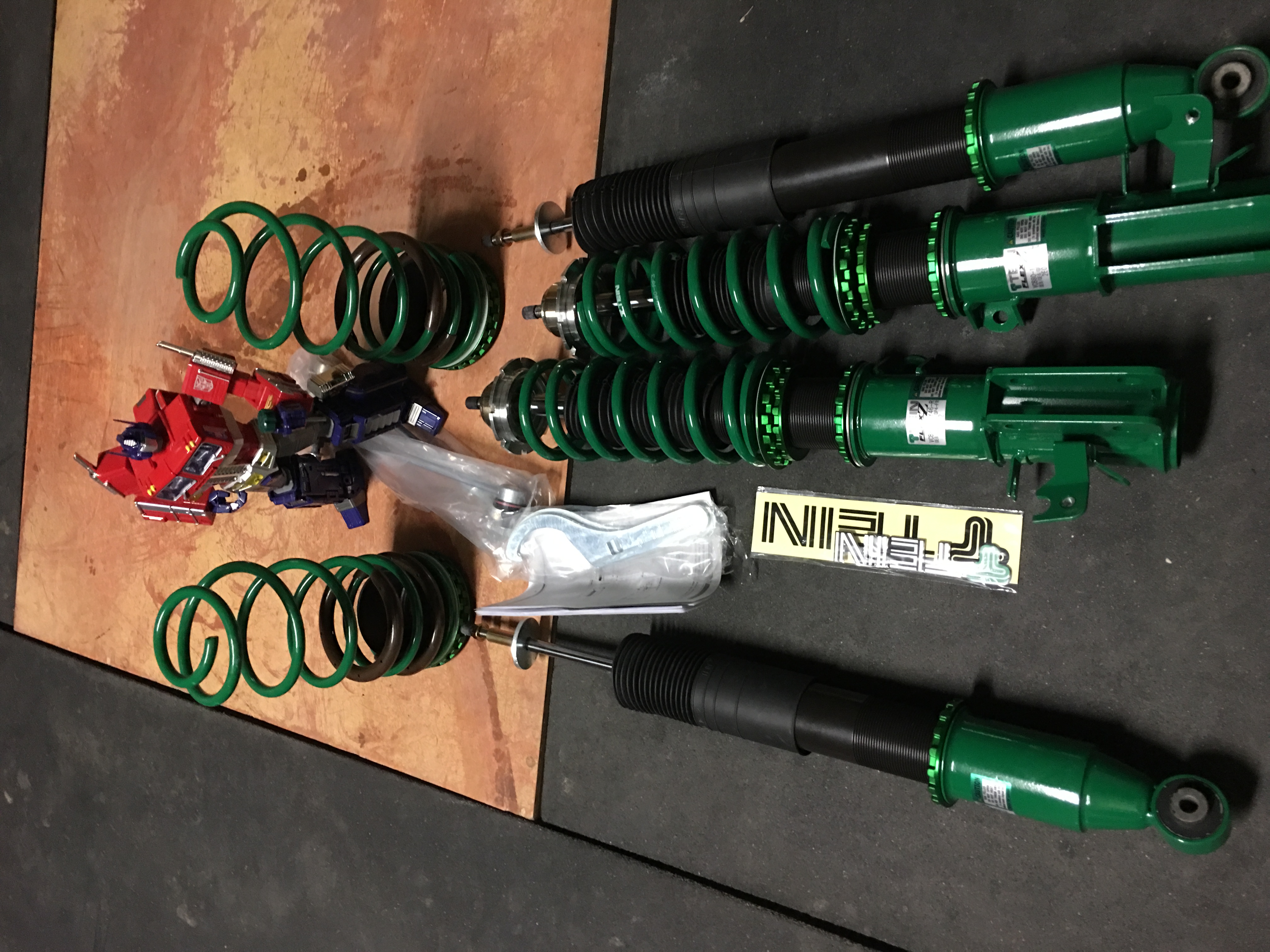

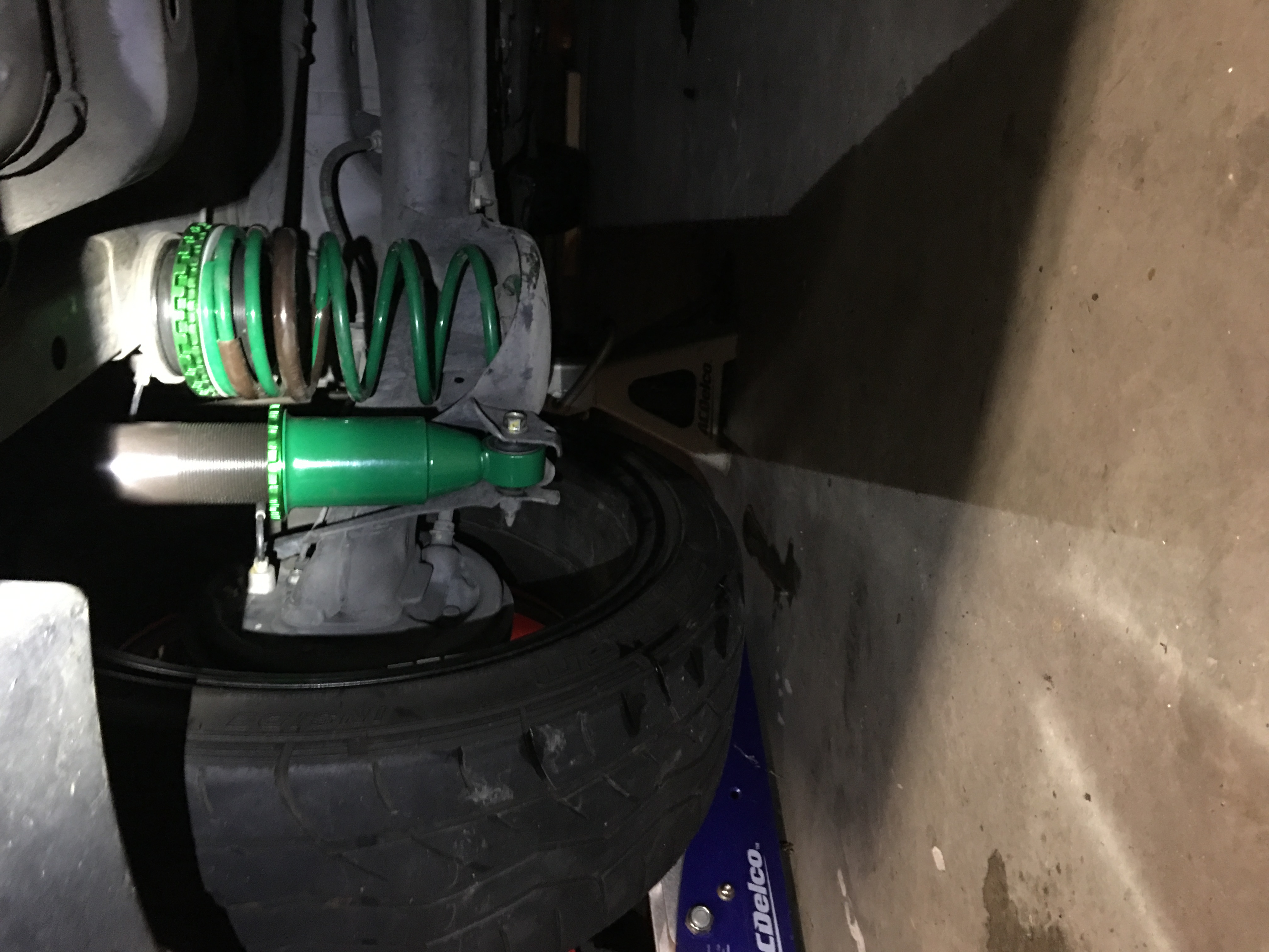

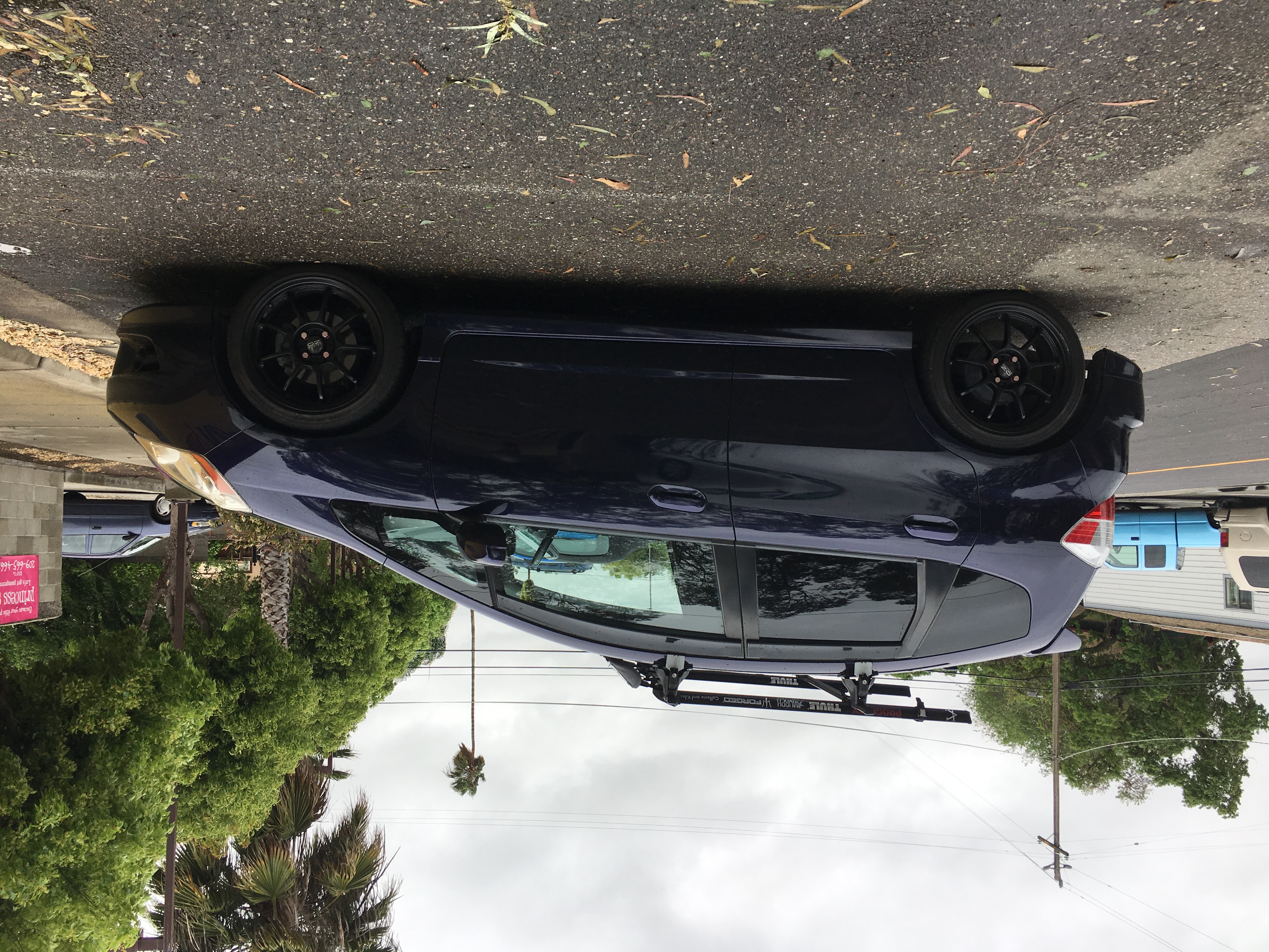

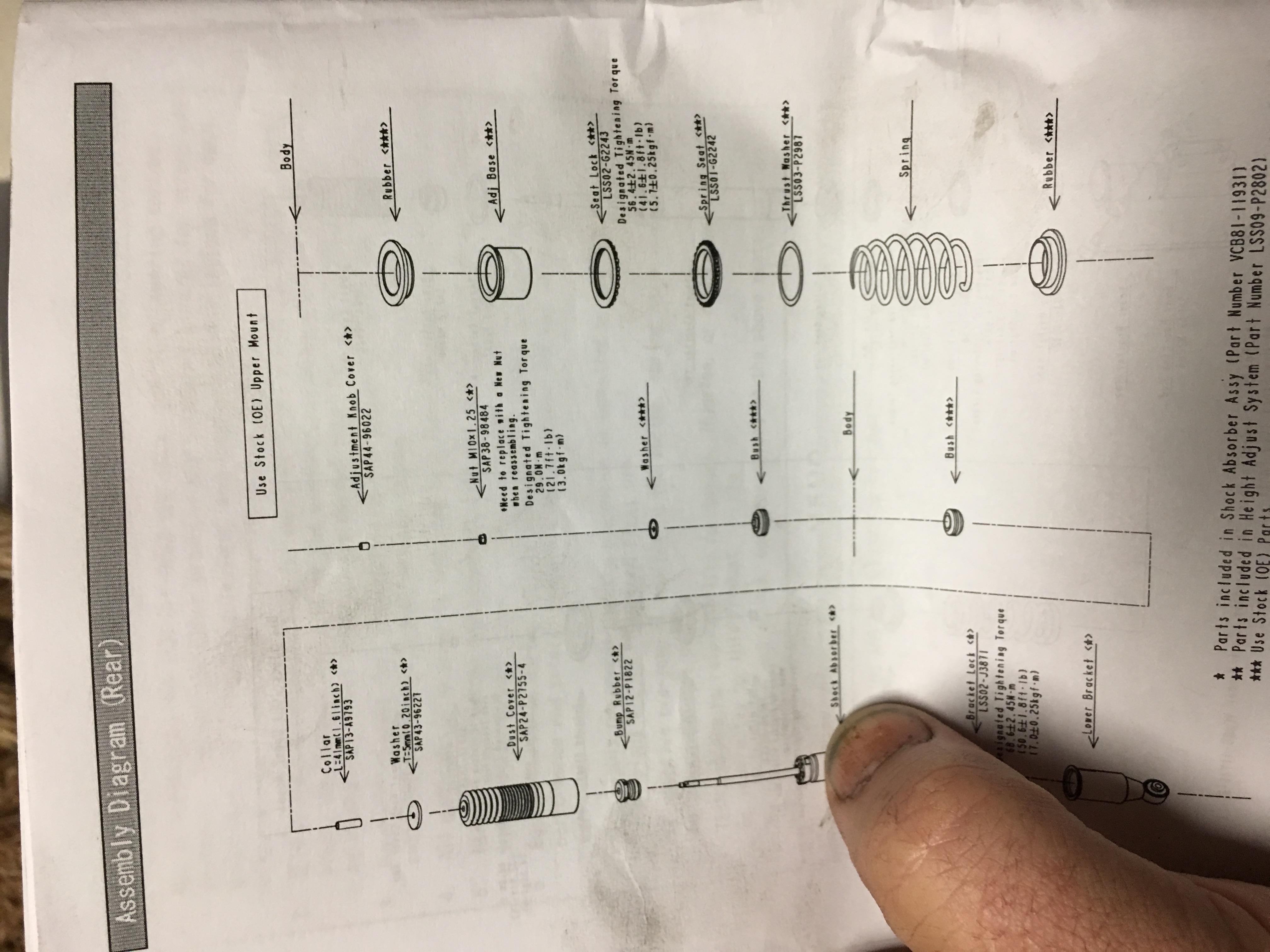

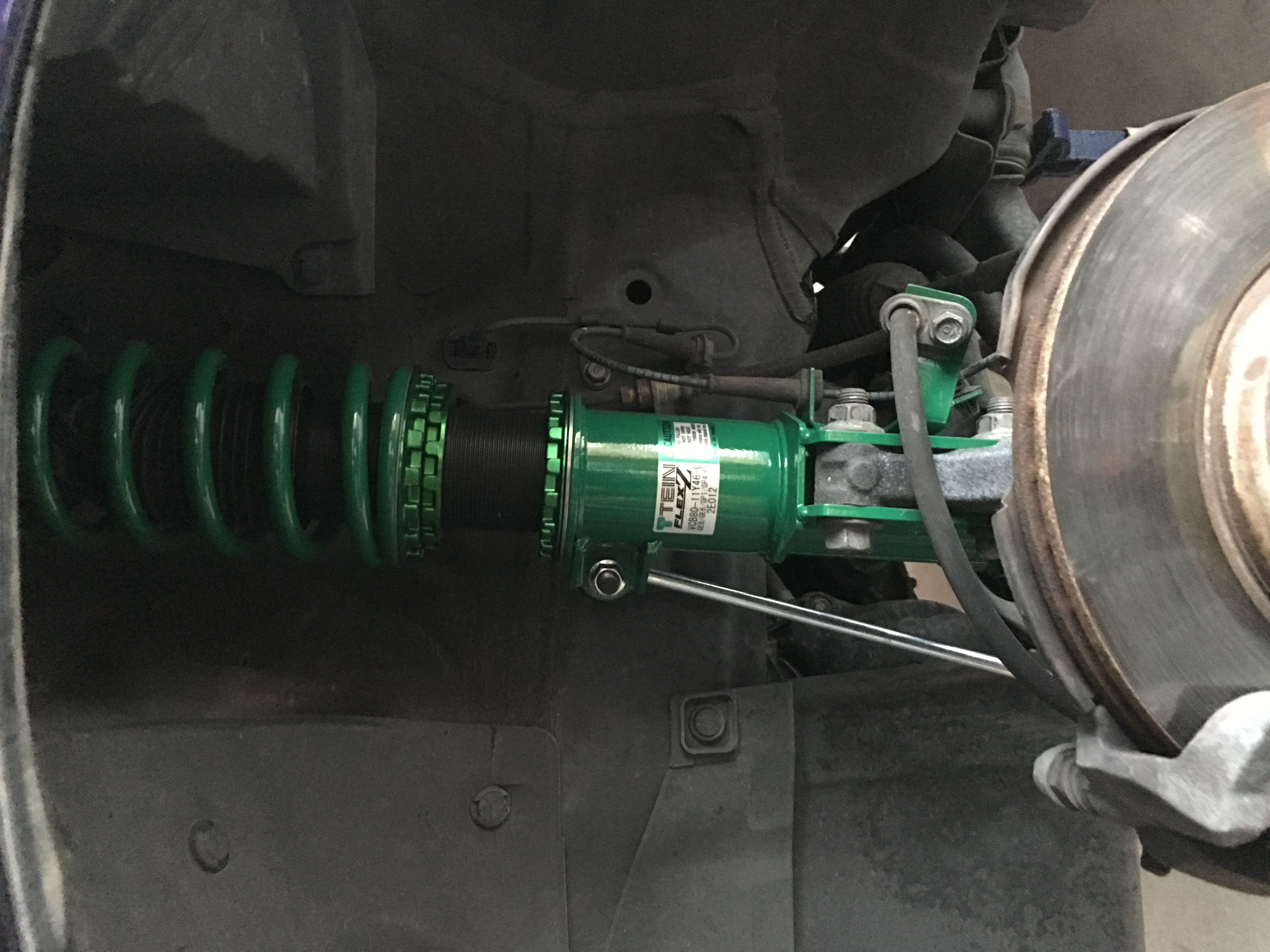

My Flex Z's came in today so, I went to work on the car. It started to rain pretty good over here. I only installed the kit and did a quick test drive. I had to help put my son to sleep. It took longer than usual because I lined up the plastic garnish that cover half the engine bay. Then it rained some more, haha! Basically pointless.
I included a pick of the rear instructions. People on Facebook thought I put the rear springs upside down. As you can see, I did not.
Attached Thumbnails What did you do to your GE fit today?-img_0905.jpg   What did you do to your GE fit today?-img_0906.jpg   What did you do to your GE fit today?-img_0907.jpg   What did you do to your GE fit today?-img_0910.jpg

Parts look good. Awesome that the fronts are preassembled. Did you just have to reuse the top OEM bushing? Or did you still have to disassemble the OEM suspension to get the washer bearing and washer bearing nut?
As for the rear I have seen it done both ways. The way you have it, and the opposite way. I guess it just depends on the manufacturer.
I mean at least your instructions tell you. The instructions provided with the BC-racings I got just tell you how to adjust ride height. And there is a sticker that says the spring perch goes on the bottom of the spring.
Here are some pics of the coilovers. I took more, but will start a thread specific to the install and coilovers.
How long did your install take? I'd imagine it'd take about two hours for a drop in replacement. Jack rear up, support it, remove rear suspension...install rear suspension. Jack front up, support it, remove front suspension (think I have a hex long enough to not have to remove the cowl), install new suspension. Adjust to desired height.

I had to reuse the stock mounting bushings. Tein now provides English instructions! Thats a big plus!!
I would say It took me 3 1/2 hours to do front and rear. then I double checked the height measurements and rechecked them. LOL! I recommend to take off the cowl and windshield wiper motor. Its way faster then trying to work around it. Tein also recommended not to use an impact gun when tightening the strut nuts. I went slower than normal.

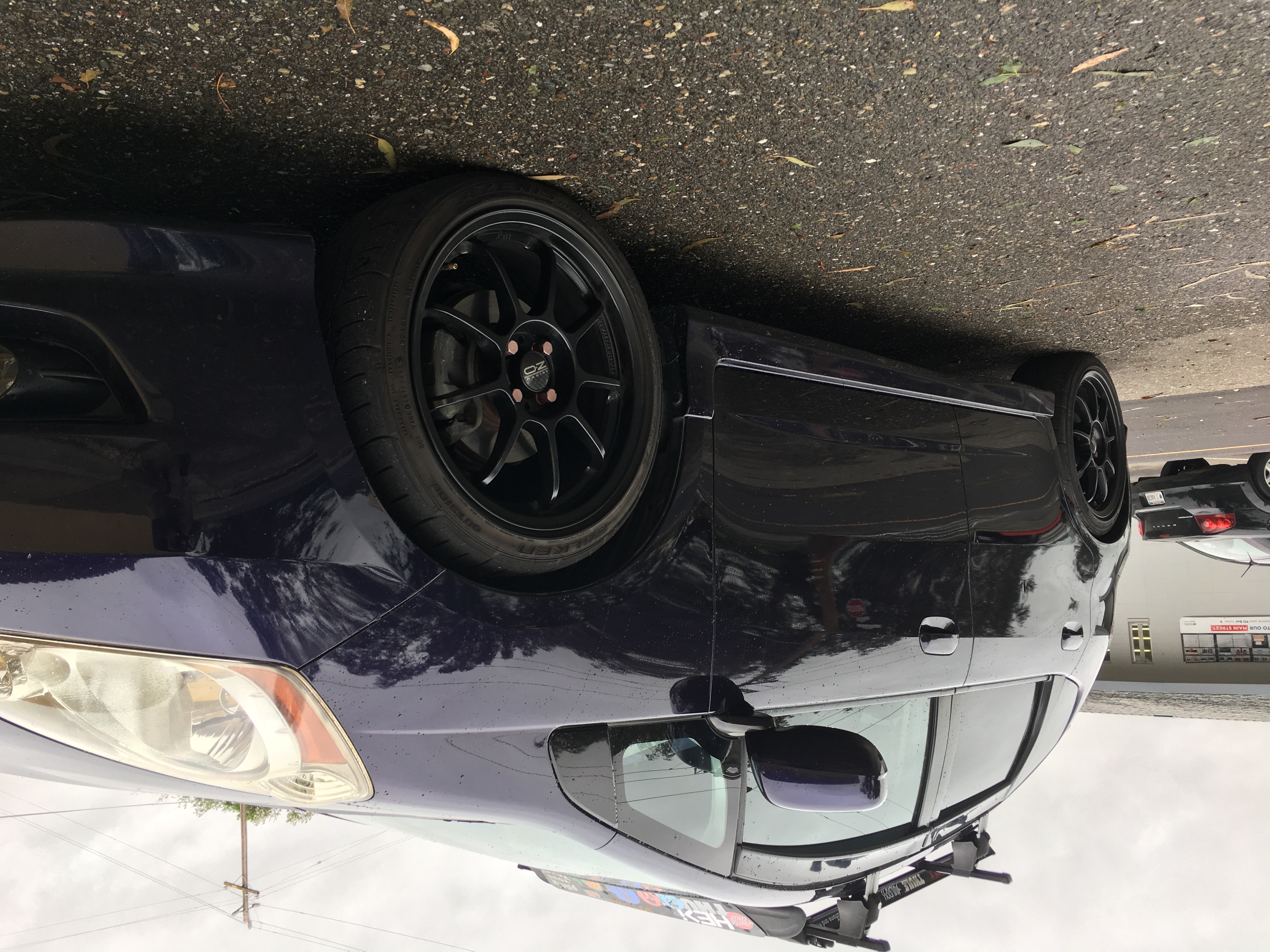

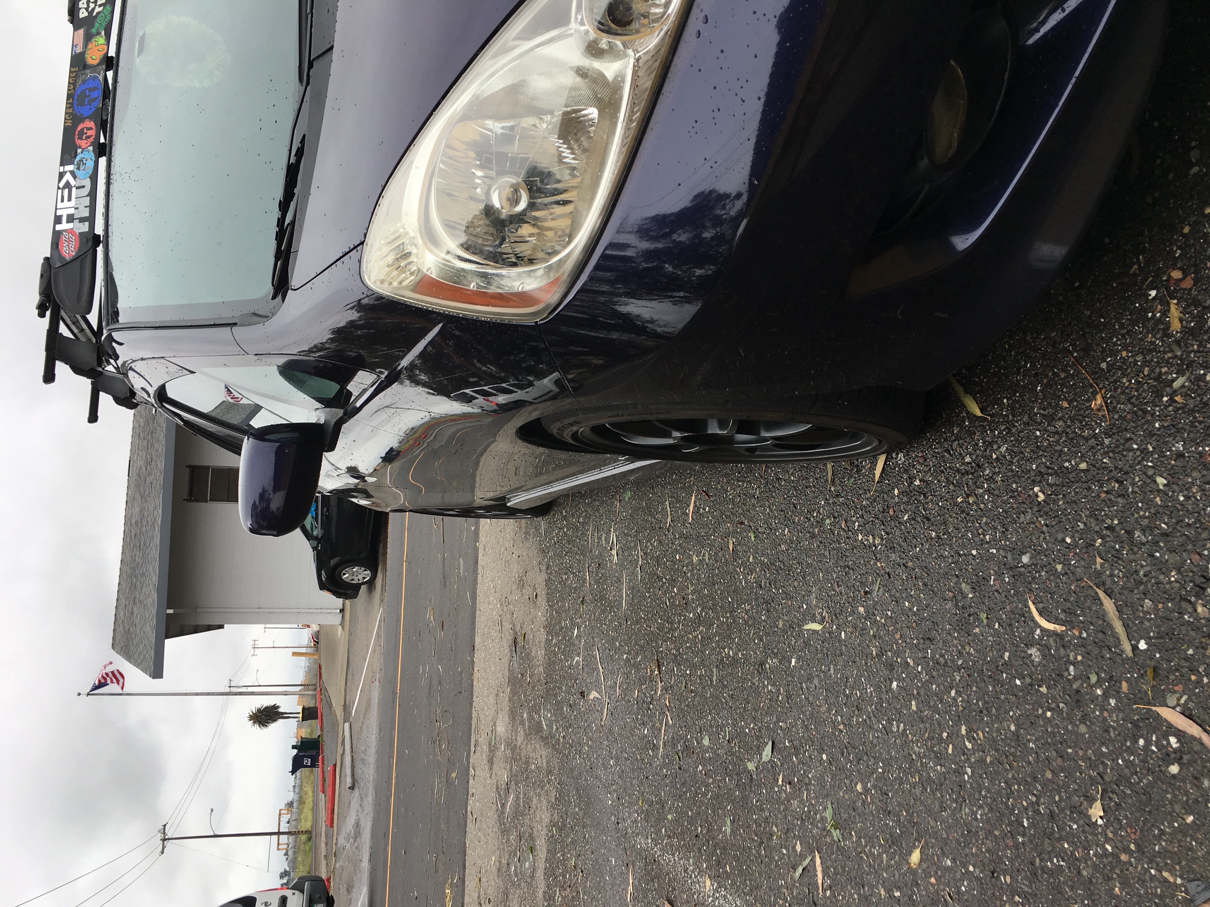

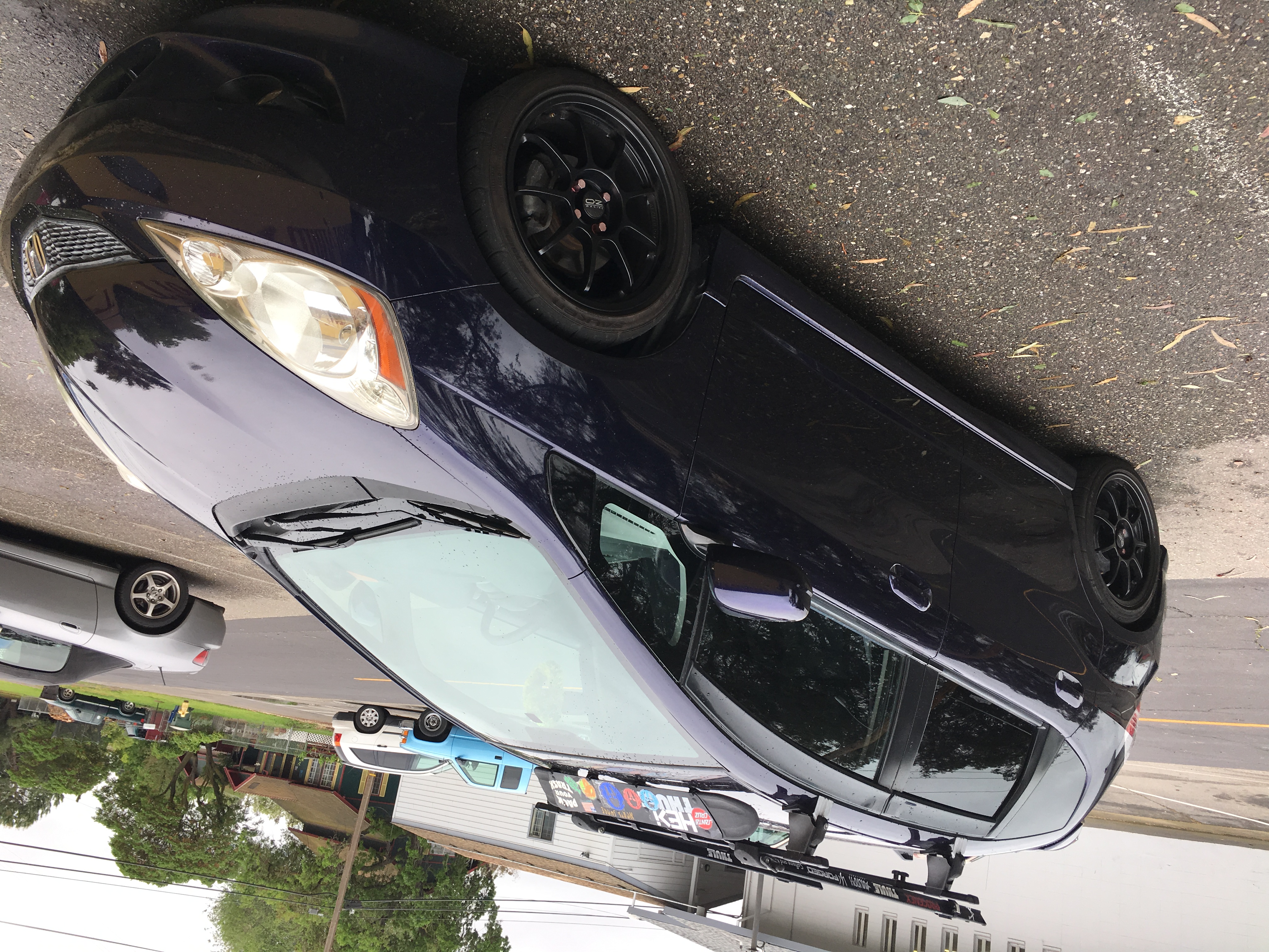

I was able to make a run to the post office today. The car feels like stock but stiffer. I's hard to explain. Only the Japanese companies know how to pull these delicate balances off. This is why I didn't want to go with a non Japanese company. Yes I know that the main strut is made in Taiwan but, the QC of a Japanese company is above reproach.
Needless to say, I am very happy! Now I just need a little alignment and it's good to go!
HKS drop in filter is next. And then I'll be waiting on my Cusco strut bars.
Attached Thumbnails What did you do to your GE fit today?-img_0912.jpg   What did you do to your GE fit today?-img_0914.jpg   What did you do to your GE fit today?-img_0917.jpg   What did you do to your GE fit today?-img_0916.jpg   What did you do to your GE fit today?-img_0913.jpg

Can someone tell me how to fix these pix? I have no idea why they get attached upside down.

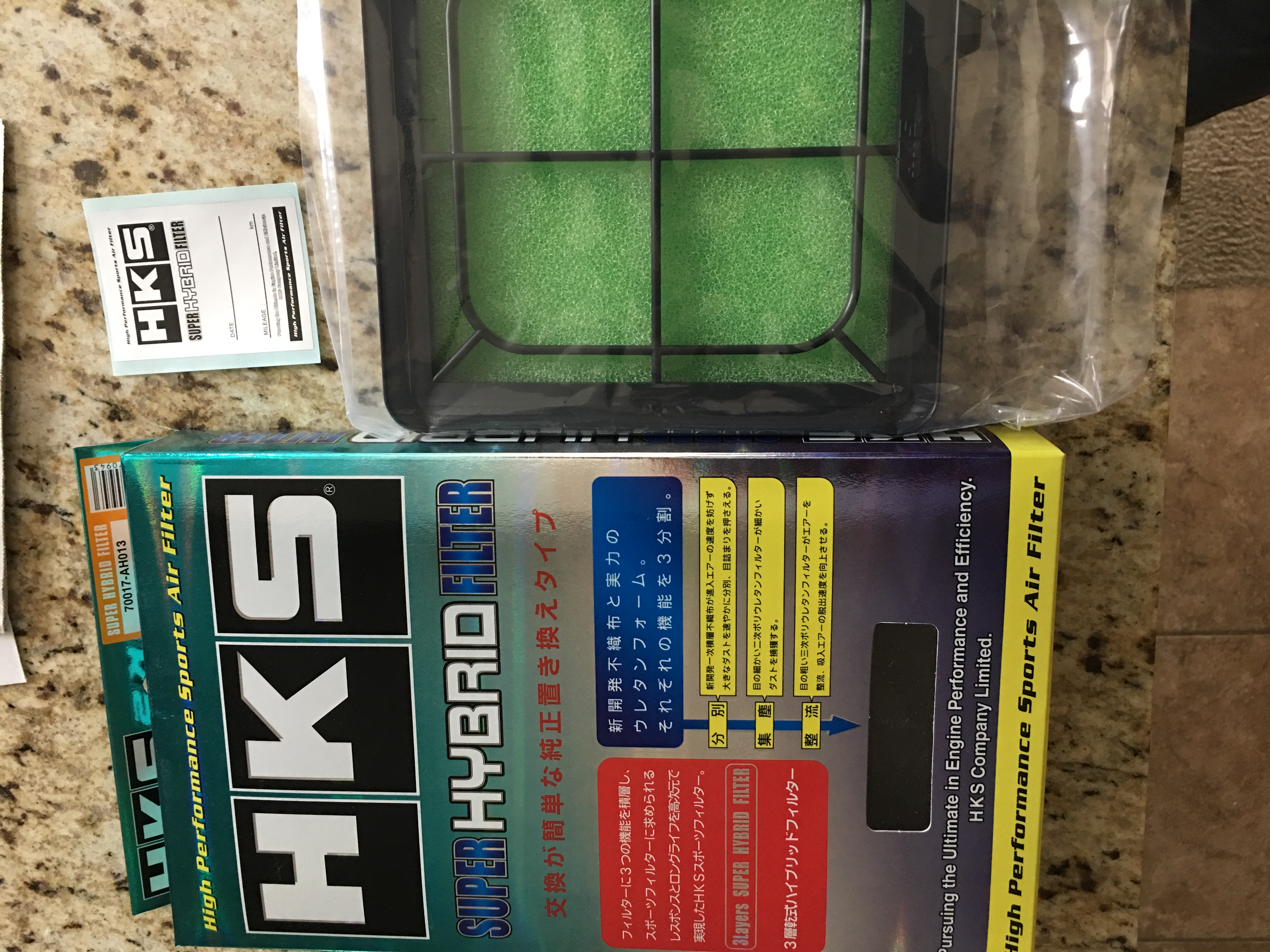

HKS filter came in.

You are better off hosting the images on a 3rd party web hosting site like Flickr or Imgur. I use Imgur and like it.
You then use the [img] tags to post the link at it will show up.
I don't recommend using the forum image hosting as its a little wonky.
