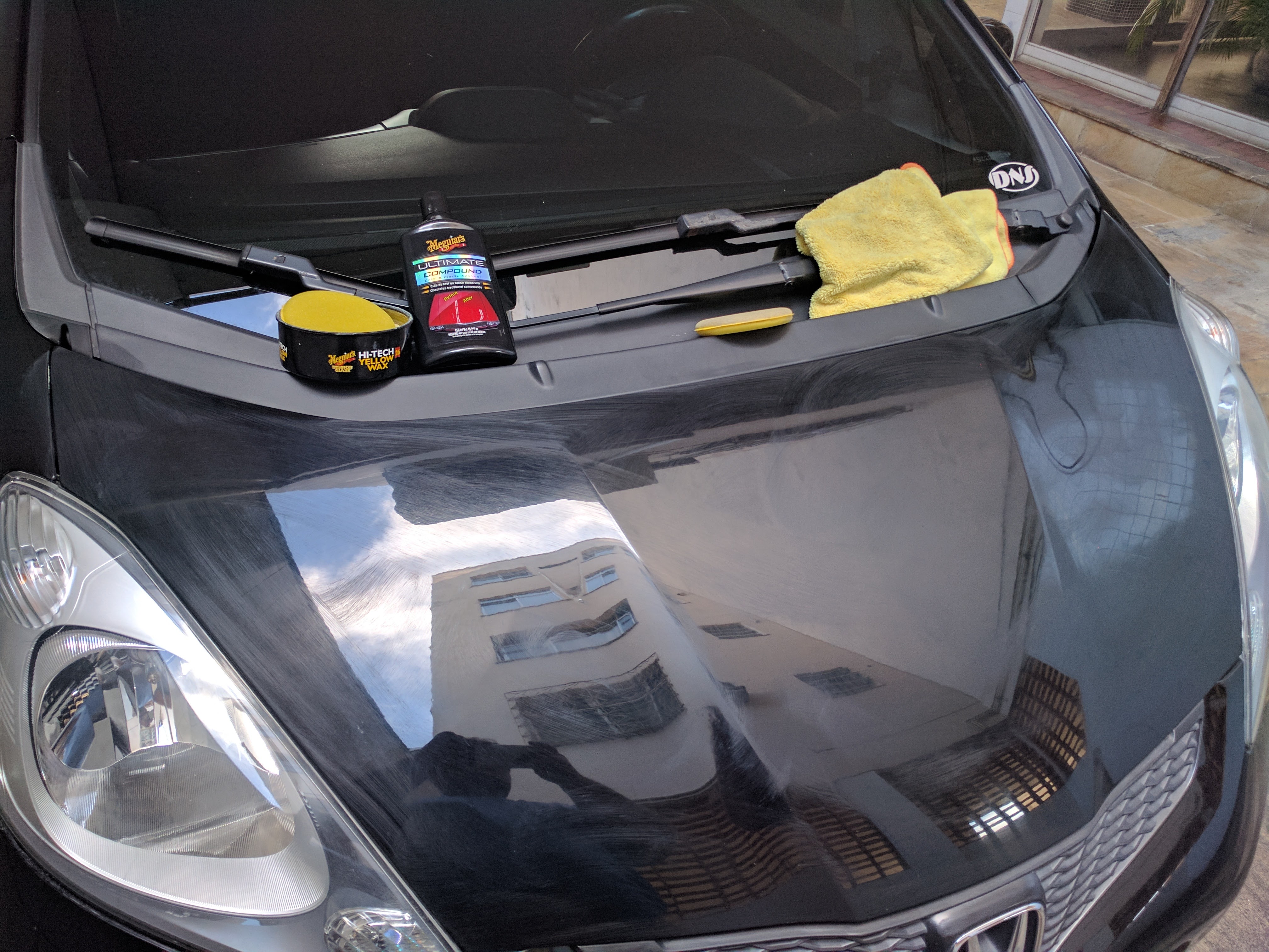

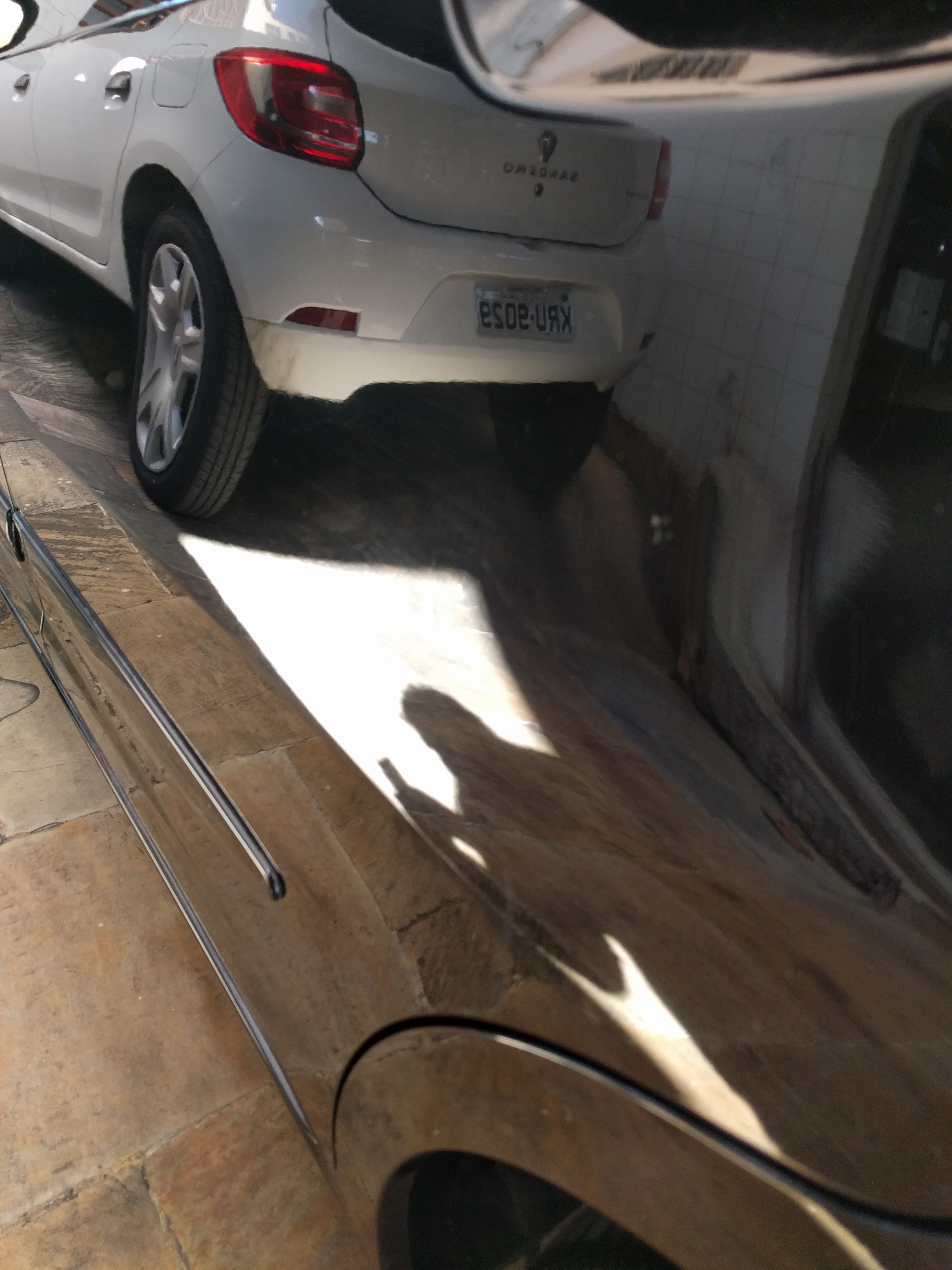

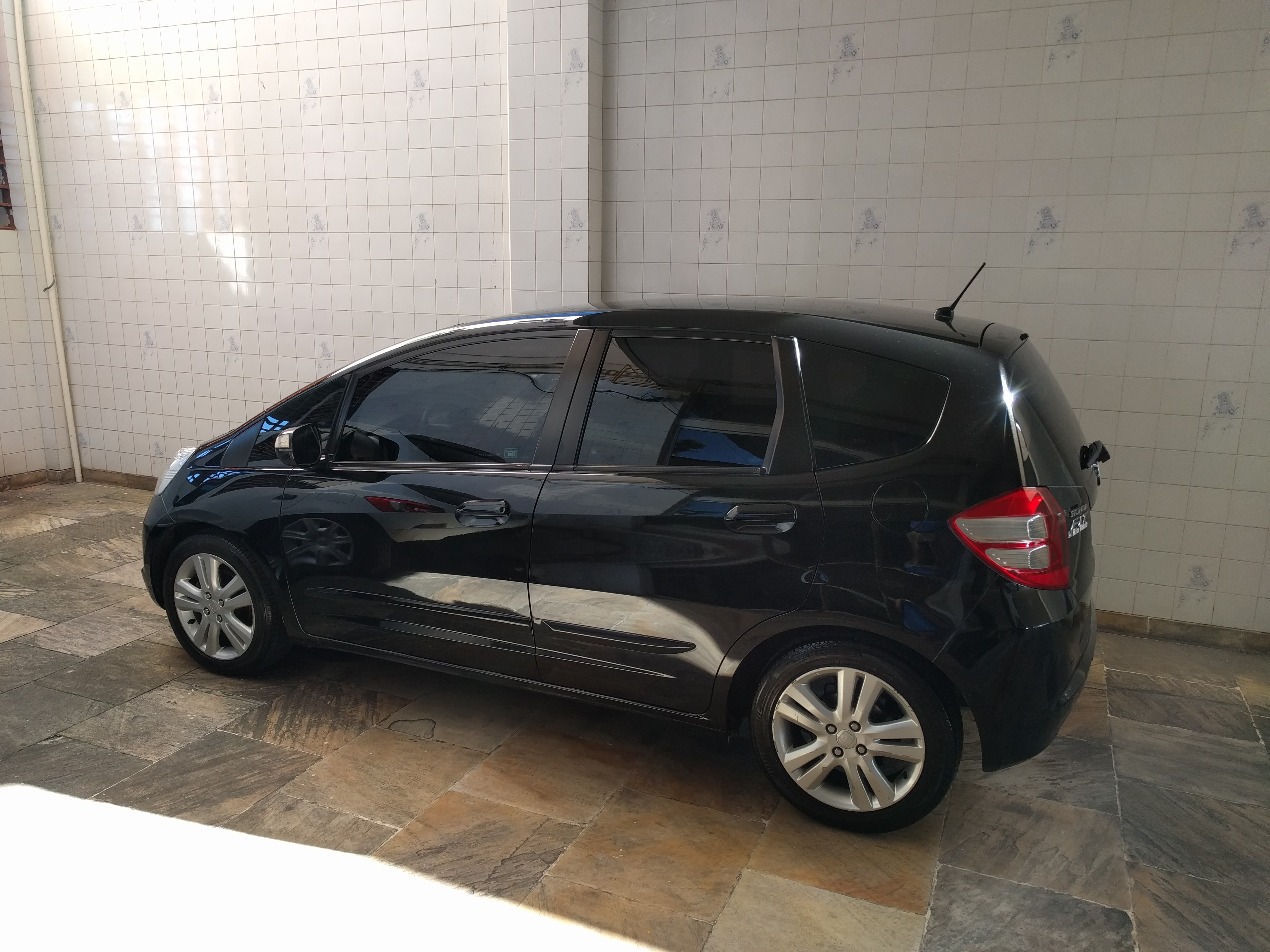

Compound + Carnaúba Wax
Attached Thumbnails What did you do to your GE fit today?-img_20170416_092722.jpg   What did you do to your GE fit today?-img_20170416_150556.jpg   What did you do to your GE fit today?-img_20170416_150540.jpg
Super clean! Nice mirror finish =)
