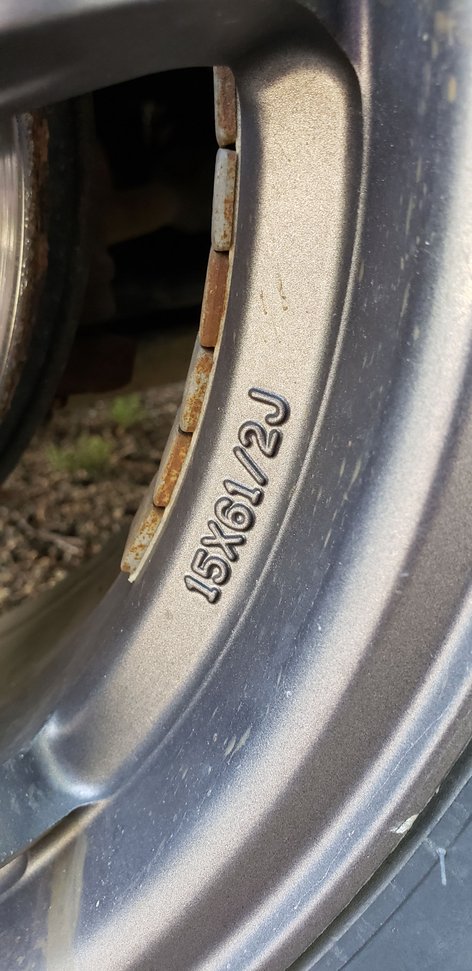

Hey everyone, just bought a 2010 manual earlier in the week and I'm hoping someone can help me identify these wheels; one was damaged so I'd like to complete the set. They're stamped 4x100 500kg and 15x61/2J. Offset is 38.

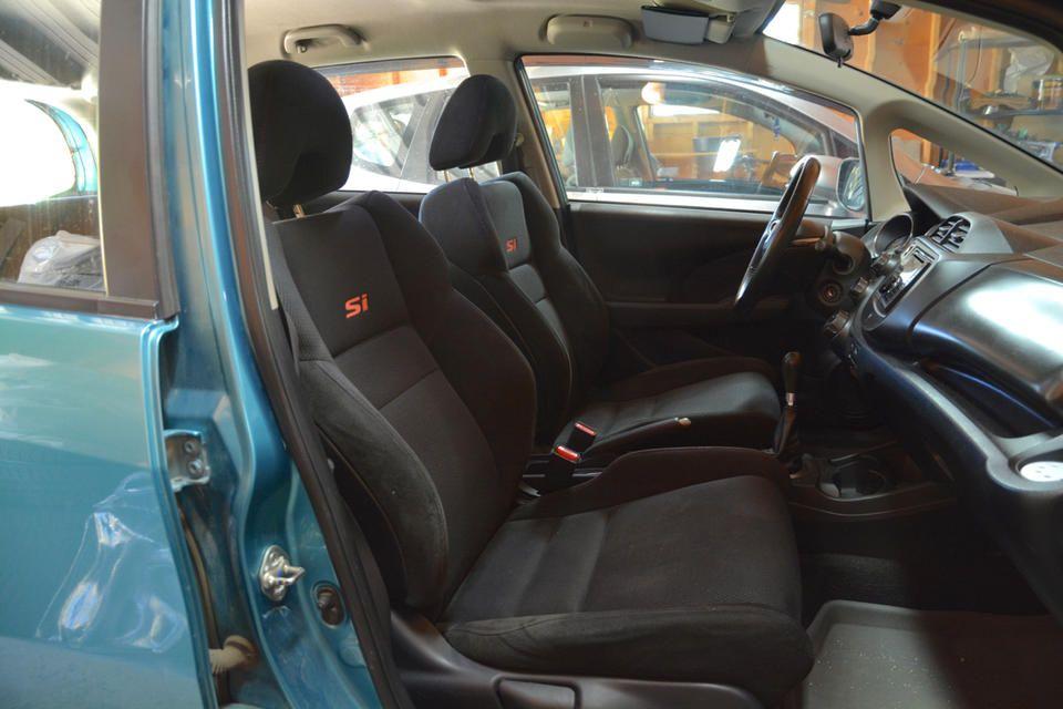

Originally Posted by CVG323
do you have a scanner that can check what code its throwing out?
FYI the airbags still work, its just complaining something is wrong
also, pics of setas installed?
Just as a heads up, as far as I know when that airbag light is on, the passenger side will not deploy. I am running 08 Si seats in my 13, swapped the driver side position sensor over, and the control unit. Airbag light is on, and I thought it was just needing to be recalibrated. Took it to the dealer and the system is not communicating at all. No airbag deployment as a result.
I need to acquire a '13 seat (not a 09-11) and take the weight sensors out, and the ODS. I'm not sure about the side airbags.

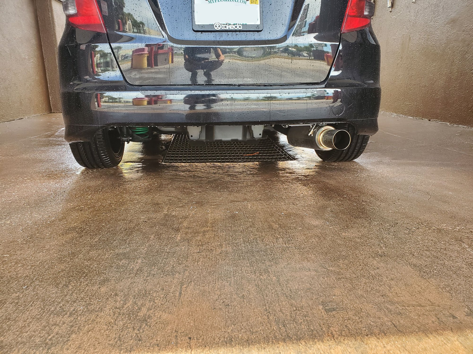

Cut out the diffuser portion of the bumper the other day, removed my mud guards too. My diffuser was cracked in a way that couldn't be fixed, and I didn't feel like spending hundreds on a new bumper or aftermarket diffuser/lip to cover it up. Looks like I'm gonna have to clay bar where the mud guards were, maybe compound and polish as well

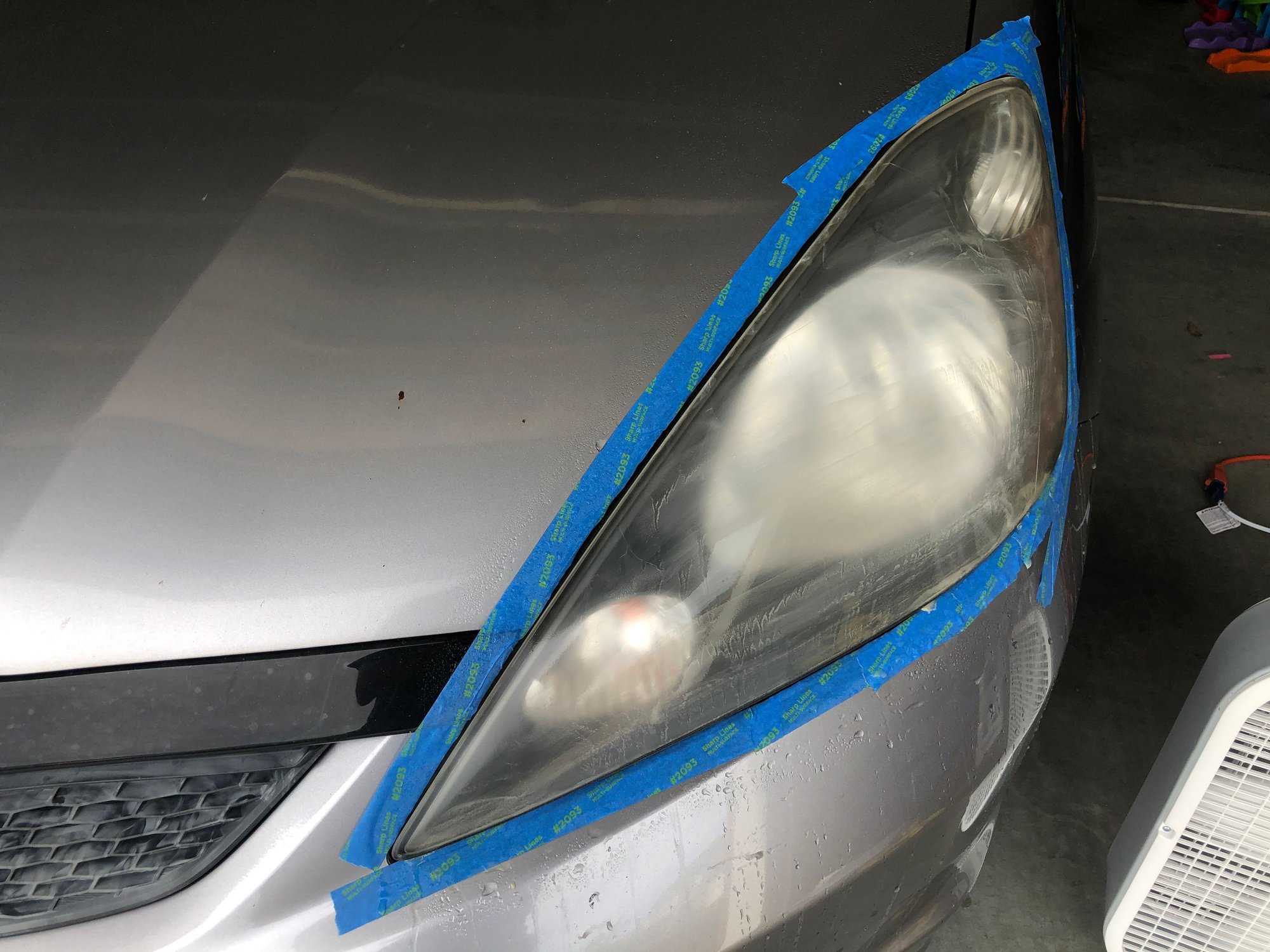

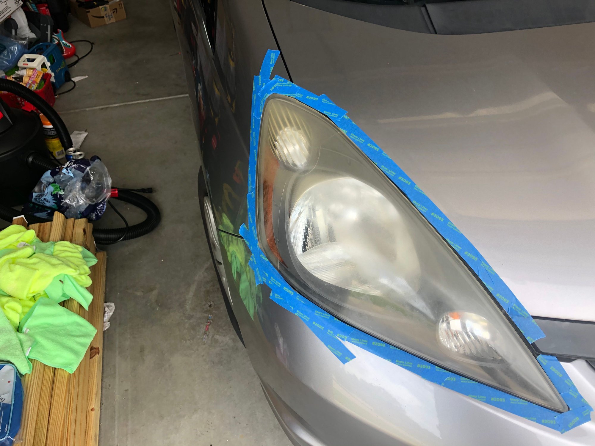

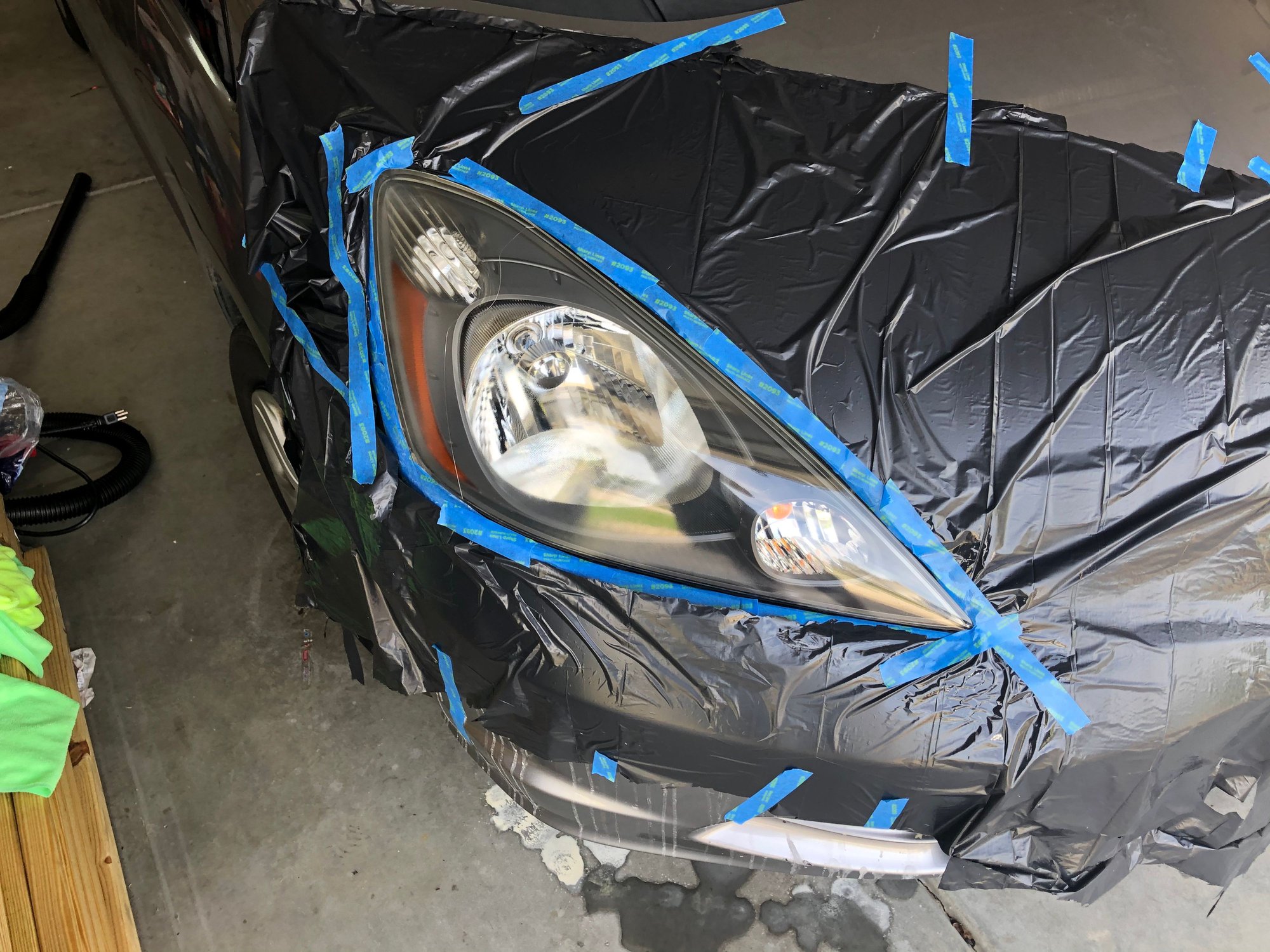

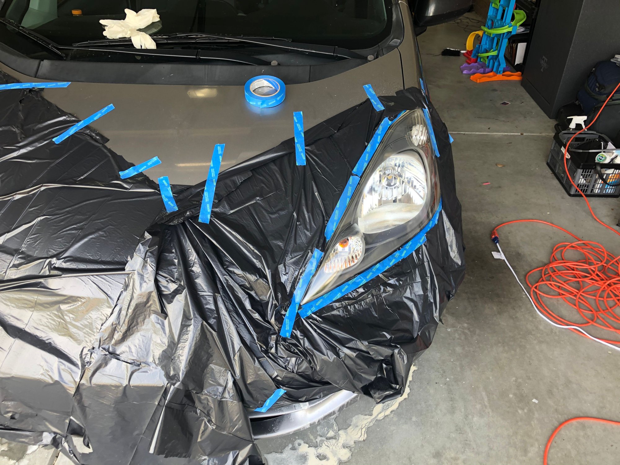

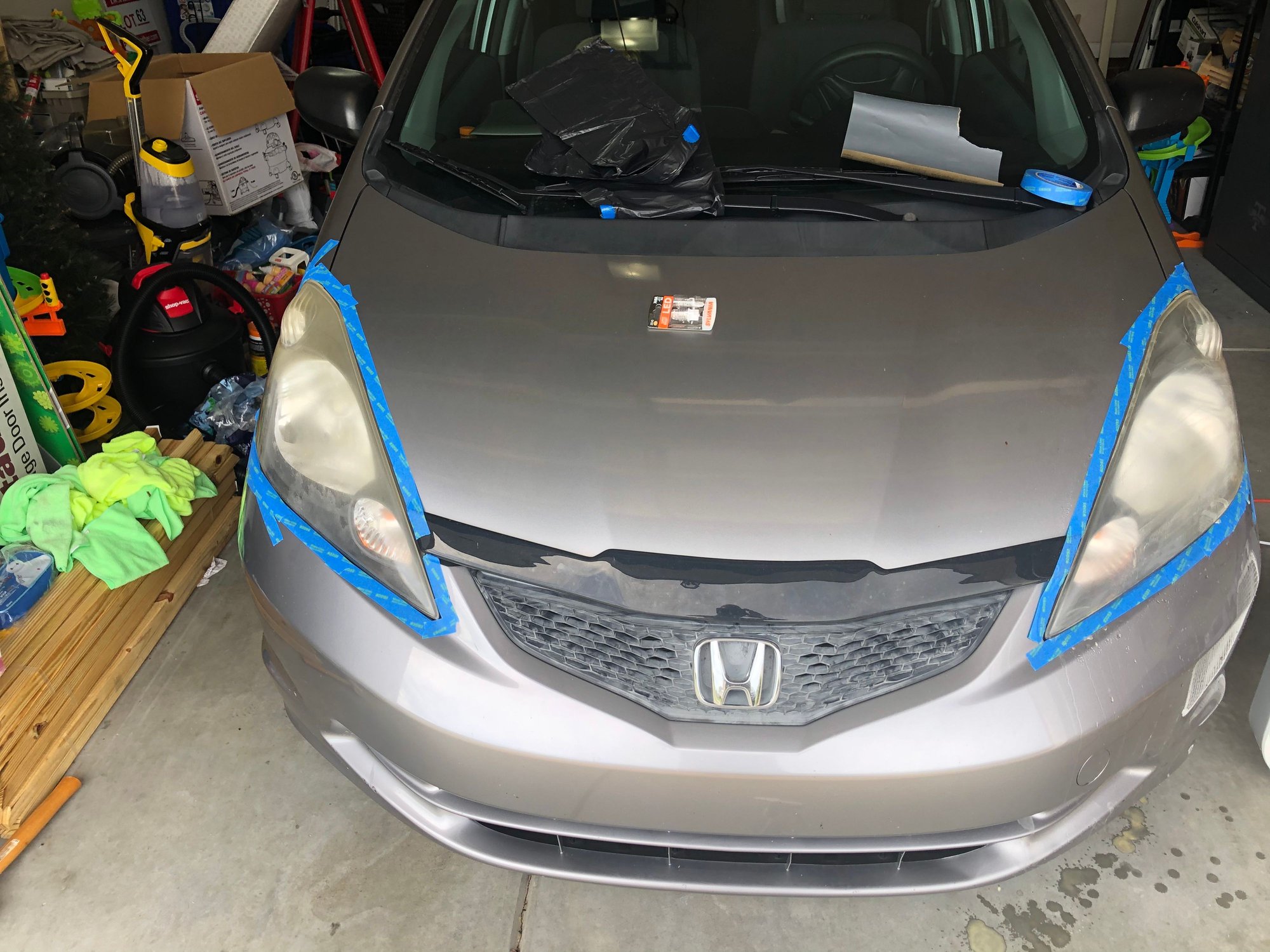

I finished replacing all the lights with LEDs and restored my headlights. Looking at replacing the brake pads and rotors, any suggestions?

What did you use to restore the lights?

several types of sandpaper and three coats of clear coat. I followed the instructions from a YouTube video. Worked great. I’d highly suggest letting the clear coat dry a full 24hours. I was anxious and only let it dry for 18hours and had issues when I did the final sanding and waxing, mainly with some minor streaking. Still a huge improvement and is supposed to last longer than those restoration kits you can buy. I think I maybe spent like $30-$40 for everything. Make sure your hood and windshield is covered when applying the clear coat to prevent and overspray
here is a link to the video:

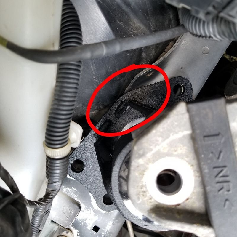

Innovative Motor Mounts
So, I decided to get these in 75 durometer despite reports being generally bad. In short, the right side mount fouls the chassis and requires clearancing. My ex kept her grinder despite never using it so I was forced to use a dull hacksaw blade. Once it sat properly on the frame, it was misaligned a good deal. Throwing everything together loose then tightening things down made it easy enough. The center isolator bolt is also a smidge short. Also an annoyance. The rest of the mounts installed easily and without drama.
The car feels very racecar like at idle. It vibrates through the seat and steering wheel and the engine reverberates and resonates throughout the cabin. The car immediately feels more solid, as you can no longer feel the engine leaping about at startup. It feels like the engine is an integral part of the chassis instead of dead weight bouncing about. The car is much smoother on acceleration and deceleration and actually cruises down the highway much as normal. Under 3K rpm the engine booms throughout the cabin and also under load up to 4K RPM. Cruising at 3K and under is rather unpleasant noise wise. If you love hearing your exhaust and amplified engine sounds you'll be just fine. Loose items in the glovebox or in the plastic pockets and storage areas will buzz at various RPMs.
Minus:
• Increased noise at low RPM/under load
• Loose items will vibrate noisily at various RPMs
• High vibration and noise at idle
• Right side mount needs notched for fitment
Plus:
• Connected feeling engine
• No wheel hop/engine monkey motion under acceleration/deceleration
• Shifts effortlessly and easily under high load conditions
Fouls chassis here
Misaligned once fixed
Bolt just a smidge short

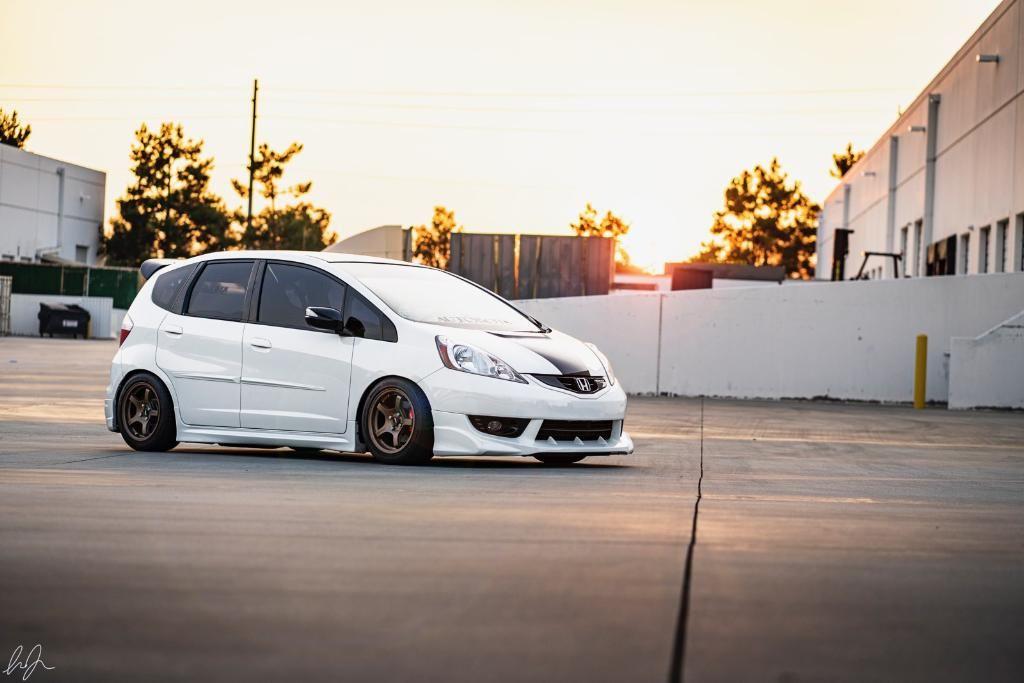

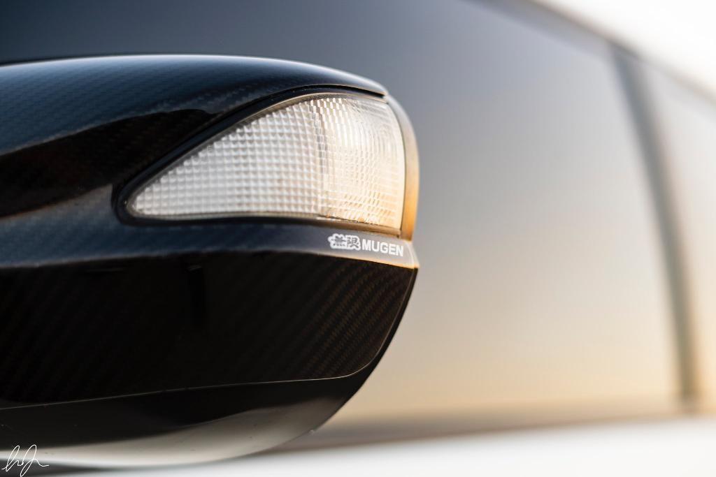

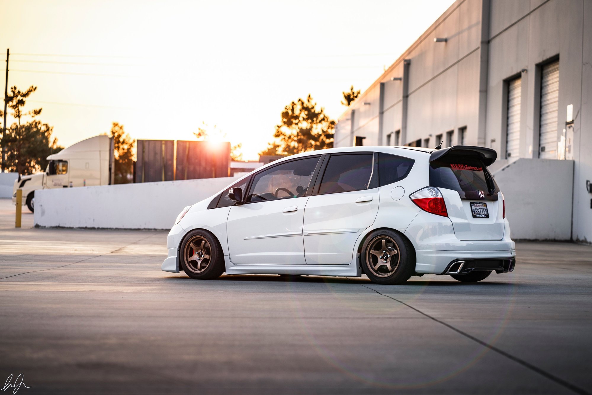

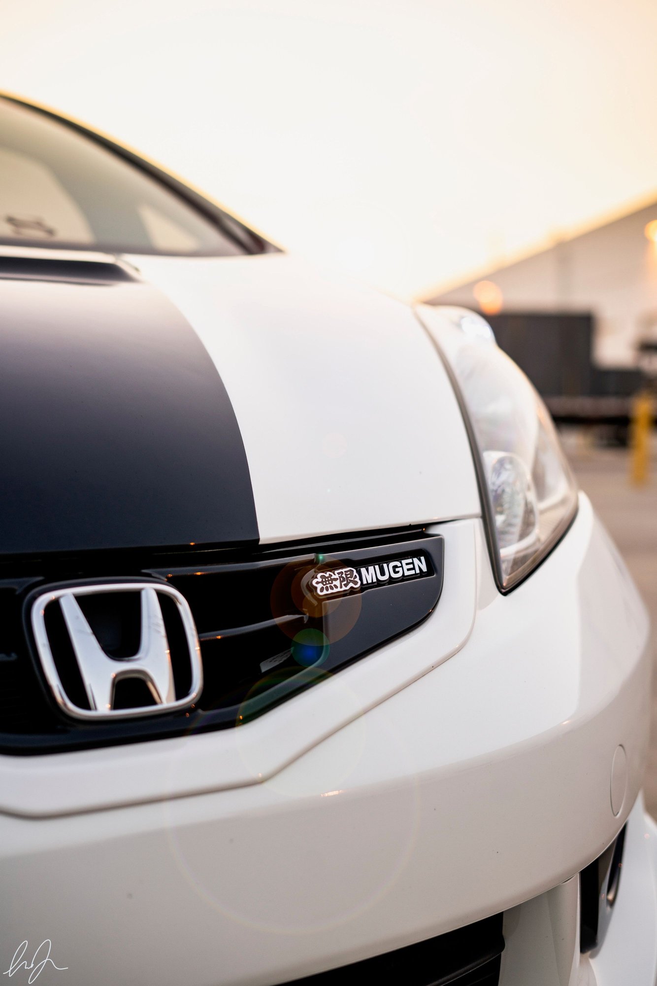

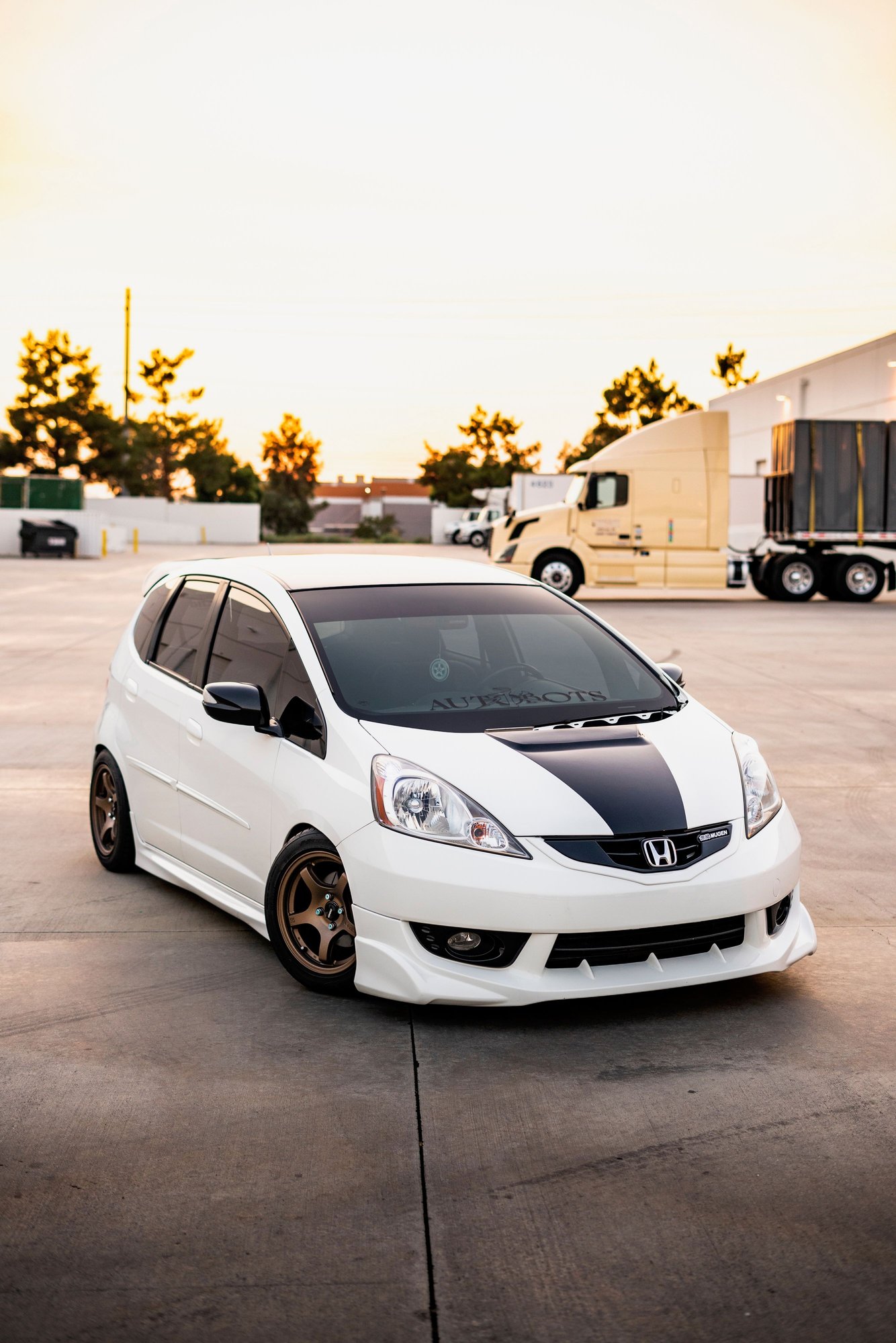

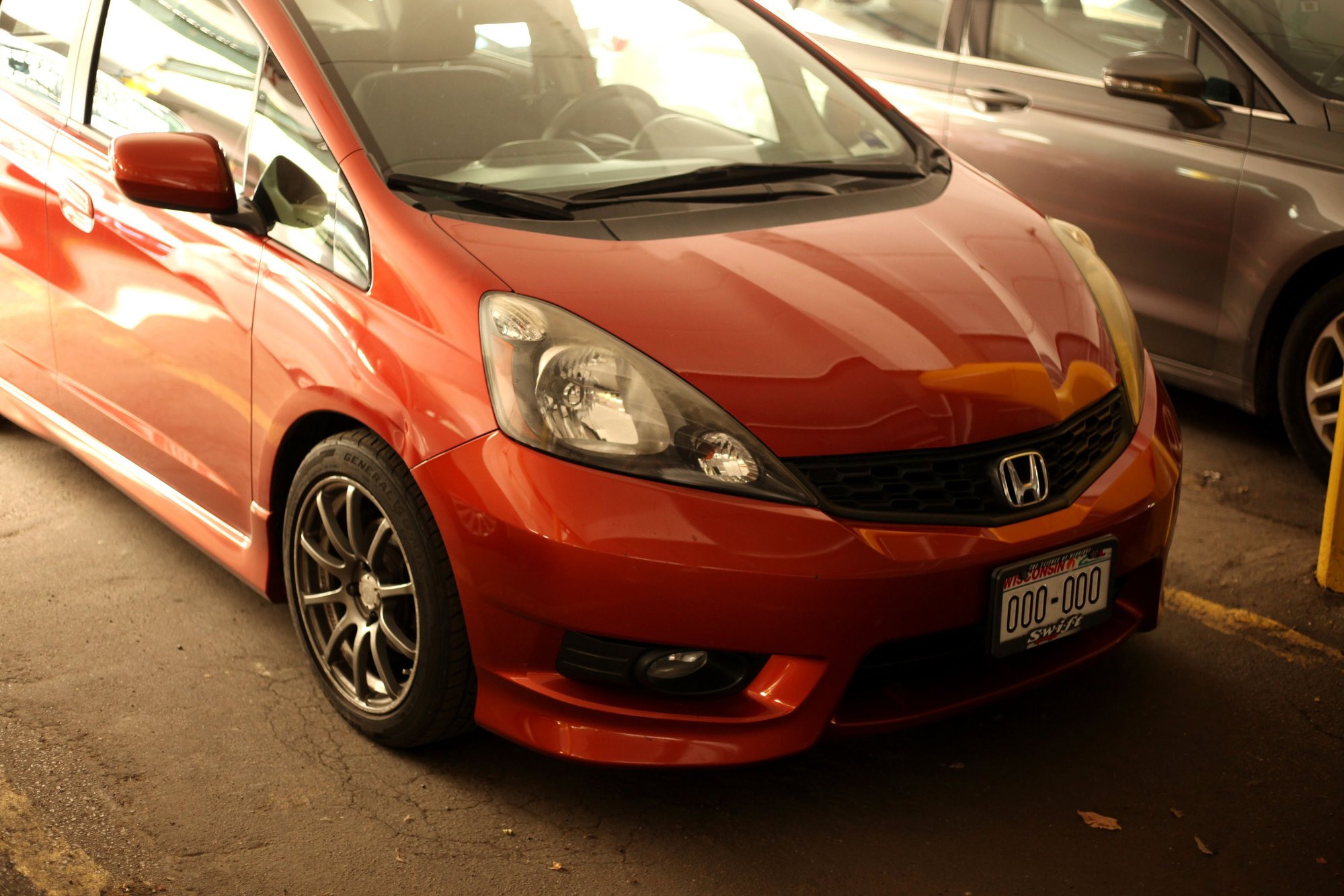

Finally after so many years got some decent pics of the Fit thanks to my friend Izzy.

Nice!
