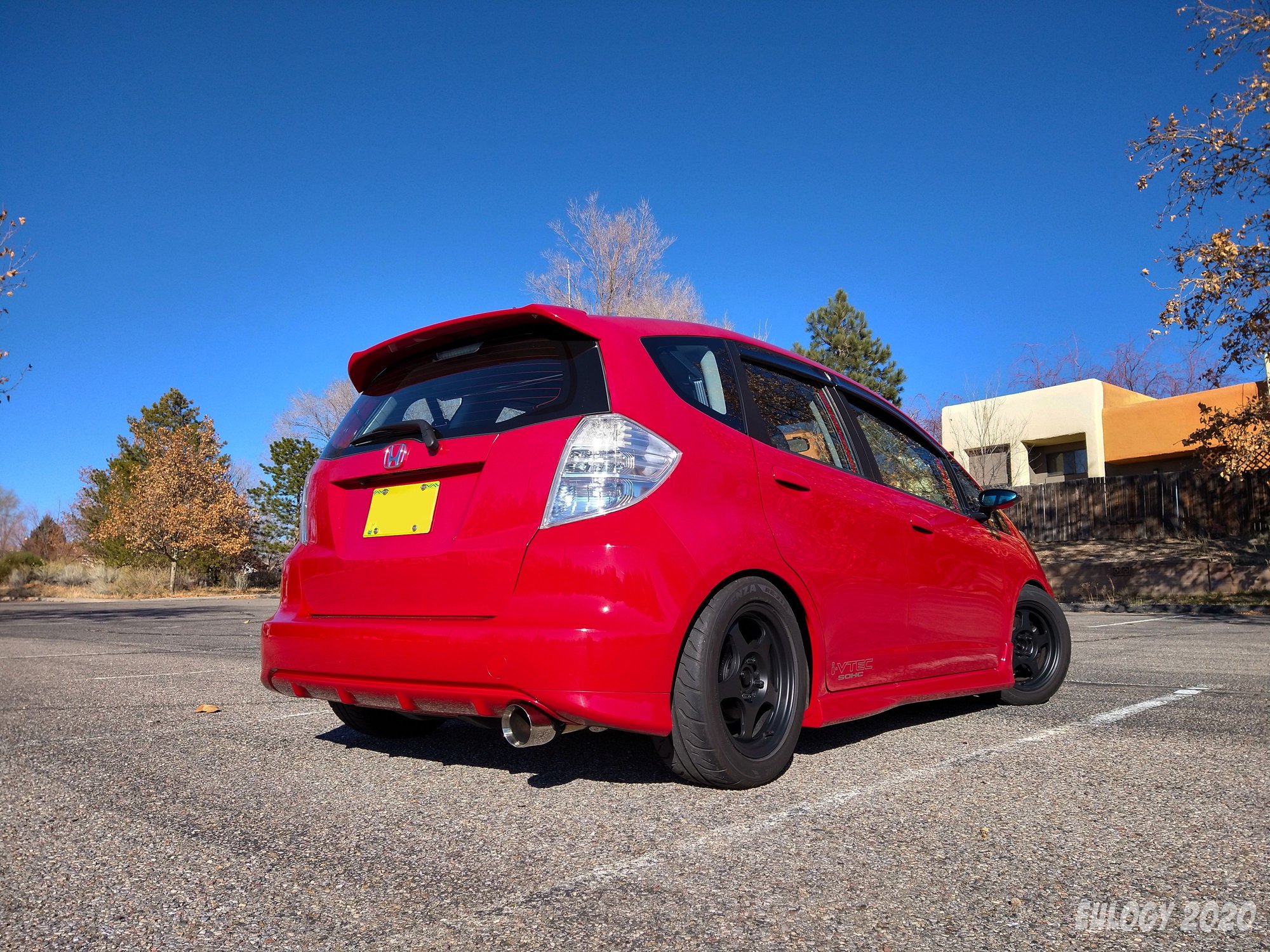

someone got a bath.

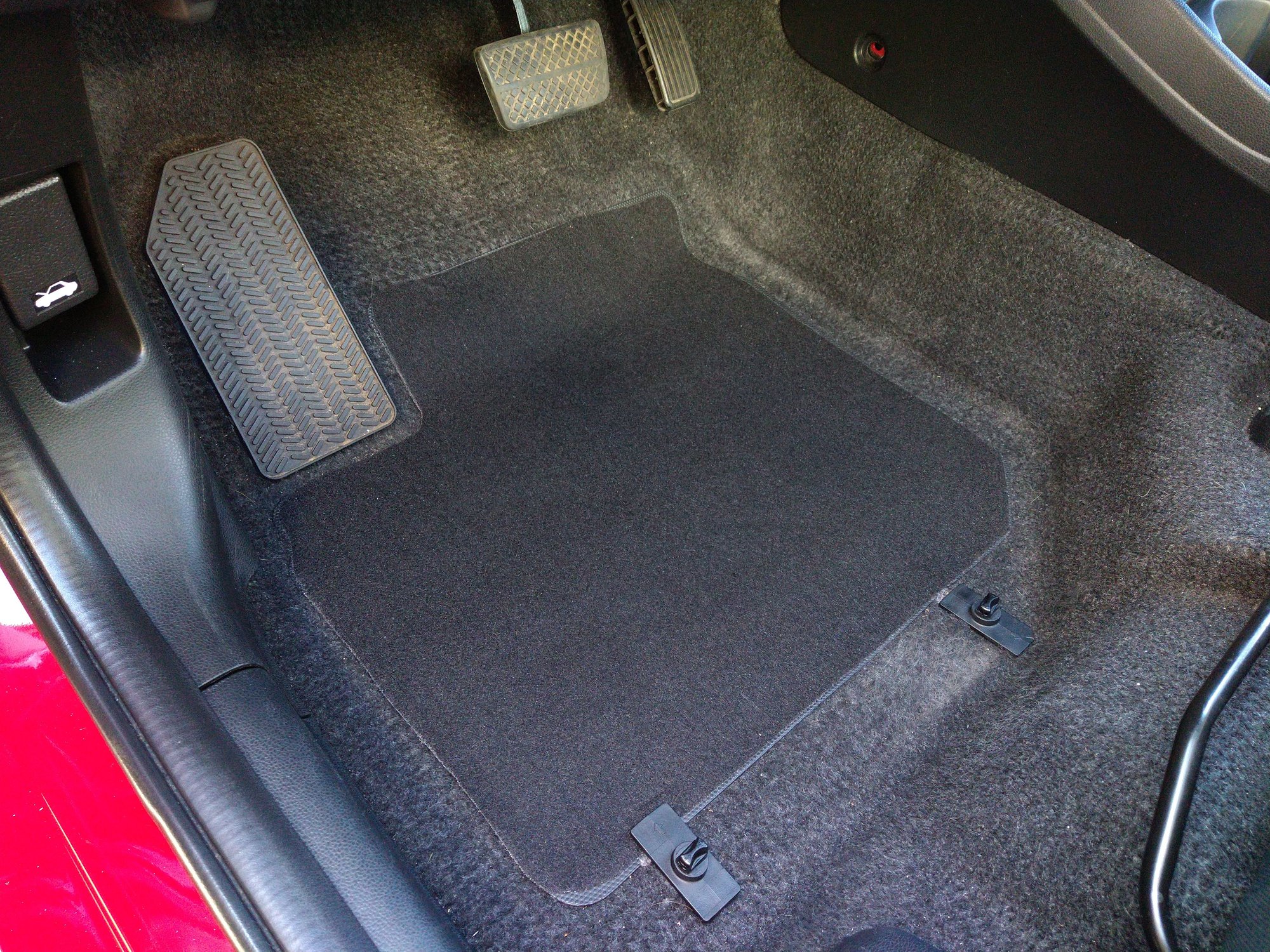

Glued some speaker carpet to my stock plastic floor mat thing in an effort to provide some traction for my new OEM floor mats spikes.
Doesnt fit perfect...but didnt try to get it to either. Highly recommend this mod if youre tired of your drivers side floor mat slipping around.

100% gonna do this for mine. I was thinking that non-slip material for kitchen drawers, but this looks neater. Still plenty tacky to help the mats from slipping?

its not super duper velcro grippy...but its a bit more grippy than the stock carpet when rubbing the floormat spikes across both. the thin carpet they used in these cars is weird and cheap. the carpet in my old scion xa was a lot more plush, and had better working and simpler floormat clips. they would just pop into a gromet. anyways, back to the Fit, the speaker carpet is definitely way more secure than the slippery plastic crap it covered. Ill report back if i have any issues with shifting or it not sticking.
I used 3m spray adhesive btw. and to anyone that tries this...dont forget to wipe the plastic mat down good with some rubbing alcohol or something to clean it first.
