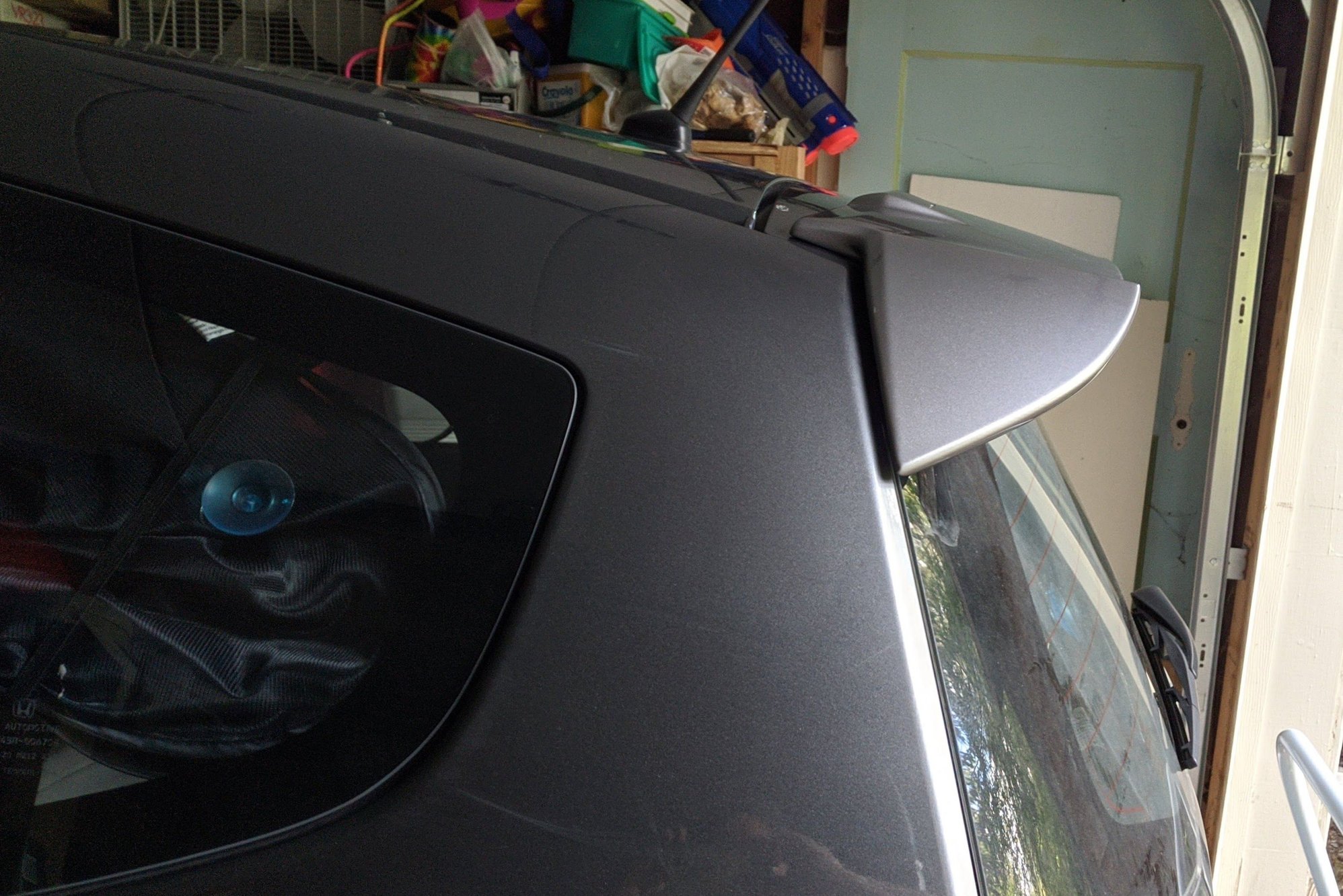

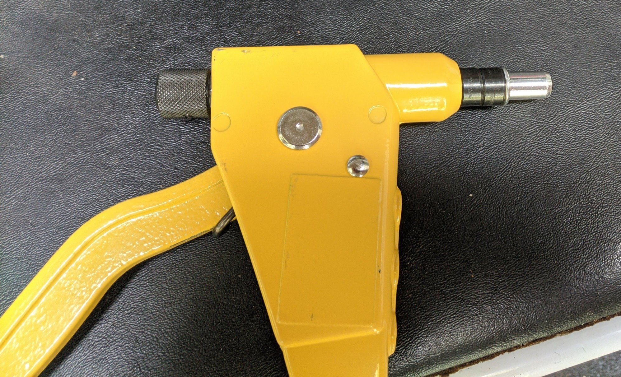

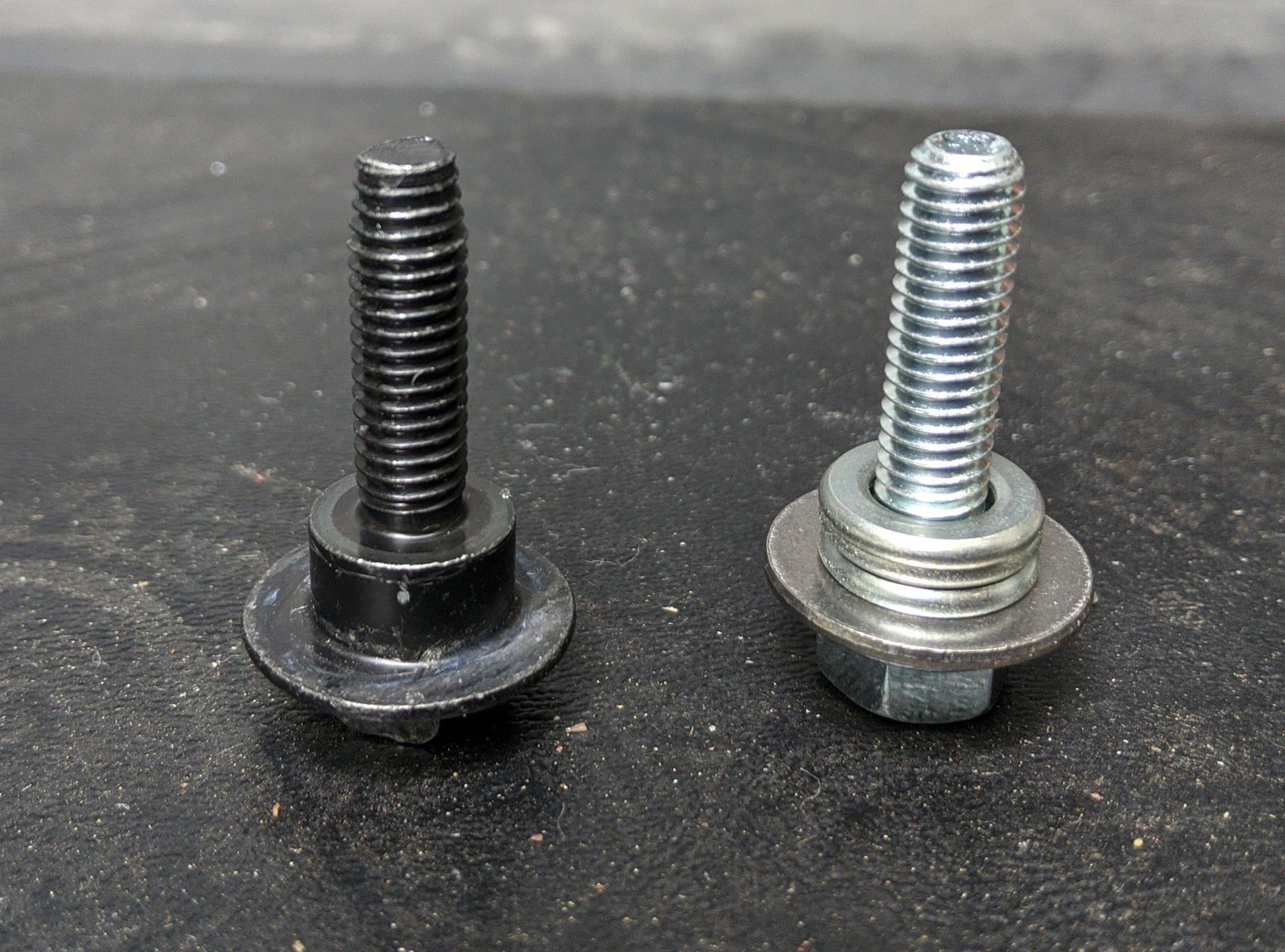

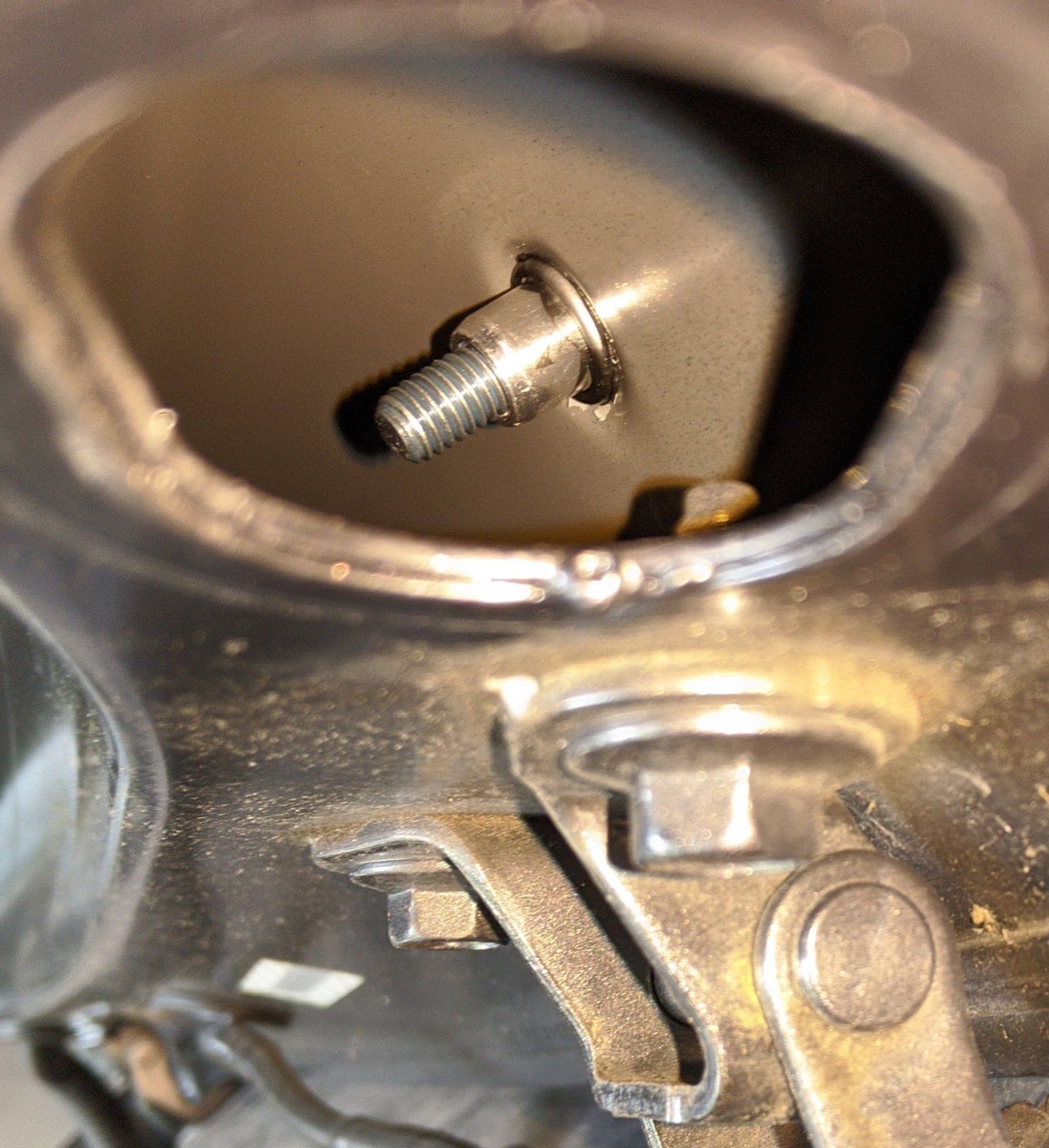

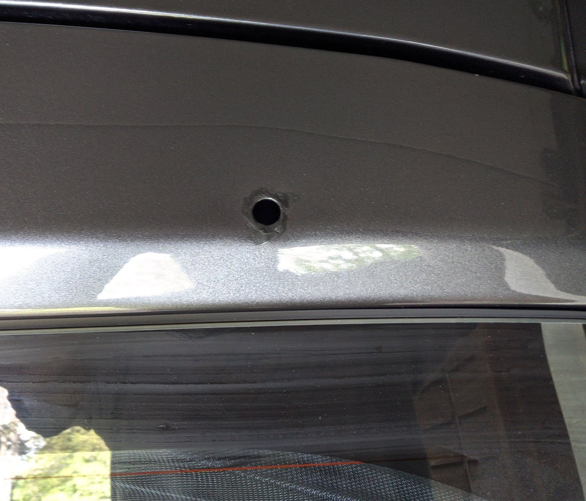

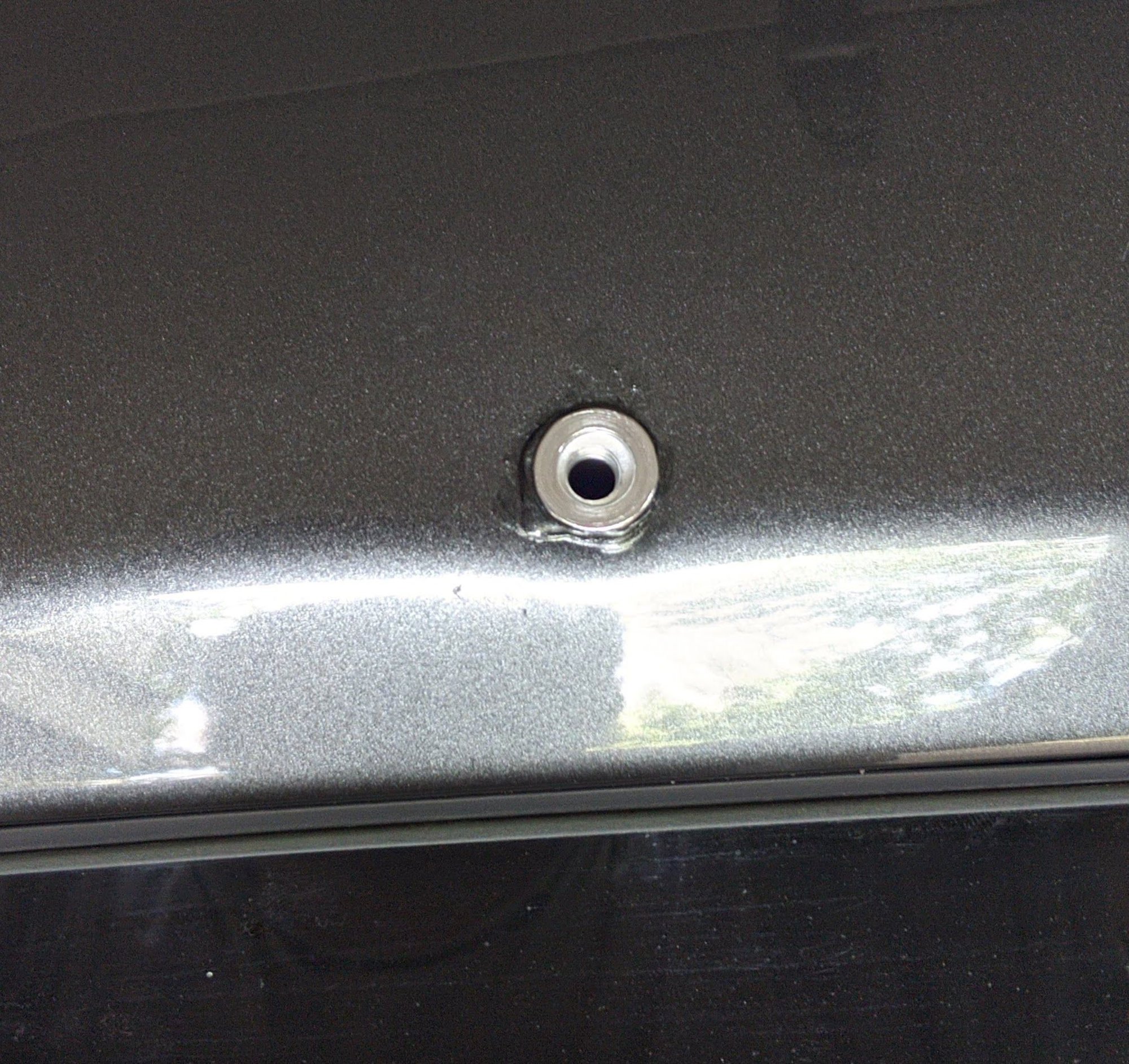

spoiler install on Base Fit
I added a factory spoiler to my 2012 base Fit. Picked up the spoiler from somebody parting out their sport. They gave me only one of the nuts to hold on the spoiler, so I cobbled together a nut with assorted size washers to match the factory nut. I couldn't find a factory nut (p/n 90102-SAA-901) anywhere in the my area, and to get online would cost $2 for the nut and $10 shipping. Installed rivnuts in the base hatch (threaded rivets) after drilling out 3/8 holes and touching up the bare metal. Note that the sport's spoiler has 4 clips that can just be discarded for installation on the base. The color of the spoiler is the lighter gray than my Fit's polished metal metallic, but I'll probably not notice after about a week.
Drilling holes in the tailgate didn't make me happy--just be careful--use a punch to mark the spot, and progressively go up in drill size til you get to 3/8 (the size of the rivnut).
Rivnut tool borrowed from my local tool library.
Threaded Rivnut installed
Left: honda bolt. Right: bolt from Ace with washers to match the factory shape.
The bolt in the rivnut inside the tailgate
Spoiler attached

I wish there was some data on the aerodynamic properties with/without the spoiler. Most people believe it doesn't make enough difference to matter. It does look good.
I've just always had 'spoiler envy' since I bought the car. Honestly I didn't want the side skirts or front lip spoiler, or 16 inch wheels/wider tires--very happy with my base model--but it always felt naked without the spoiler. The only other thing I'd like from the sport is the volume control on the steering wheel, but i've lived without it for 8 years so it's unlikely I'll ever dive into the wiring can of worms.

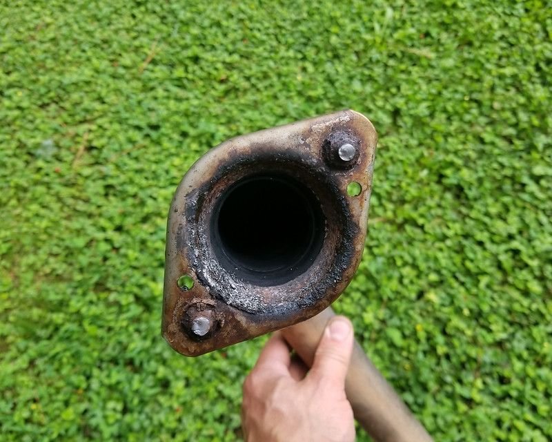

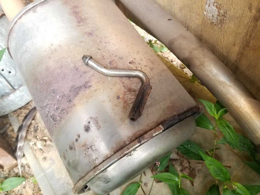

HKS axle back
There was an occassional clunk at the rear. An inspection revealed a broken muffler. HKS to the rescue.
Some temporary hardware had to be found.
I like it. You can now hear the exhaust, albeit a bit muted. I'm not a fan of obnoxiously loud exhausts on a car.

Looks like a tidy install. Have you had it at highway speeds to see if it drones? That's my fear of swapping any exhaust on it, is it drones on
Old Jul 8, 2020 | 12:56 PM
  #18857
Posts: 7,624
Originally Posted by Red 05
Looks like a tidy install. Have you had it at highway speeds to see if it drones? That's my dear of swapping any exhaust on it, is it drones on
If you keep the OEM b-pipe none should. If you’re in doubt the Tanabe Touring Medallion is super quiet at speed.

Nice looking install. Did you have to do any trimming on the bumper? What's the clearance between the exhaust pipe and bumper? Where'd you get it?
Old Jul 8, 2020 | 01:23 PM
  #18859
Rick_a's Avatar
Posts: 164
From: Cartersville, GA
No droning. Just a nice, mellow tone.
No trimming. About 1/4" clearance. It comes with a stiffer isolator that might drop it down some, but I liked how it sat.
I got it off Amazon from 4Wheel Online. Part #
HKS 32003-BH006
