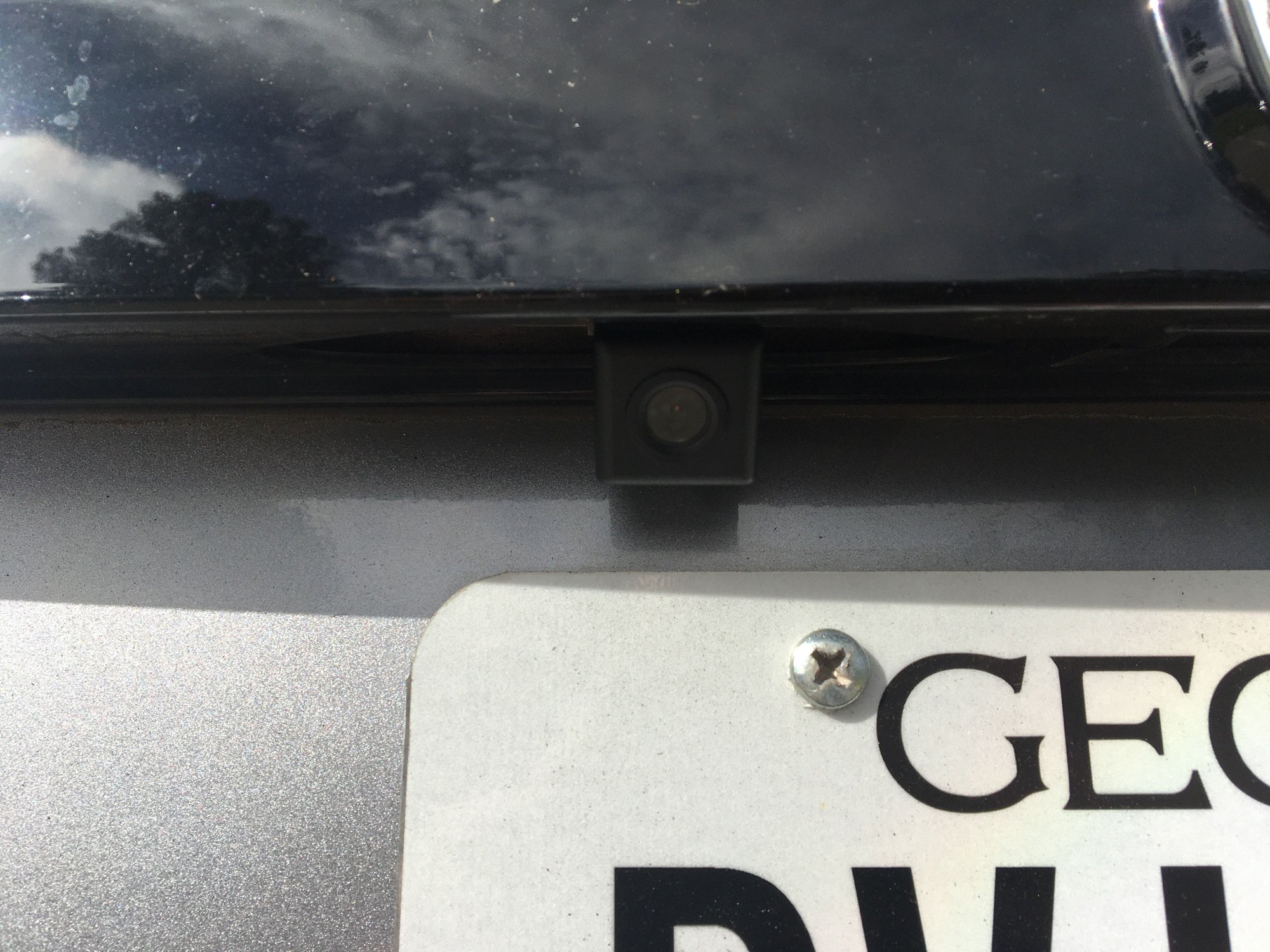

Installed backup camera. Was a bit of pain routing the wiring, but nothing a few hours and a 6 pack couldn't solve. Not bad for $20 off eBay!!!!

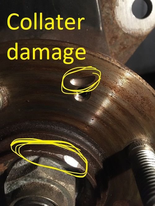

Well, I tried removing my front, passenger side rotor, but I stripped one of those stupid factory screws and couldn't get it off. I had to result in drastic measures by shaving down the rotor and screw with a rotary tool and angle grinder. Well, after a good thirty minutes to an hour, I was successful! However, there was a bit of collateral damage to the wheel hub. Oh well! I am glad to just get that nasty, four-hundred million year old rotor off. I had major trouble getting it off too. I had to use a heavy, metal mallet and spin it little by little while giving it a hit.
Seems like there is always something.

I had the same issue when I decided to swap out my factory rotors for some EBC rotors.
Before I got too far, what I did was get a Dremel with a disc cutter and made an over sized slot through the screw head (and partially into the rotor), then grabbed a big flat tip screw driver and finally a large wrench, that fits onto the handle of the screw driver. Apply a little pressure on the end of the handle to keep it in place while I used the extra torque I got from the big ol wrench. Much easier.
And yeah, a shitload of rusted iron builds up back there. I used that same screw driver to stab and chip away at all of it. Once I was fairly certain I couldn’t get any more off, then I tried pulling on the rotor. Only to find out, it’s still a lot and tough as hell... ended doing the same thing as you, hammer at it from the backside.

Glad I'm not the only one! Your method was a much better idea. Too bad I didn't think of it, because it would have been satisfying to remove the screw before using the rotary tool and such.
Oh well, the screw gave loose once I removed the rotor.

Were you using an impact drive to get the screw off? Maybe with a normal Phillips head? Those stupid screws use a head that is similar to a Phillips but not actually. I bought a JDM specific driver when I first took mine off. Kept them off too, there's no point to them after leaving the factory.
