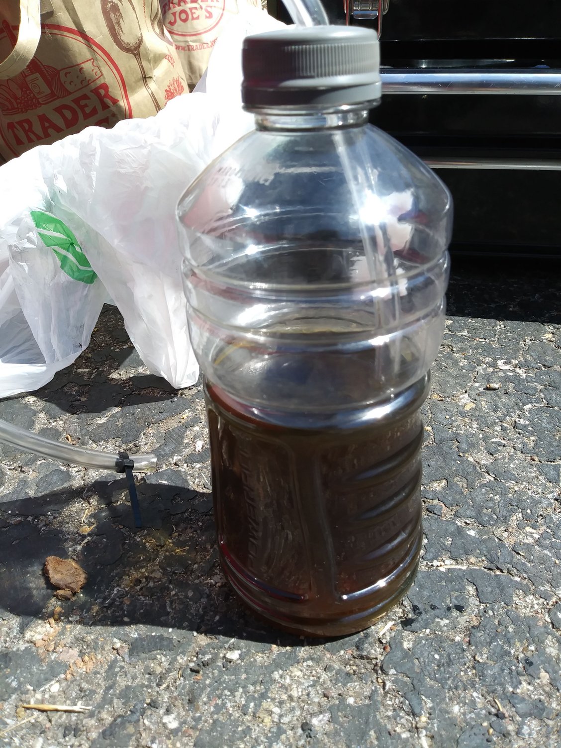

changed my front brake rotors and pads...sanded my rear drums and pads....and flushed the brake fluid yesterday. well i answered my own question...1 pint is not enough for a full flush. well, i think it would be if a person keeps up with their flushes or does them prematurely...but for anyone with relatively dark fluid in the reservoir BUY 2 PINTS!!
1 pint was barely enough for the front with the condition my fluid was in. it was in worse than i thought and even had little greenish mossy things poppin up. so instead of ordering and waiting for another bottle of Motul fluid, it was more important to me to finish the flush with clean fluid. I bought 12oz of Lucas dot 3 locally and finished the job.
With the bottle of 12oz Lucas I was able to do the rears, and then go back up to the fronts for a second time with about 3 tablespoons to spare. glad i did the fronts a second time because the driver front was kinda murky after doing once. the second pass on the passenger side front had a slight tinge to it, but was mostly clean. I wish it was pure Motul in there, but I do no racing and thought spending $20 on a pint was overkill...not worth $40 for 2 bottles of Motul per flush to me. In the future Ill be buying 2 pints of Lucas or something similary priced especially since im considering doing a flush once a year or so.
and since this is now "post your used brake fluid" thread...heres mine. first pic is after fronts. second pic is after doing rears once and then fronts for second time.

Ugh! Good to see that gone. Your Fit says thank you.

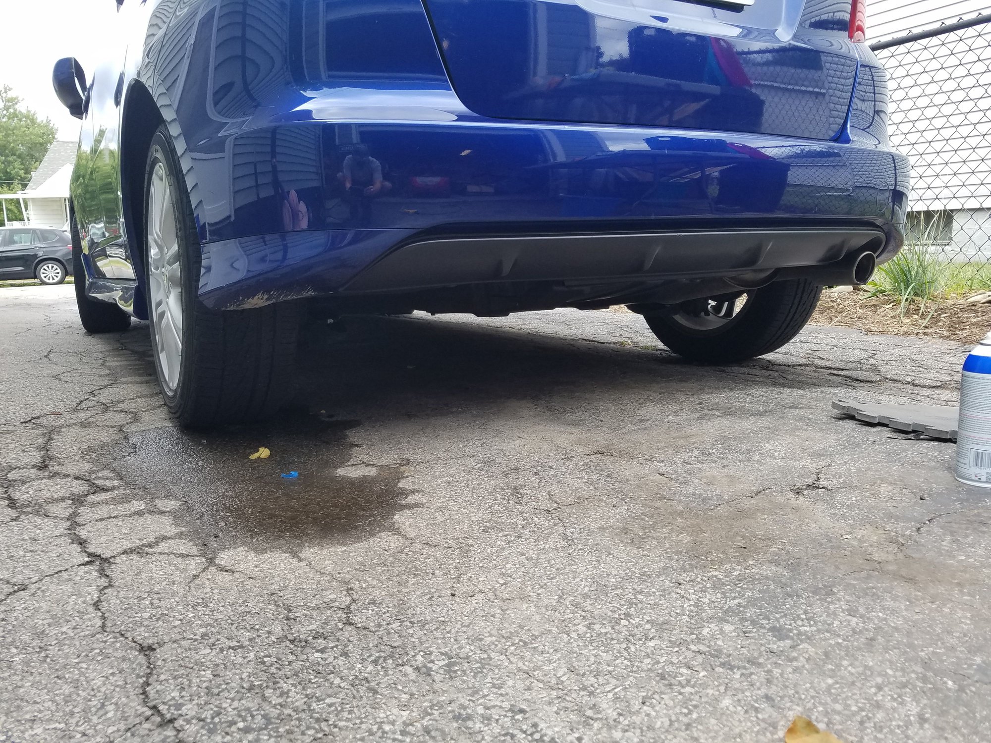

I finally had some time this weekend to get started on the Fit summer to-do list.
I Plasti dipped the rear under-bumper part today while also doing a rear brake job. Went ahead and dipped the new drums too. Love the way it all came out!
