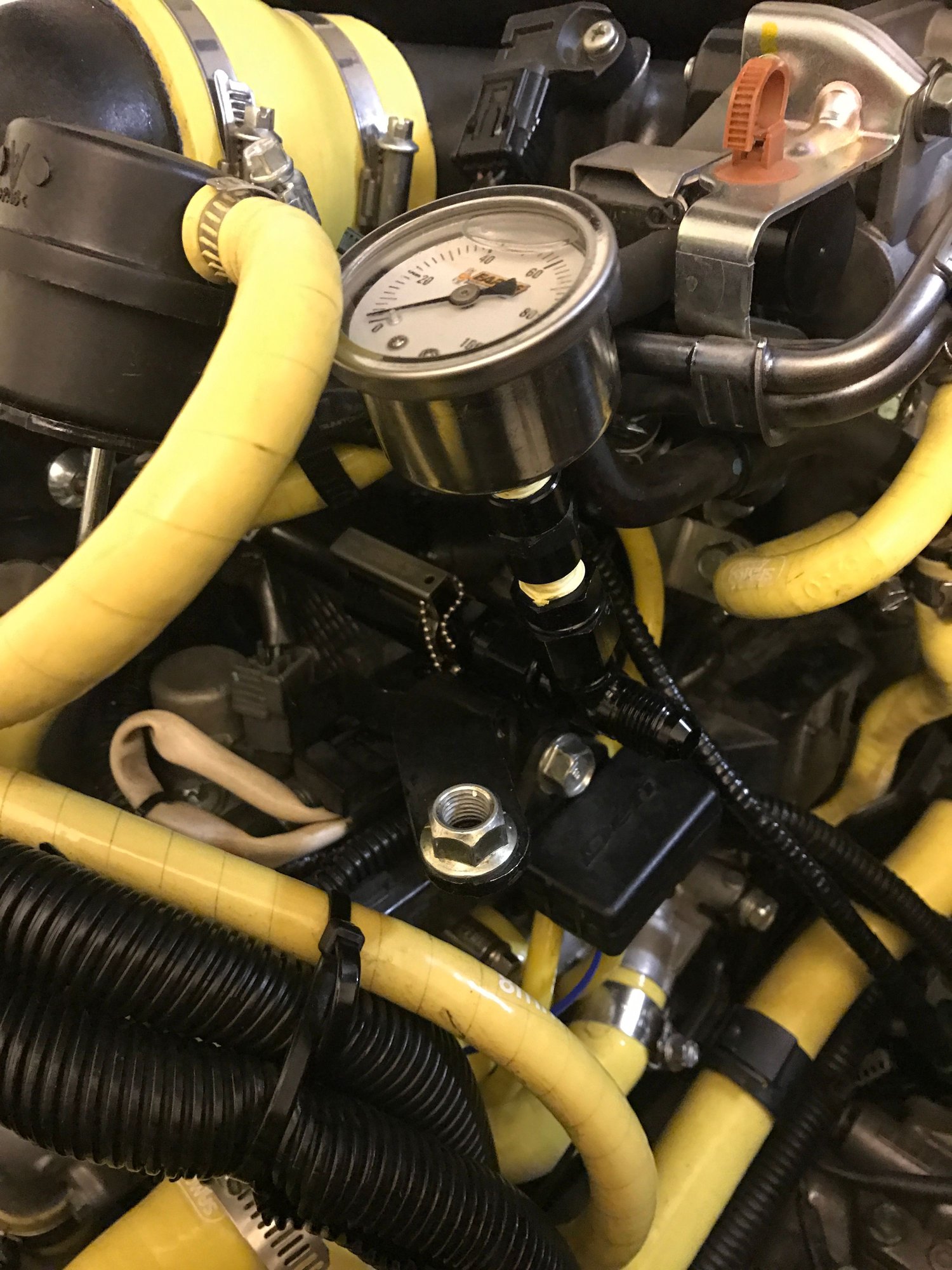

Since you also posted your questions here, I think it is best if I answer it here along with the fuel line questions that you ask me through PM.
Below are the pictures of my Boomslang harness that will plug into the ECU, and you can see the 3 connector have a "LEVER". I see your factory connectors from the pictures you send me through PM and I think you need to move the "cover" to expose the connector. Please note that it had been a while since I remove the Honda factory harness connector from the ECU so I do not remember it 100% but after you move that cover (or it could be part of the cover), you will see the "LEVER" on the factory connector just like the Boomslang connector.
For the fuel line, I don't think the original Honda retainers will work anymore but that "BLUE" clip from the sprintex fuel line will act like a retainer and yes, they can move a bit, but since they have o-ring inside, it is ok.
If you want a connection with a retainer, look at the second and third picture below where I upgrade to Goodridge 910Series PTFE with Aramid(Kevlar) reinforced hose and use EARL’s AT991965ERL EFI Quick Disconnect QD -6AN Male to 5/16” for Fuel Rail which will plug in directly to the fuel rail , and here is the thread about it:
https://www.fitfreak.net/forums/2nd-...rced-hose.html
