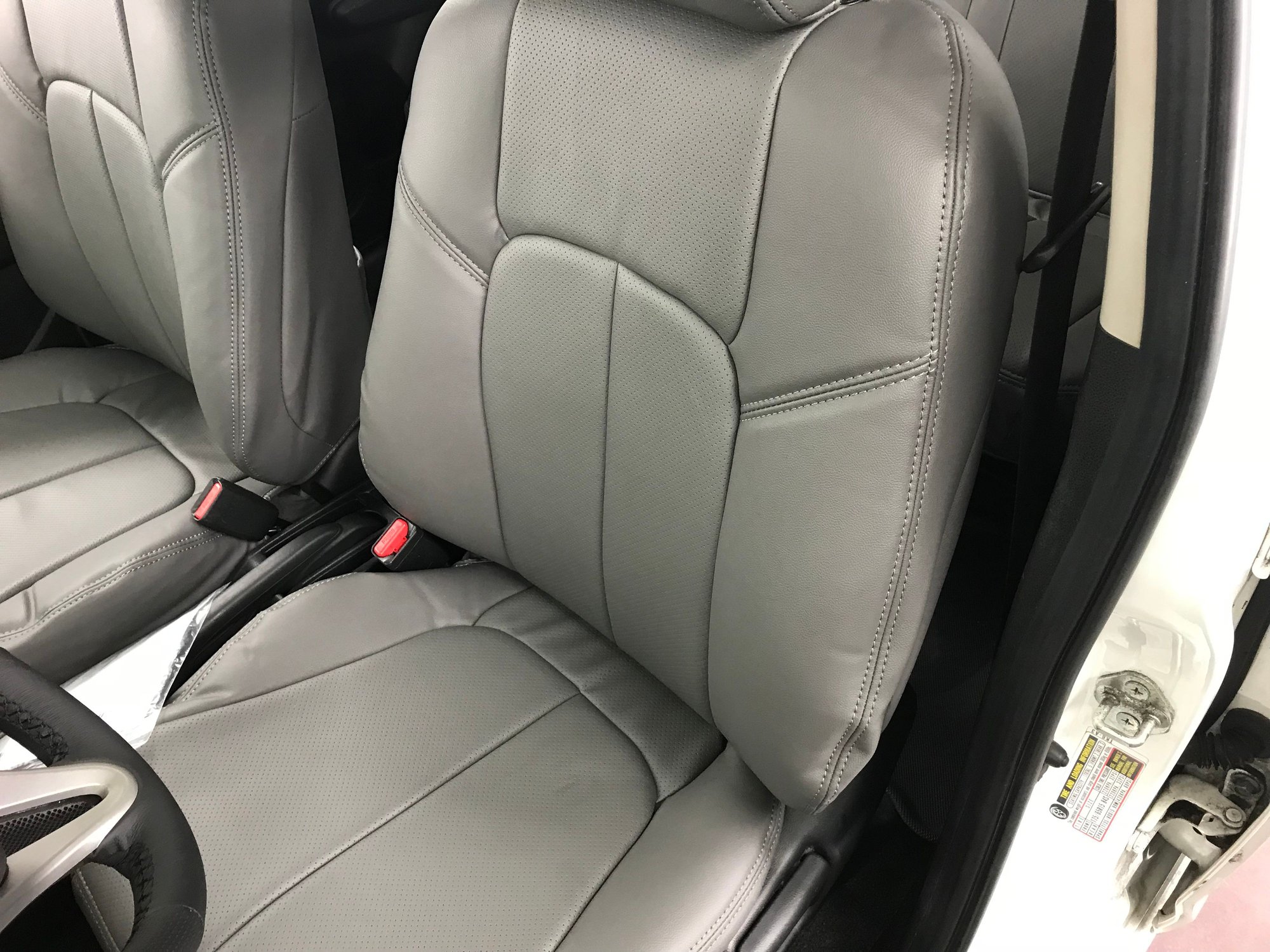

Installed new seat covers
They look nice, I still need to let them rest , stretch, them tighten them up .
Installed new seat covers.

Jerry, are those clazzio's?
synthetic leather? or genuine?

Genuine synthetic , but they do look and feel like leather.

”genuine synthetic” eh? Pretty sure that counts as an oxymoron.

Look great!
I have been wanting a set of these since my last car. might get me some next year. overall they are suppose to hold up great...keep us updated on any issues!

I love those seat covers! But for now my budget isnt that great and 4yrs from now my tax on this will shoot up so i might let go soon.

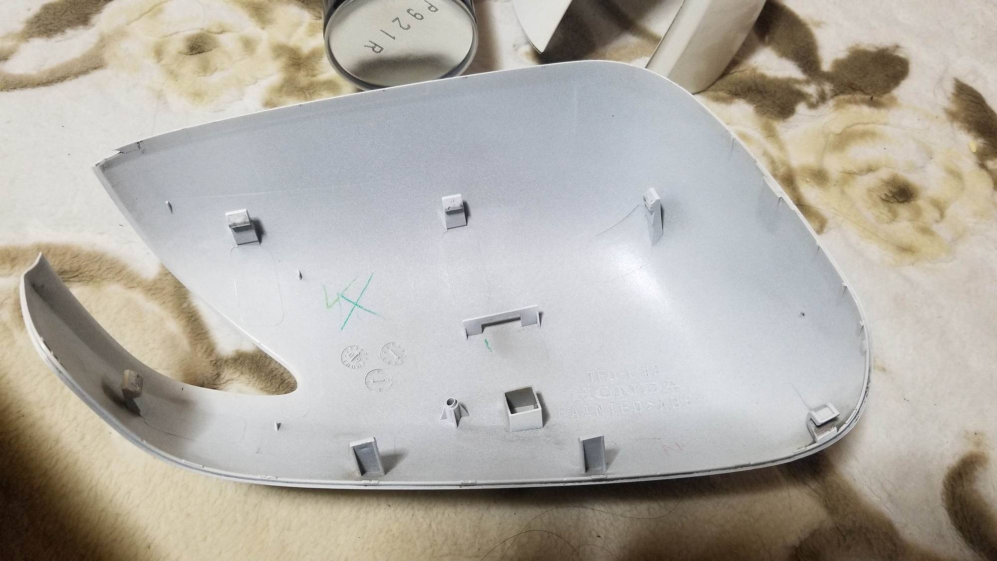

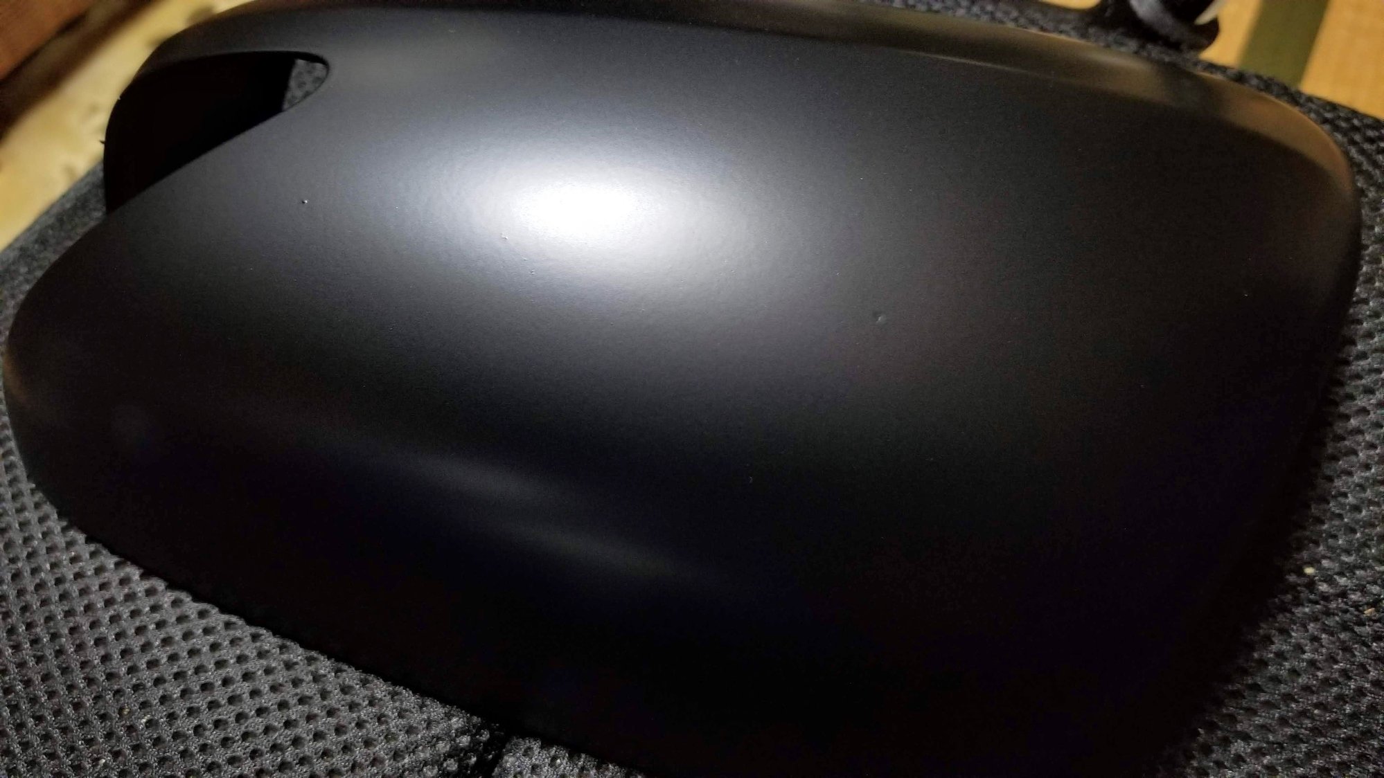

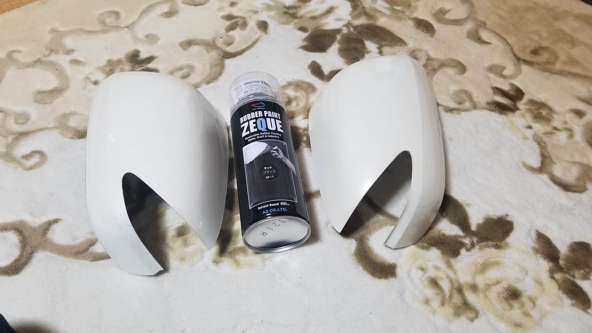

For now, I painted my side mirrors with rubber paint!
Failed attempt #2, went too thick on 1st and 2nd layer.
Somewhat better results! Very thin 1st and 2nd layer. It had rock chips and wall scratches! I also sanded it to ake it smooth to hide the imperfections!

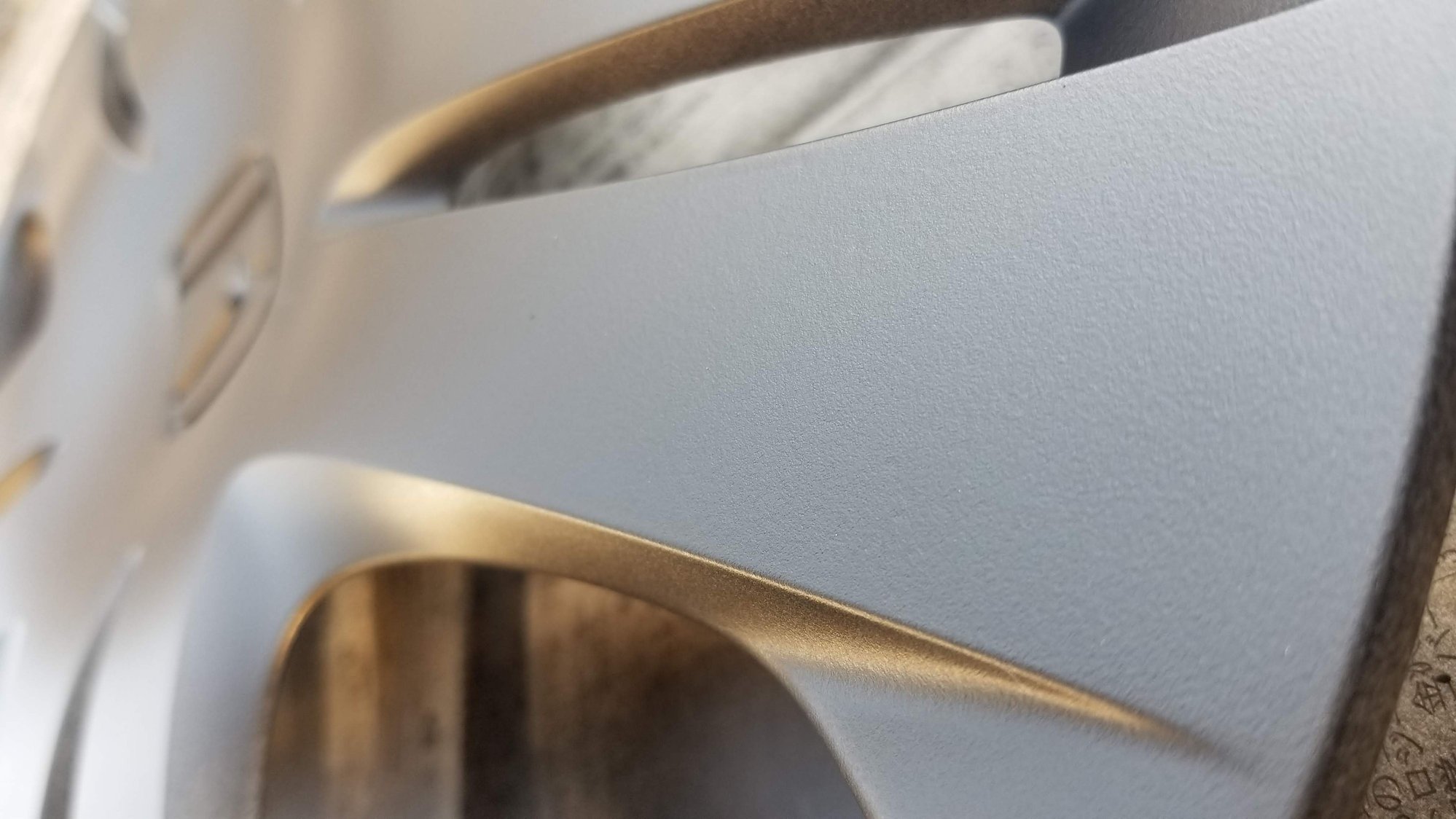

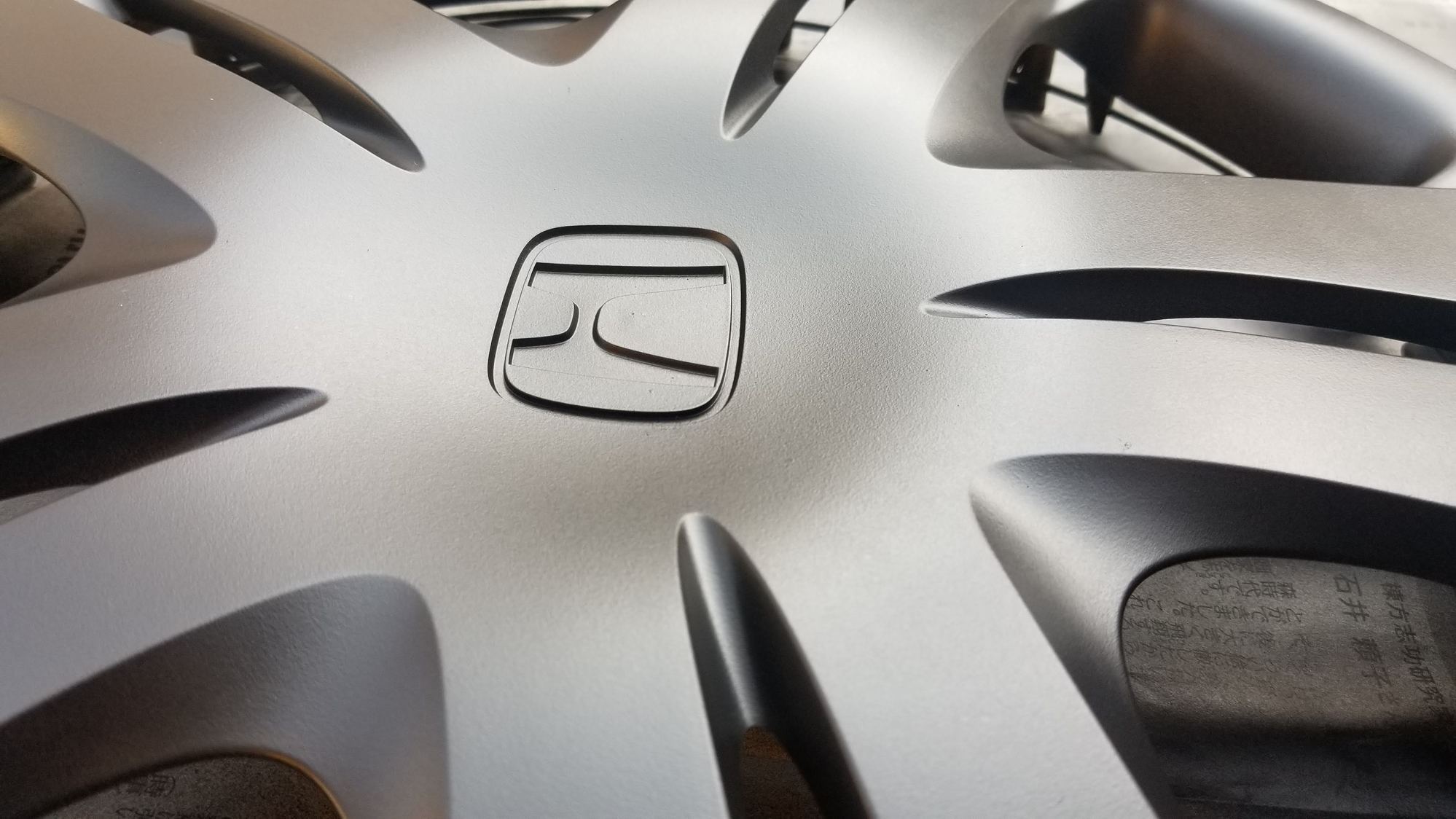

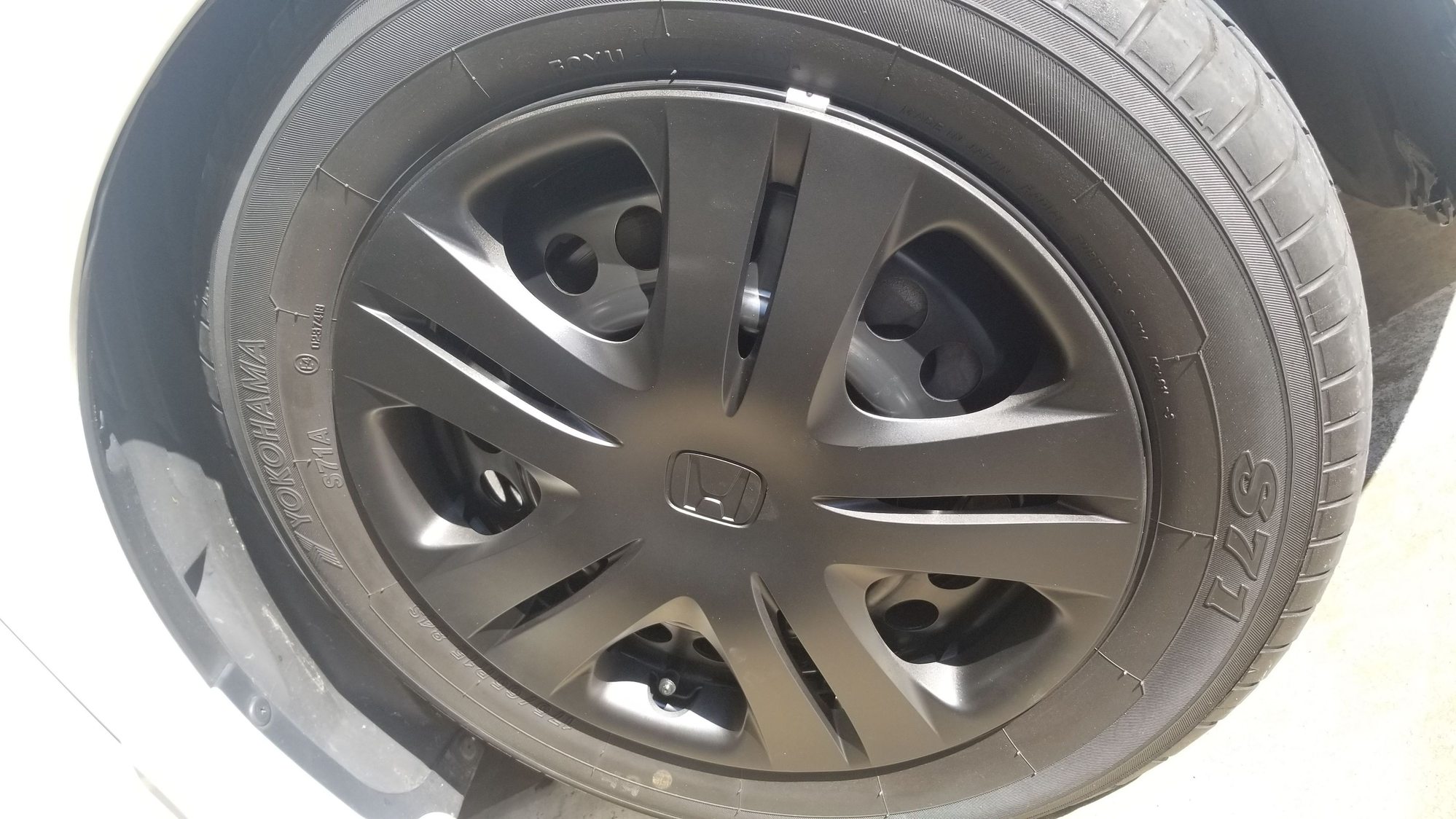

Coudnt wait to find a good deal on a 16x6.5j 195x55R16 set of wheels so i decided to rubber paint my hubcaps for now. Here are the results!

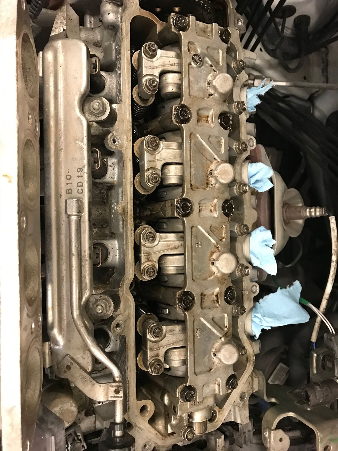

Adjusted valve lash
Adjusted the valves , it sounds a lot scarier than it is . It takes about an hour and a half - two hours .
.007 intake .010 exhaust,
