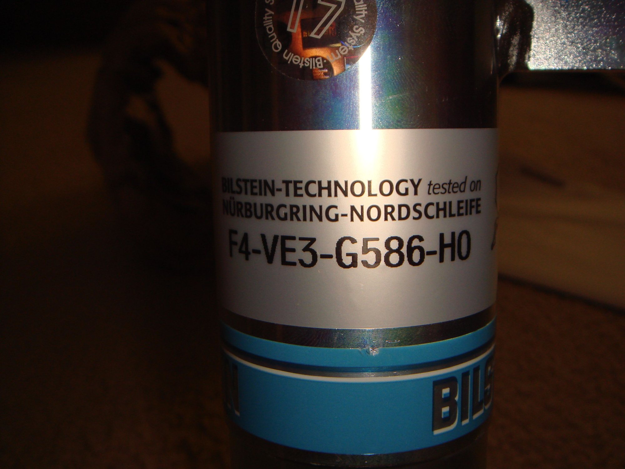

Before I change to my current Ohlins coilover due to the need of higher spring rate from my brake setup, I use Bilstein coilover and they are very very good in term of road comfort and handling and of course Height Adjustable.
I bought the Bilstein coilover kit at TireRack, I think slightly below $900. They had gone up a bit to $962 now at Tirerack, but I assure you that you will not be disappointed. They have lifetime warranty and still MADE in GERMANY
Here is the link to tirerack:
https://www.tirerack.com/suspension/...oModClar=Sport
Video of Bilstein testing and developing the coilover kit using the Honda Fit GE on the test track:
and here is my review after I install the Bilstein on my car (you will also find my review of Spoon Front Sway Bar and Progress Rear Sway Bar on this thread):
https://www.fitfreak.net/forums/2nd-...ml#post1185733
Pictures of the Bilstein Coil Over and picture of my car at that time right after I install Bilstein:
