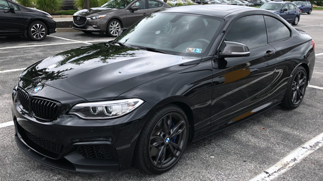

2016 BMW M235ix
I just paid off the Fit . The Fit serves as my daily driver ( Beater car ) . I took out a 5 year loan and paid it off in 1.5 . Now I need to work on paying off the Beemer .
