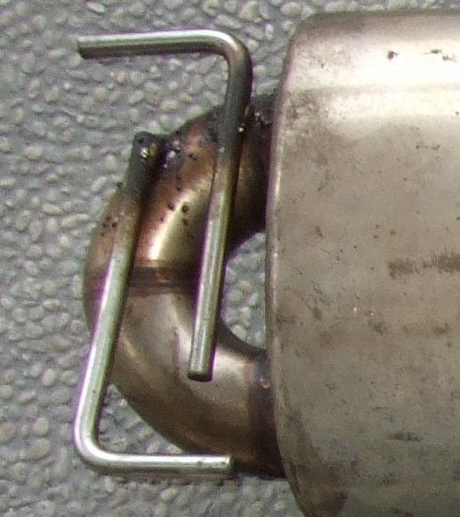

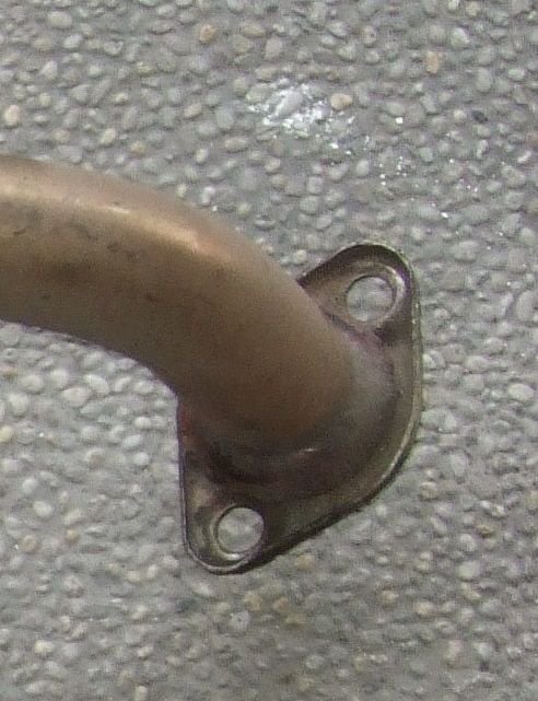

If you're wondering why I'm having a custom muffler made (again, actually) but haven't touched the rest of the exhaust system, here's the long story:
I bought and installed a Weapon R style 'header' about a year, or so, after I got the car. Problem was, the rest of the exhaust system, mid-pipe to muffler, would 'rattle' somewhere around 4k rpm. Terrible noise. So I started to save money to upgrade the rest of the exhaust system.
One time, I tried a straight through axleback muffler; it was much too loud. I theorized that all aftermarket straight through mufflers would be too loud; there isn't enough space for a muffler big enough to bring noise levels close to stock. Time to do some research.
I came across an old, out-of-production, style muffler called a twin-loop muffler, which is said to be very quiet. These mufflers were made for Honda Civics and Integras; too big for the Fit. I browsed several pictures of looped mufflers and came up with a design that would be easy to make and fit the Fit.
Sometime last year, the OE midpipe was replaced with a bolt-on from HKS, which worked well. However, OE axleback muffler sounded like it wouldn't last very long. I had to put my idea to the test. I asked a muffler shop to make this:
A two-pipe muffler with a loop on one end, inlet/outlet on the other. And it worked! It made a little more noise than stock, but not too loud. Good enough for me. And it looked alright, I think:
The pipe-end was their idea, by the way. Sadly, there were one or two problems:
1. I asked the shop to put the loop inside the rear bumper so the muffler could be bigger but, over time, the rubber hangers would probably lengthen, causing the loop to hit the bumper.
2. the flange didn't quite fit evenly on the gasket; the bends and welds could be better.
