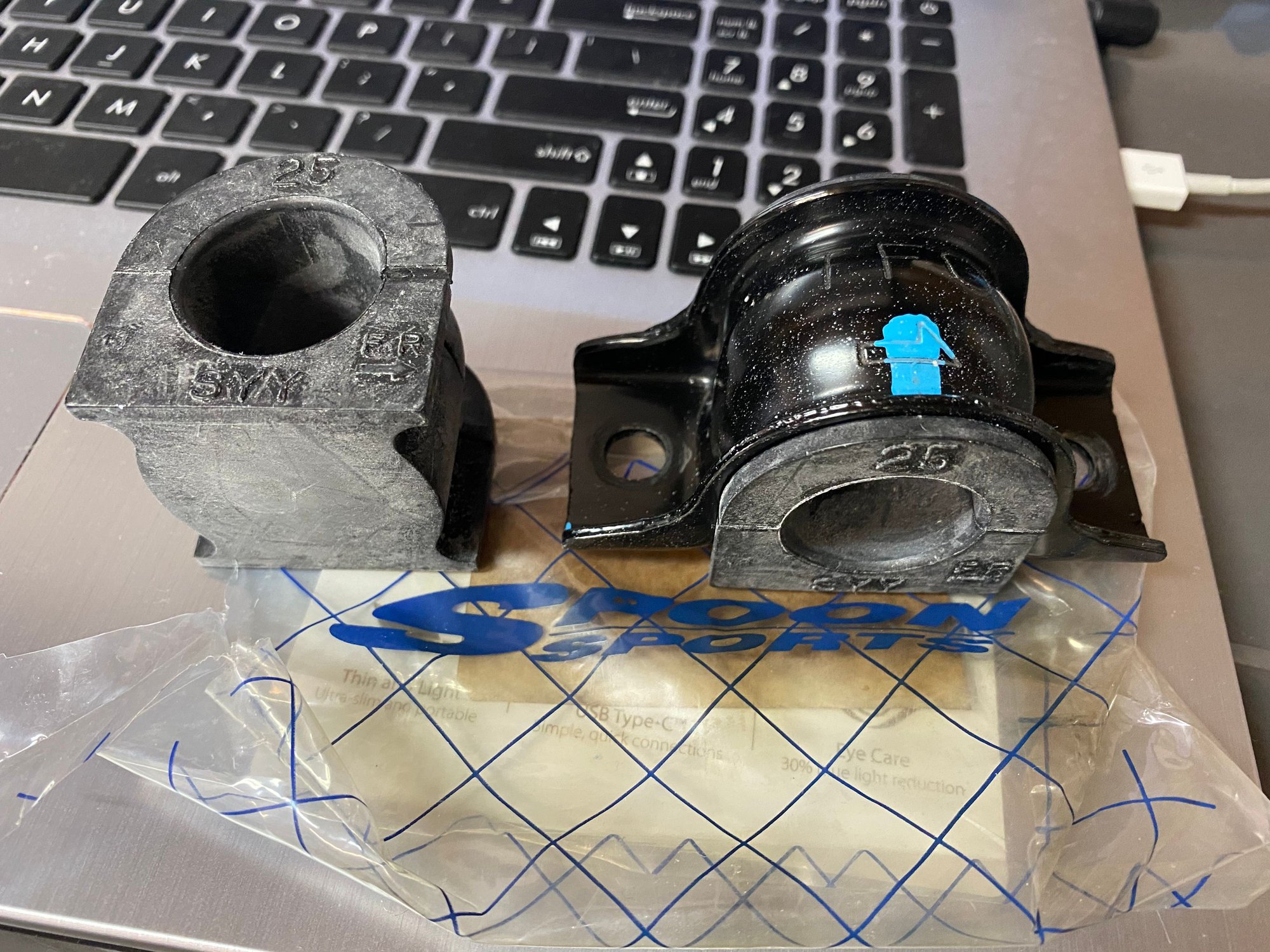

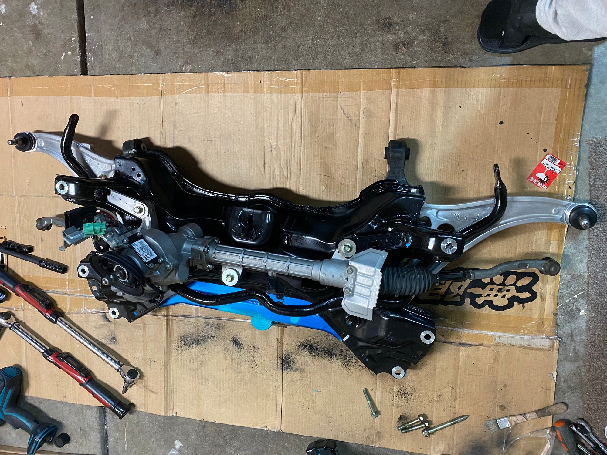

Replace the BUSHING for the SPOON Front Sway Bar during Thanksgiving weekend, had to take down the entire subframe assembly, so I took this chance to not only clean the subframe/steering rack, but clean and touch up (with paint) on area with spot of rust (including on the Cusco 4 point bar). Not the prettiest touch up paint job, but it works
Before cleaning and touch up:
After cleaning and touch up, yap clean it real well, first rub everything with Alcohol then wash them with wheel cleaner/soap, then touch up paint, oh, I also replace all the bolts and nuts (and extra washer for the steering gearbox) following Honda manual guidance, then torque them to spec. I also install back my adjustable sway bar link.
NEW Spoon Sway Bar Bushing:

What a thing of beauty! I dread the day i drop the subframe on mine.

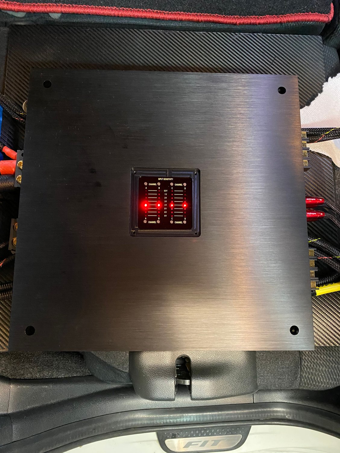

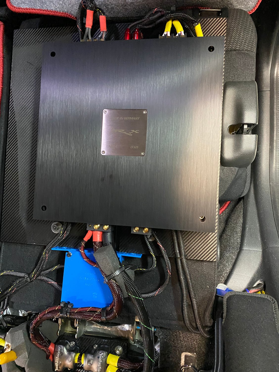

Installed my BRAX NOX4 Power Amplifier this weekend, full DIY here: https://www.fitfreak.net/forums/2nd-...ml#post1440276
I play several Reference Song that I knew very well, and immediately I notice compare to my old Sony XM-GS4 power amp, this BRAX NOX4 has:
a. Much LOWER Noise Level
b. The Bass, Midrange, and Treble sounds more Natural and more Pleasant to my ear, almost like my home audio system (I am using B&W 804D3 speaker, Wadia Amp for my home audio system).
c. Even better Imaging, More Revealing, especially in the Lower Level Details
In summary, my car audio system is now PERFECT for my ear (and of course for the eye candy effect ), so finally, I can close this Audio Upgrade Project

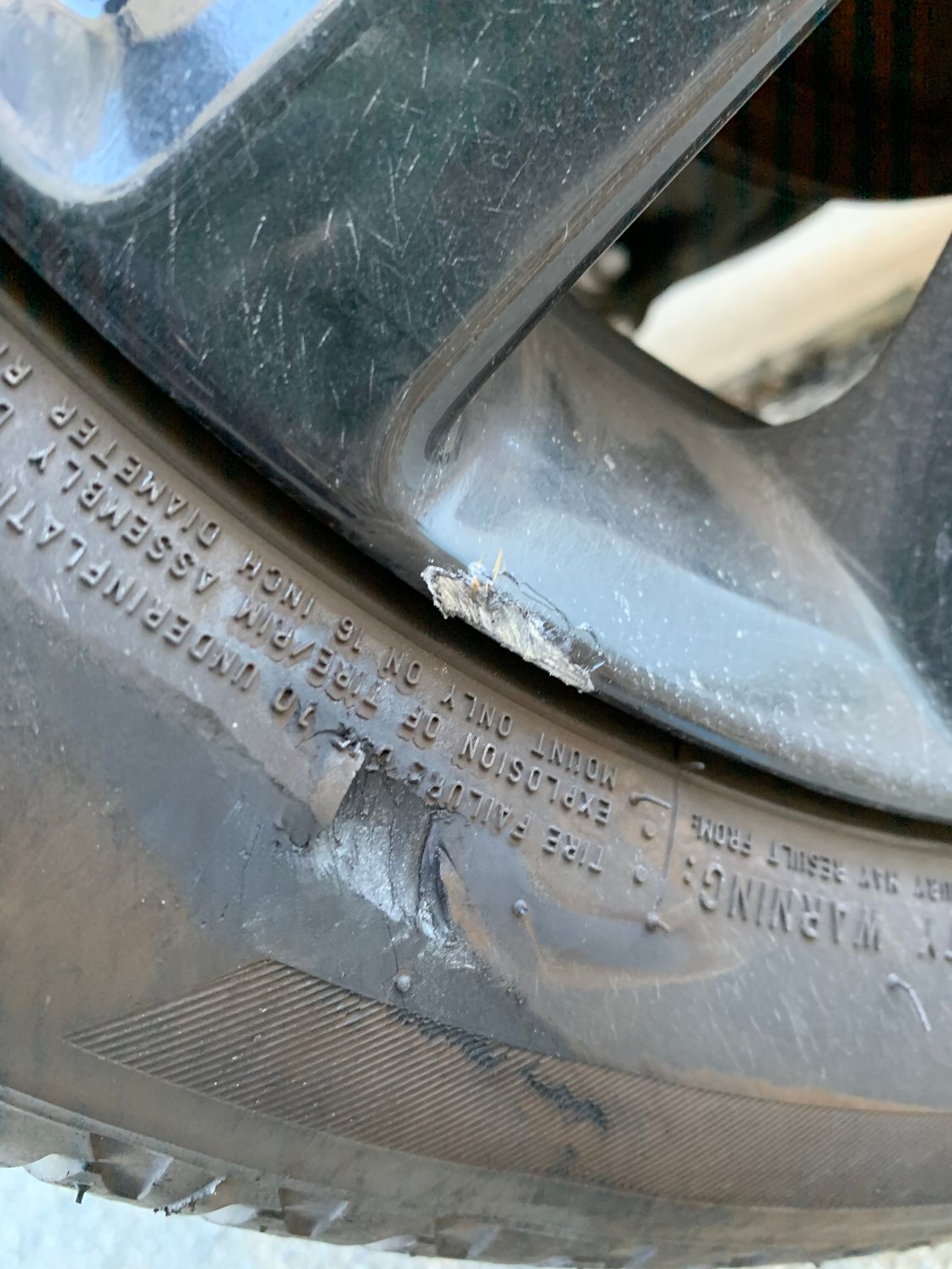

Nicked my rear wheel this past weekend. Took a tiny chunk out of the tire as well.

I know how it feels though it didn't hurt the tires on mine I just scratched mine a little deeper then the surface! Here is some pics of mine scratched. I did mine a while ago though.

Did you end up repairing them? I plan on filing/sanding the rough edge down just to get the burrs off.
