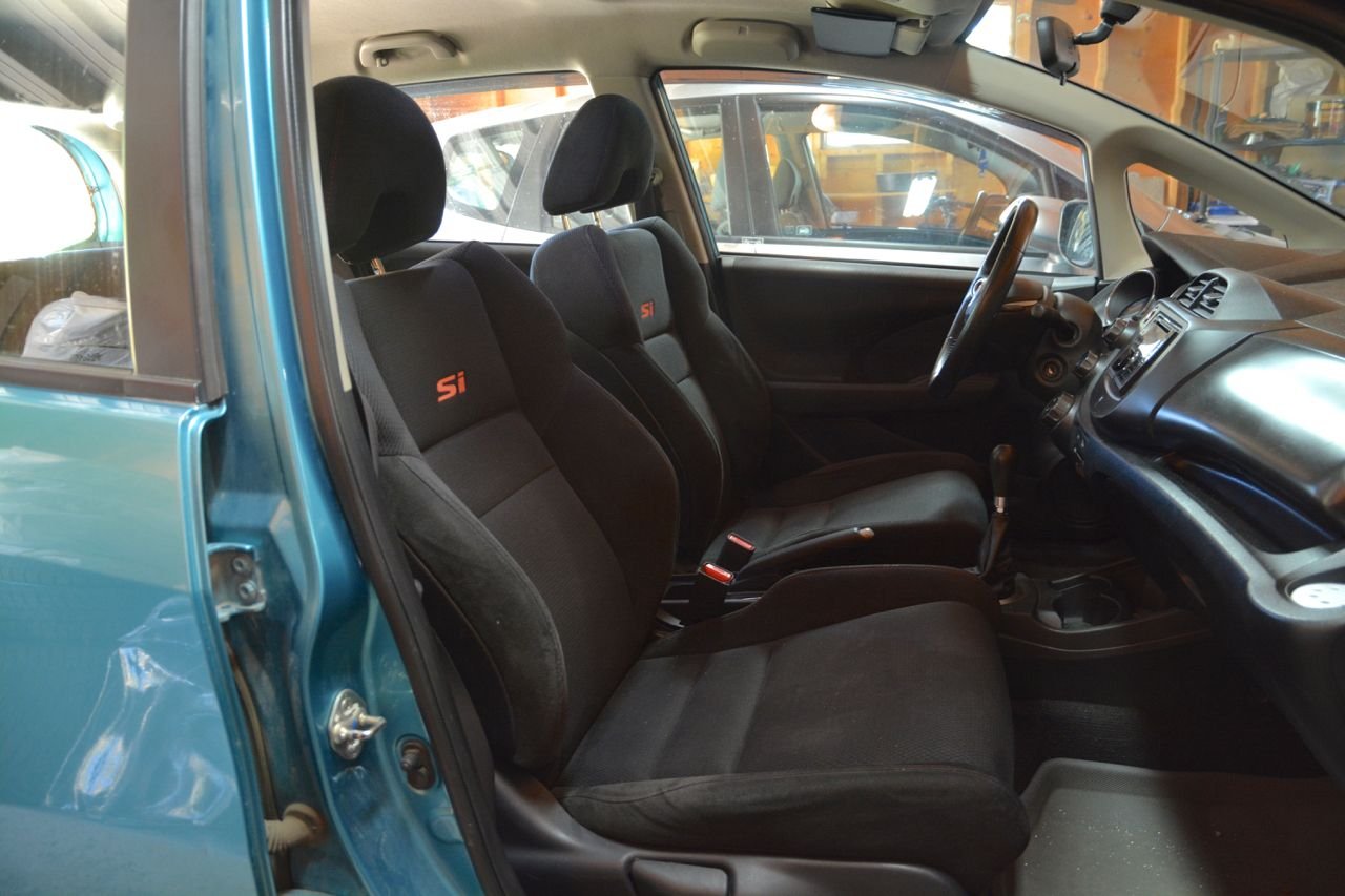

Just thought I'd update on here. Bad news. I have swapped in my '08 Civic Si seats into my 2013 Fit. People say this is plug and play for airbags. It is not (airbag light is on).
I just got out of the dealer hoping they could clear the light with an OPDS calibration. They were unable, as there is no signal coming from the weight sensors.
I have swapped out the Civic OPDS unit for the Fit's, and am running the Fit seat belts. Unless there is a way to trick the system into thinking someone is in the passenger seat, then there will be no airbag deployment on that side. If I manage to trick the system somehow, I will let you all know (any help is appreciated).
Otherwise I absolutely love these seats! Way more support than the Fit seats, super comfy, with full functionality unlike a racing bucket.

Ebay sells HDS and HIM modules for about $130 to do that on your own. Might save you some coin depending on what Honda charges to do what they did.

Thanks. I have actually tried this, but unfortunately the unit I got from Amazon required a very old version of Windows to run, and most of the instructions were in Chinese. Do you happen to know of a good one?

I personally haven't bought any of them, so I dont have an answer. You could maybe try running the program in compatibility mode? Right click on the launcher, should give you the option. There's an old need for speed game I play occasionally that was designed for windows 95 that I have to do that with.

Anyway, I did manage to get a friends old PC that could read the disc, and they are an IT guy. The bigger issues is most of it was in Chinese, and my friend could read it too but it just didn't make any sense. I might look into a fancier tool and message sellers about the specs and language.

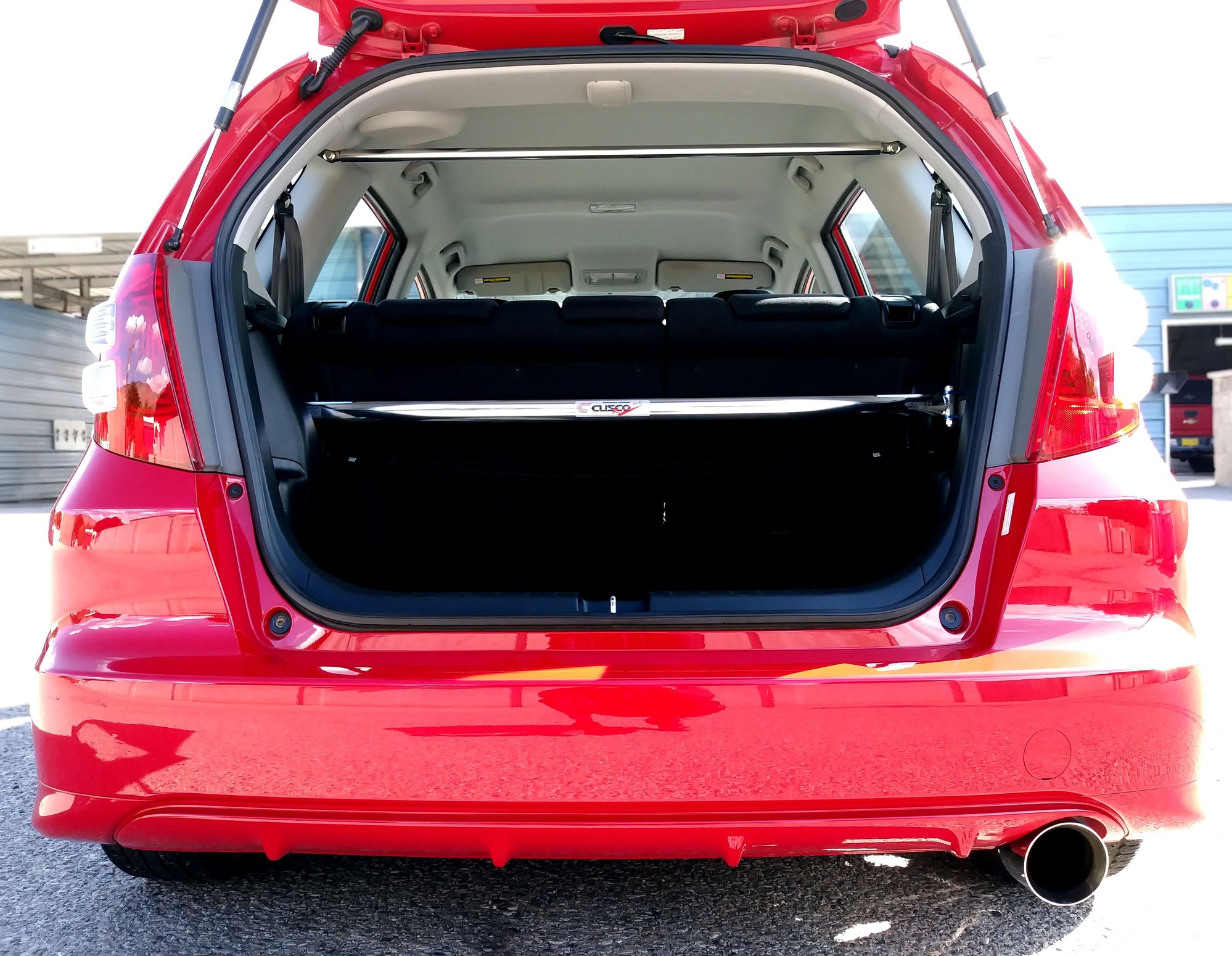

Thorough Carwash! inside, out, engine, polished strut bars and headlights. too much work. and i summoned the rain.

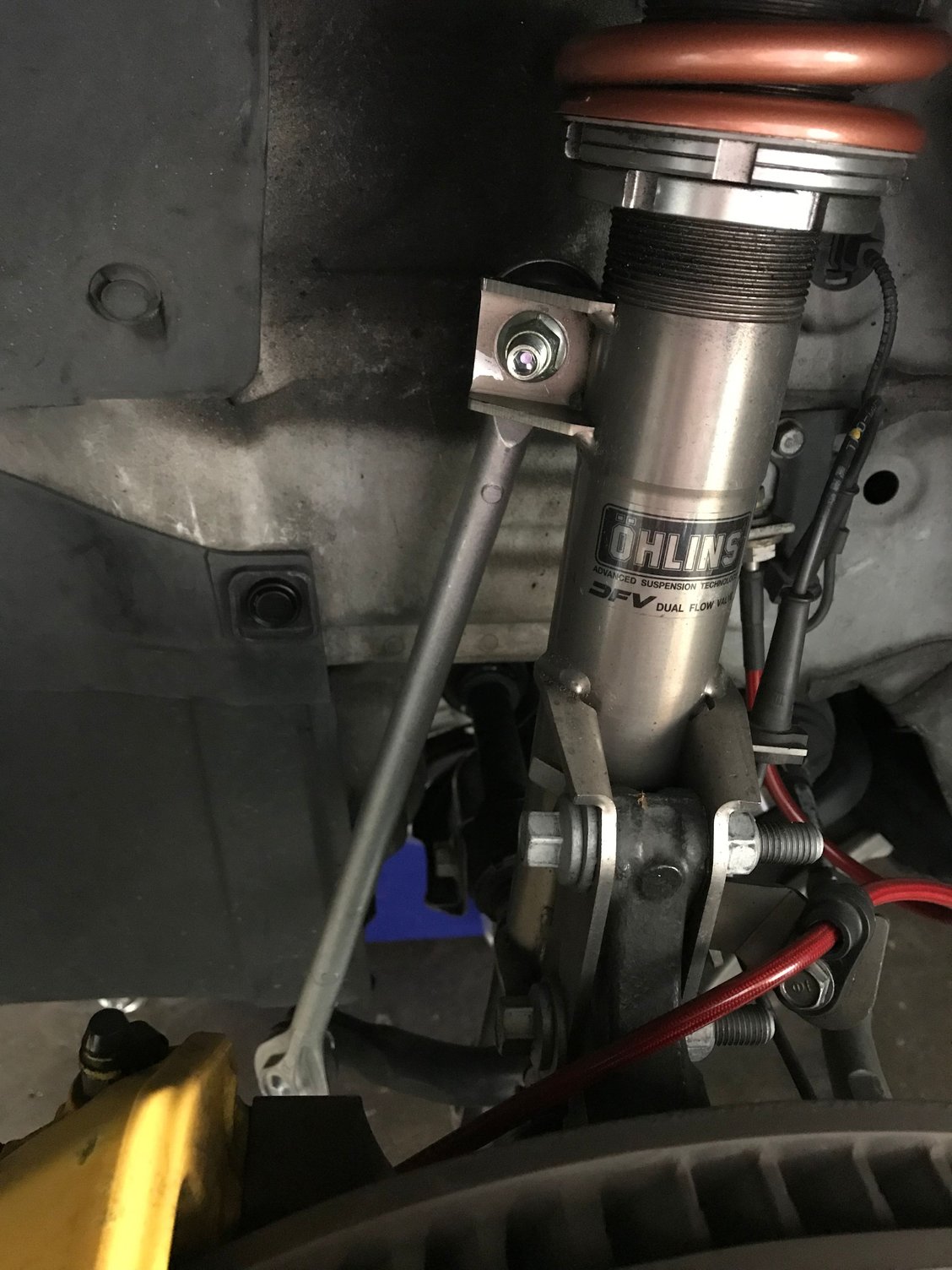

I found out that the latest Civic Type R sway bar link is the same 13in length as the sway bar link that came from Spoon plus the orientation is almost similar.
Out of curiosity, I bought them and install them today... They are super light because made from Aluminum !!!

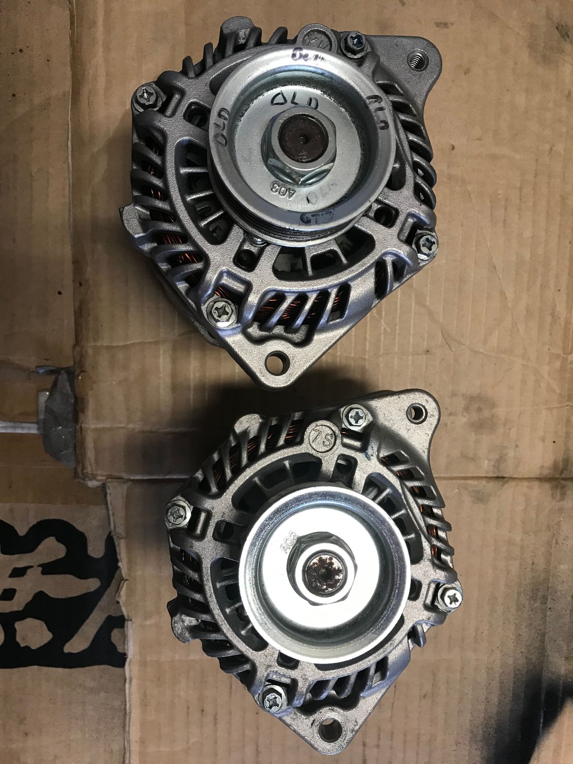

I also replace my alternator with a new one today (genuine Honda Fit Alternator just to be safe)

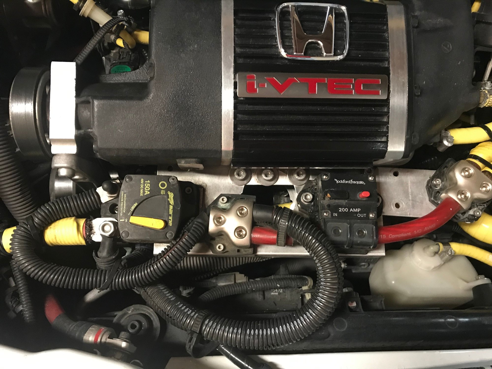

Took a long time because I also take the chance to replace all the circuit breaker and distribution block for my big 3 wiring (since they need to be removed to access the alternator anyway)
Old Circuit breakers and distribution blocks:

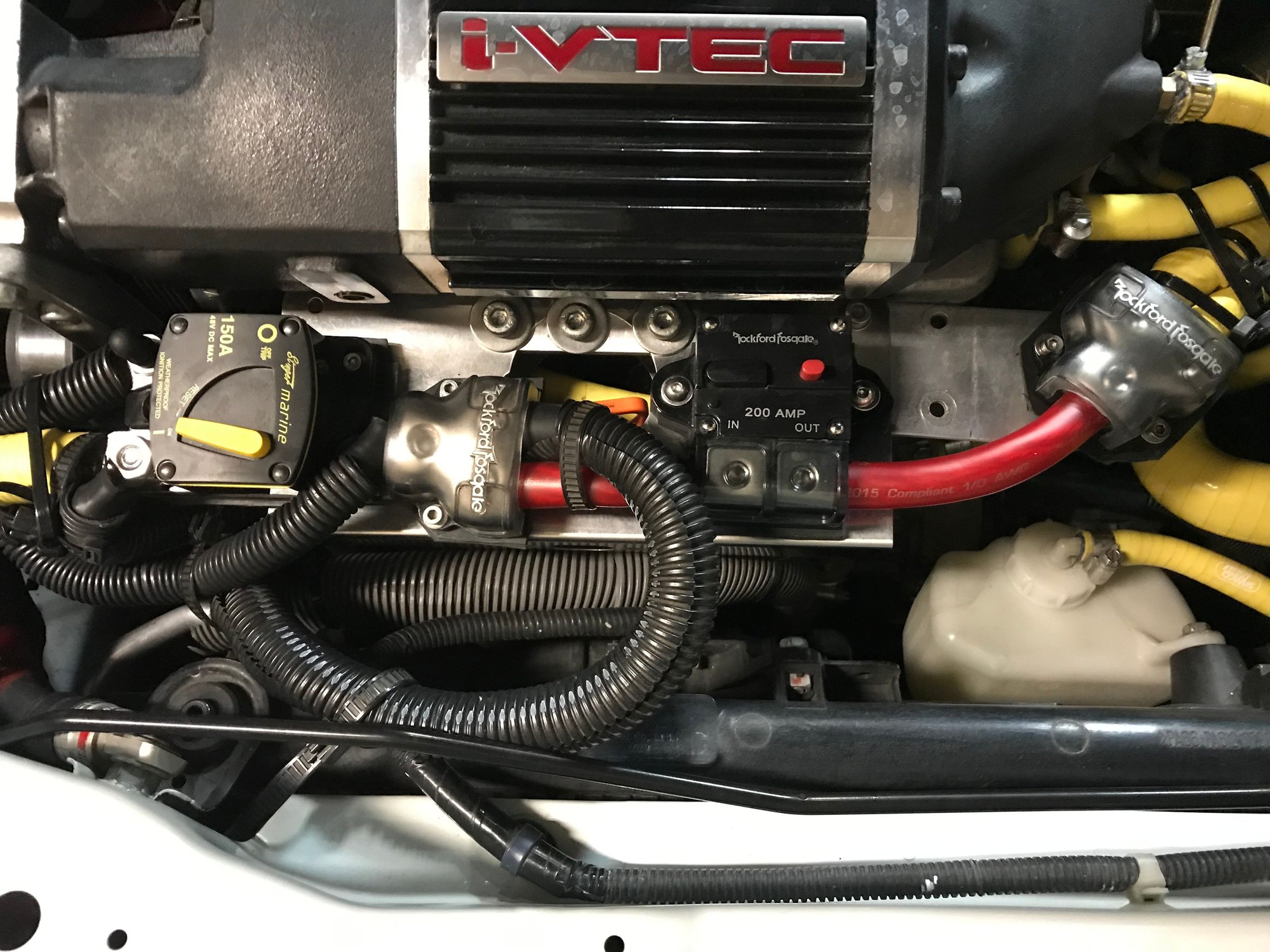

NEW Circuit Breakers and Distribution Blocks:

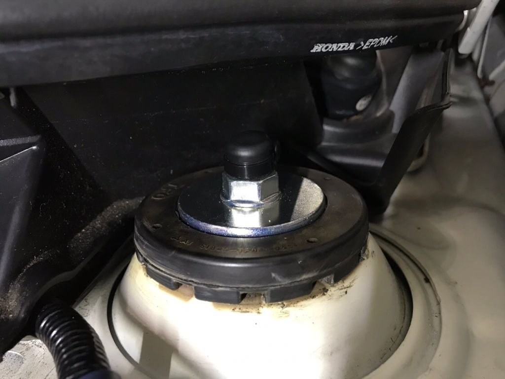

Hello,
If the problem still persist after your change you tighten or even replace your front swaybar link, then...
You might need to change your Front Strut Rubber Upper Mount (there are 2 rubber parts, the one on top of your strut, and the one inside the engine bay), and while you do it, replace your strut upper bearing too.
You also might want to change/upgrade the Mount Nuts with the new (Honda Genuine Parts) improved design from Honda Fit GK.
There are threads about this newer mount nuts at CRZ Forum:
https://www.crzforum.com/threads/str...nt-nuts.92309/
I was thinking of doing the above, but then I decided to just buy a Beatrush Pillow Ball Mount today:
S134403TM-FP | LAILE
